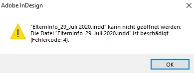

Dear Sir or Madam,
my InDesign file can no longer be opened.
It was originally stored on an external hard drive.
When copying some files to the hard drive (folder for InDesign document), there were a few problems
because the hard drive hung up but then worked again. Access to all files has been possible since the hard disk was last hung up (even old InDesign documents can be opened without any problems), only the document currently being edited no longer works: After an eight-second startup process, the message "InDesign CS5 no longer works" and then InDesign closes. "Error code: 4" also appears.
Copying the folder from the external hard drive to the internal hard drive is also of no use: the file
cannot be opened.
I would therefore be very grateful if you could help me in the short term.
Friendly greetings
Marcus

Hallo Marcus,
sehr wahrscheinlich ist Deine Datei irreparabel beschädigt.
Du könntest ein Beispiel an Adobe schicken und hoffen, dass sie zu reparieren ist.
Das ist allerdings keine kurzfristige Lösung. Probieren kannst Du's trotzdem:
corrupt_indesign_docs@adobe.com
Oder Du könntest diesen Service von Markzware nutzen:
https://markzware.com/products/file-recovery-service/
Wirf auch mal einen Blick hier rein:
https://helpx.adobe.com/in/indesign/kb/troubleshoot-file-issues.html
Gruß,
Uwe Laubender
( ACP )

Hallo Uwe,
ich danke dir für die Antwort und die Tipps. Letztere habe ich ebreits alle befolgt. Nun warte ich.
Was macht dich so sicher, dass sie irreparabel ist?
Gruß
Marcus

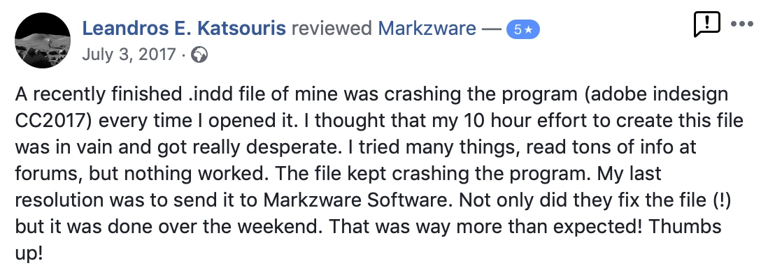

Hello, We at Markzware offer for years an InDesign file recovery service. It has received good reviews and works about 70% of the time. We can fix corrupt CC 2019 and lower layouts. We respond as fast as possible, normally within a couple of hours. So if you're in a rush, we stand-ready to assist:
Friendly Regards,
David Dilling
Markzware
