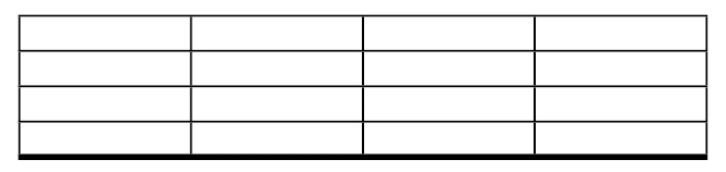

Correct answer FRIdNGE
app.activeDocument.stories.everyItem().tables.everyItem().bottomBorderStrokeWeight = "4mm";

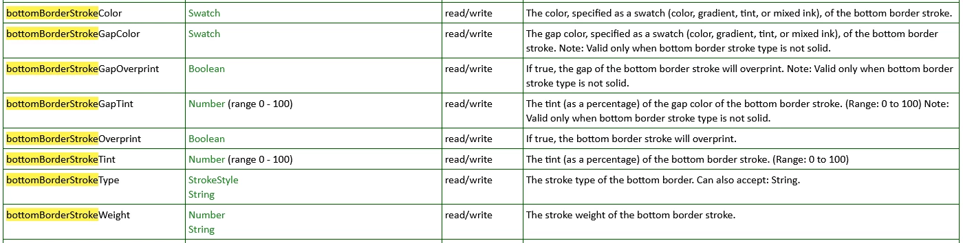

There are more setting you can change:
https://www.indesignjs.de/extendscriptAPI/indesign-latest/#Table.html
Same with Left, Right & Top edges.
FRIdNGE
FRIdNGECorrect answer
January 31, 2024

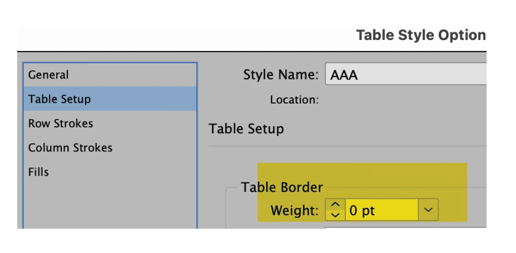

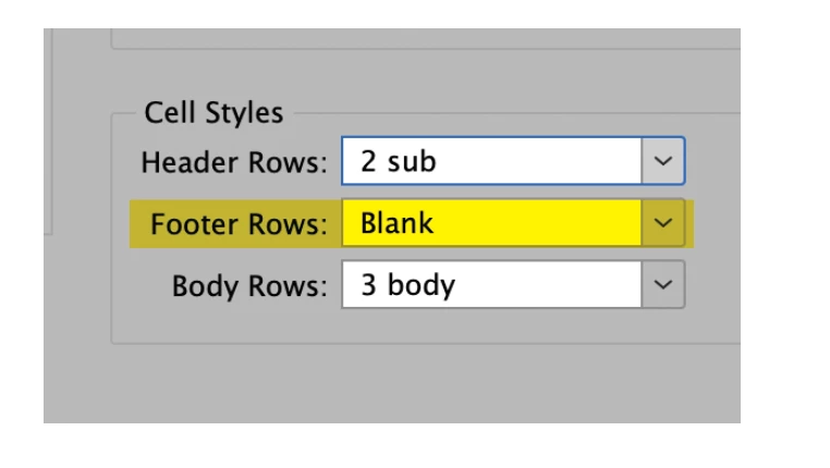

  • Create a Cell Style with the bottom border you want.
  • Define your Table Style to have 1 Footer row.
  • In Table Style Options, assign your Cell Style to the Footer row.
Some tweaking may be needed to get a footer row only where you want it, but that sequence should do it.
This is a Cell Style named 'Footy,' applied in Table Style Options to the Footer row of Table Style 'Footed':

Where in the Table STYLE can you define number of Header/Footer rows??
You can only assign CellStyle - but you can't define how many rows there will be...
OP have 100s of tables - and this can only be done in the Table Options - for each table individually - and increasing number of Header / Footer rows - results in InDesgin ADDING - not converting existing - rows...
