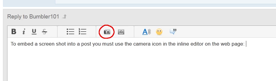

It would really help if you posted a screen shot of your page. Use the camera icon on the web page like this:
