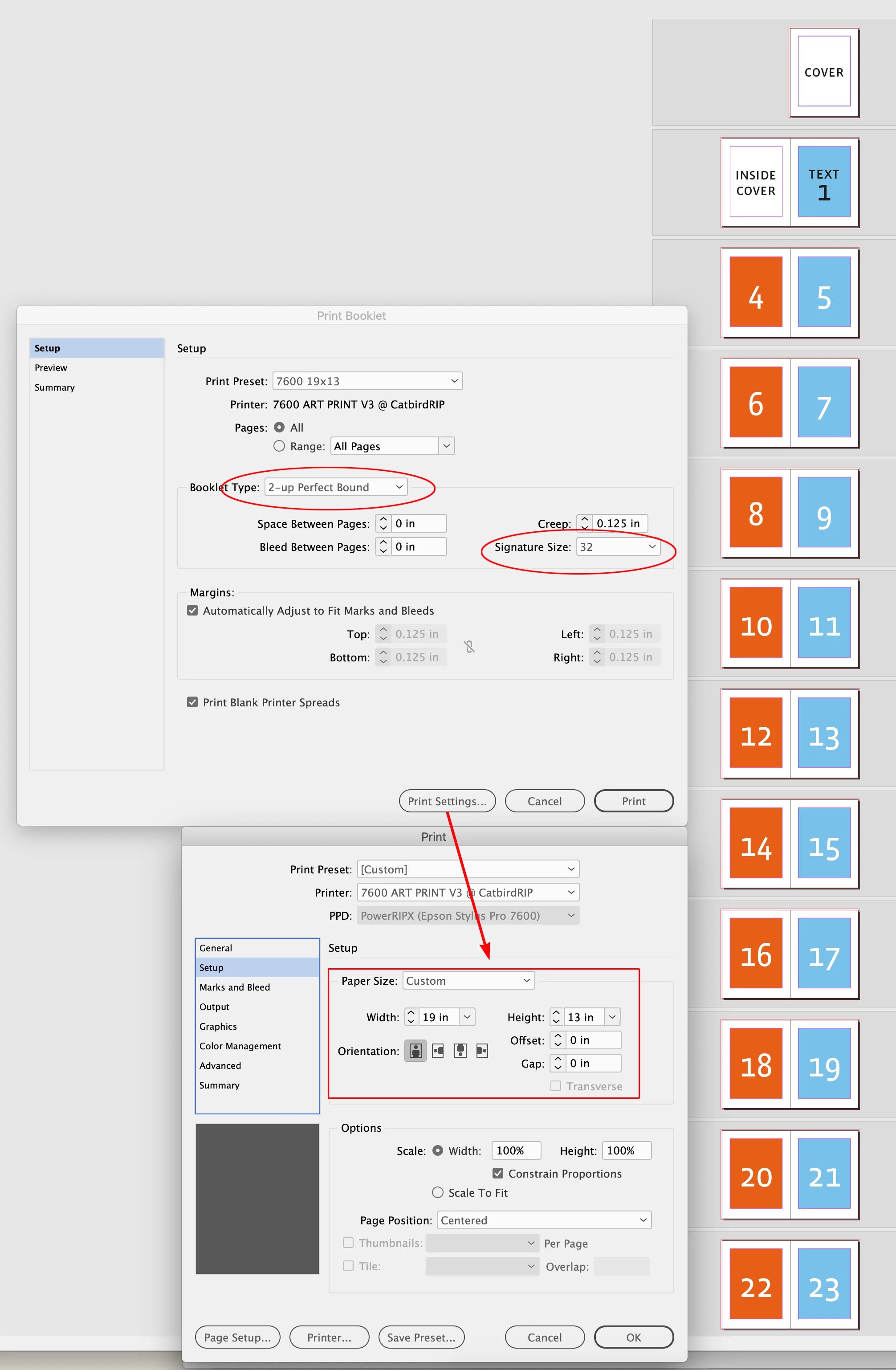

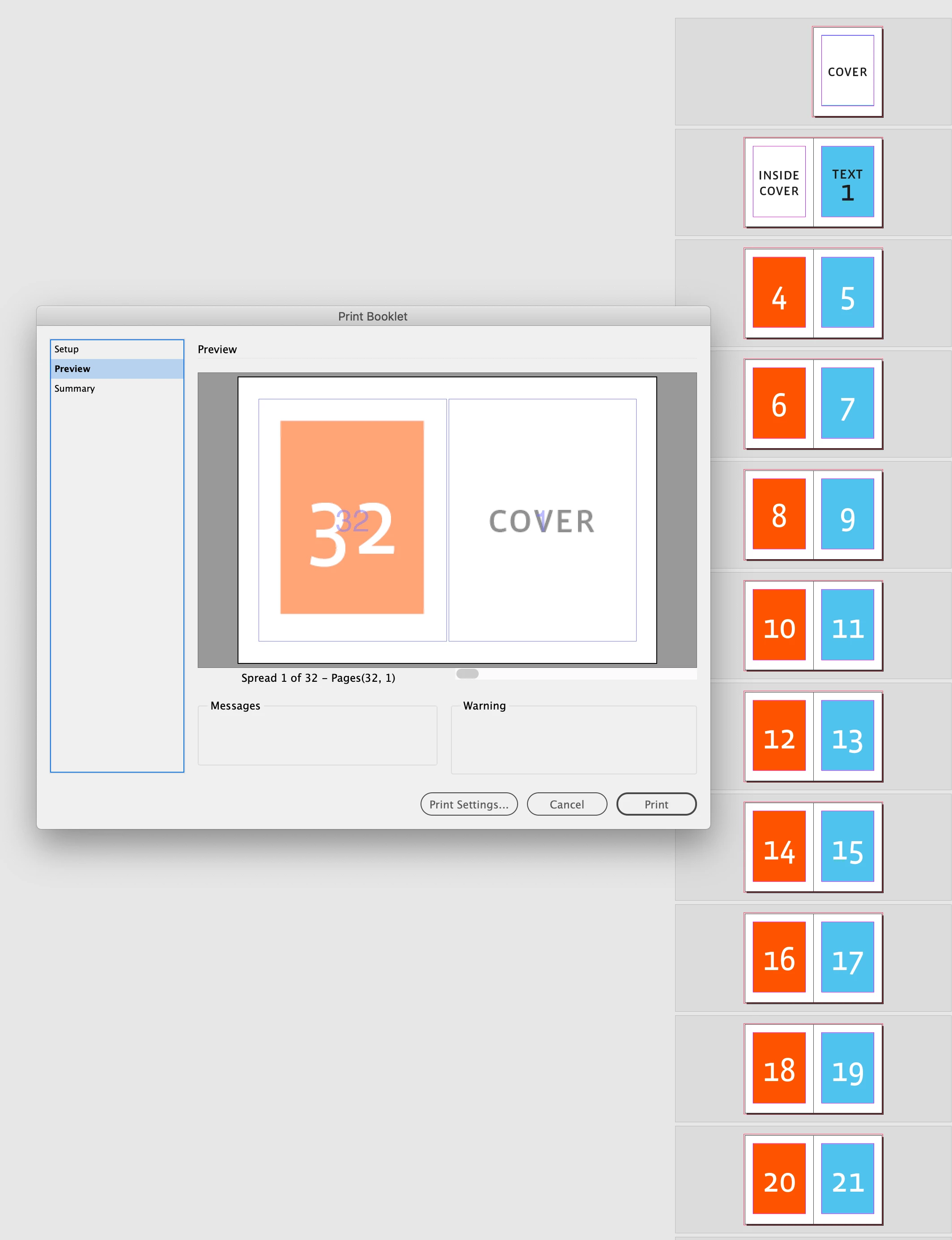

Hi @David Wendelken , InDesign’s Print Booklet lets you print simple 2-up perfect bound and choose a signature size—Acrobat’s Print booklet does not support perfect bound signatures. Set your siganture size in Setup, and your Paper Size in Print Settings...

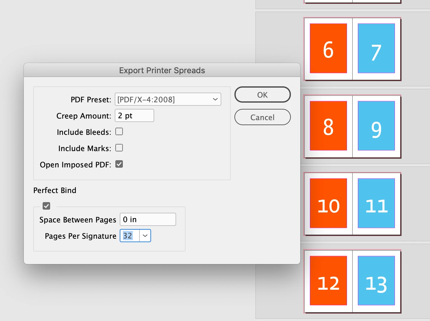

Also, you are welcome to try this imposition script, which exports a PDF as signatures:
https://www.dropbox.com/scl/fo/2wjwe13fsrw9iszebo15e/h?rlkey=nwt5o3uex31fgra7oj15qvs7z&dl=0
