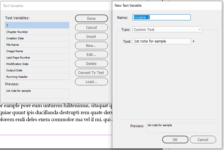

RvdT
February 20, 2023
Yes, this is possible with text variables.
First define a new text variable:
  • Type > Text Variables > Define... :
  • New
  • Type: Custom Text
Then Insert as much as you like
  • Type > Text Variables > Insert Variable > ...
