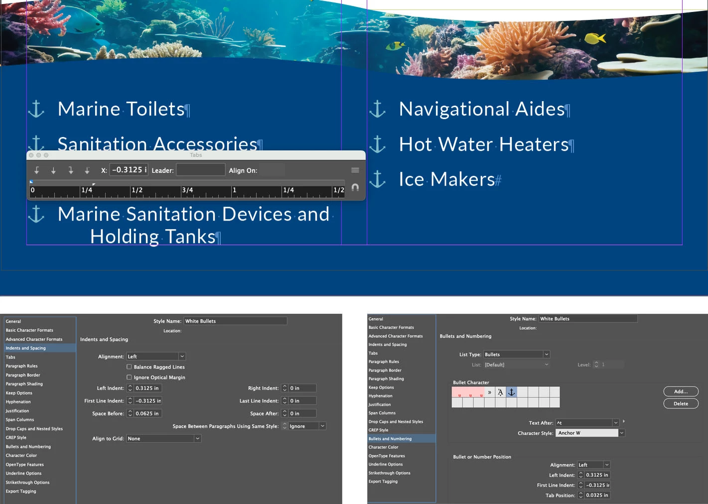

Hi, I have a paragraph style with custom bullets that I have used dozens of times. But the project I am working on currently has added an unwanted second-line indent.
I have fiddled endlessly with the bullet, tab, and indent settings and cannot remove the unwanted second-line indent. A tab could be the issue, but I can't get it to budge. I am using Indesign Beta.
See the issue and setting below.
Any suggestions would be greatly appreciated.
Thank you!
Paula

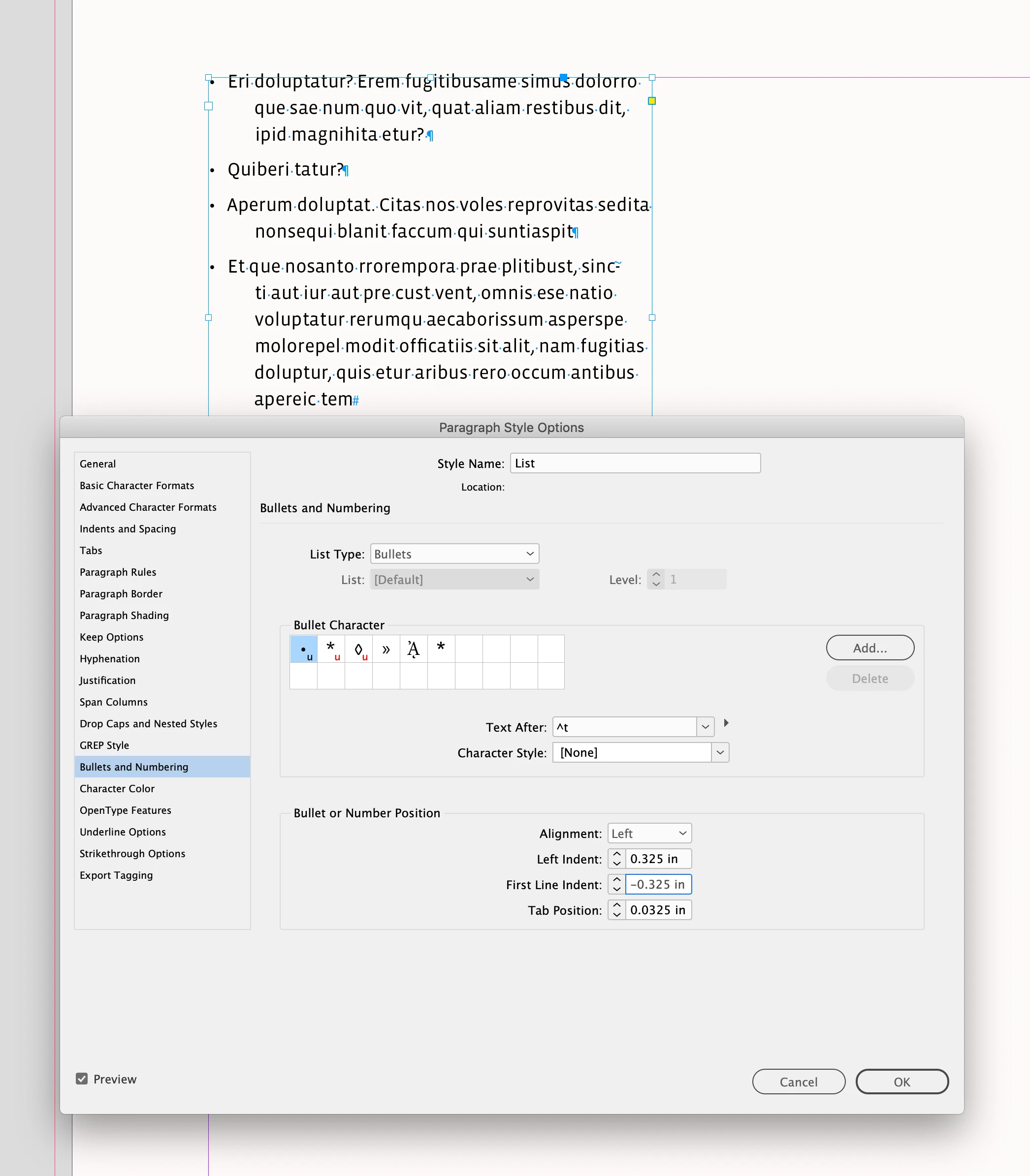

Hi @paulacatherine , If you want the entire paragraph to left align you don’t need a tab (use the Tab Position up arrows to increase the number until the field is blank). If you want to tighten the space between the bullet and text make the Left indent smaller with a matching negative First Line indent:

Looking at her numerical settings, I can't see the fault, but it's the left indent that's further in than the (nominal, not-set) tab. The numbers and the actual text line and tab scale don't seem to match.

Here’s what it looks like with @paulacatherine ’s numbers:
