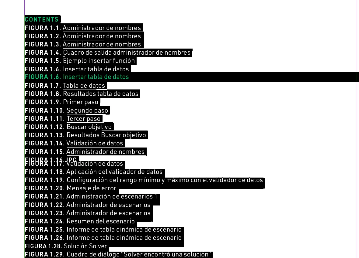

How to save a long table of contents that the Object/Captions/Menu has created inappropriately?
When using these specifications for captions and making a table of contents the result is a mass of unthread frames with their page numbers isolated and converted into anchored items:
I ask for help in order to:
Plan a: how to save this result (below) so as not to lose work and achieve a TOC from this imput?
or
Plan b: avoid a solution that consists of ungrouping the caption in each figure, which forces to execute a lot of manual operation and to lose what has been done. It seems group is the worst solution.
The problem is that using the group caption option in the caption menu creates an unusable result.  Perhaps a bug that I didn't count on.
Thanks

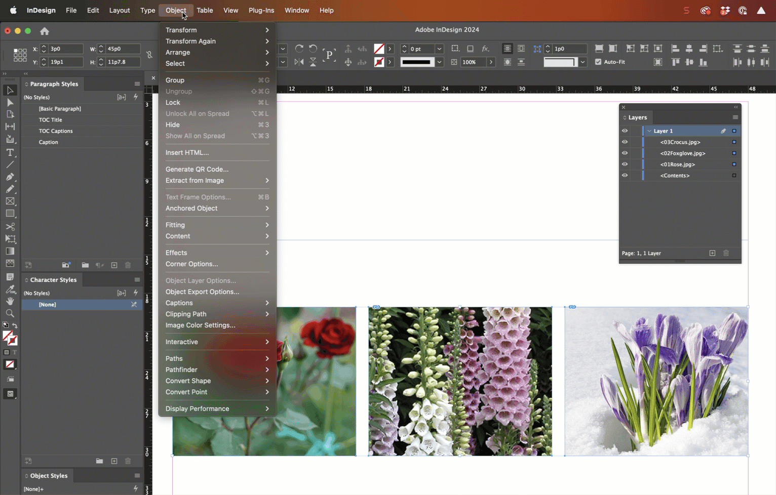

What version of InDesign are you using? I'm trying to recreate this (though collecting description and not name metadata). This is from 19.0.1 and I'm enabling Group Caption with Image in the Caption Setup dialog box before generating live captions and not seeing the issue. Are you on a different version? Or am I missing a step?

That said, I didn't run into any issue with generating a TOC from the generated, grouped, live captions so I'm still unclear what is going on for you. Can you tell me about the role of hyperlinks in your doc? Are you adding hyperlinks to the generated live captions? How are those getting into the TOC?

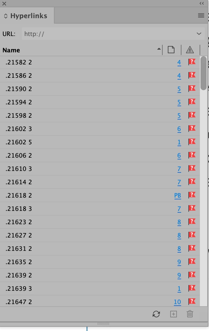

Hyperlinks appeared in a warning notice explaining the non-execution of a table of contents. The file only had half a dozen of them in footer references. And in the that menu there were almost hundreds of them in red. That had already happened with another file without explanation that I sent to the forum without success. Indigestible cables from the engineers, probably.

I suspect there was a style conflict that caused problems. Also,  sometimes during the experiments to fix the mess I got a warning that the hyperlinks didn't have a destination when generating bthe TOC. This is the second time this has happened in three months on a different file. I put the post in the Forum a few weeks ago but there was no response. It seems as an obscure topic that has no information on the web.

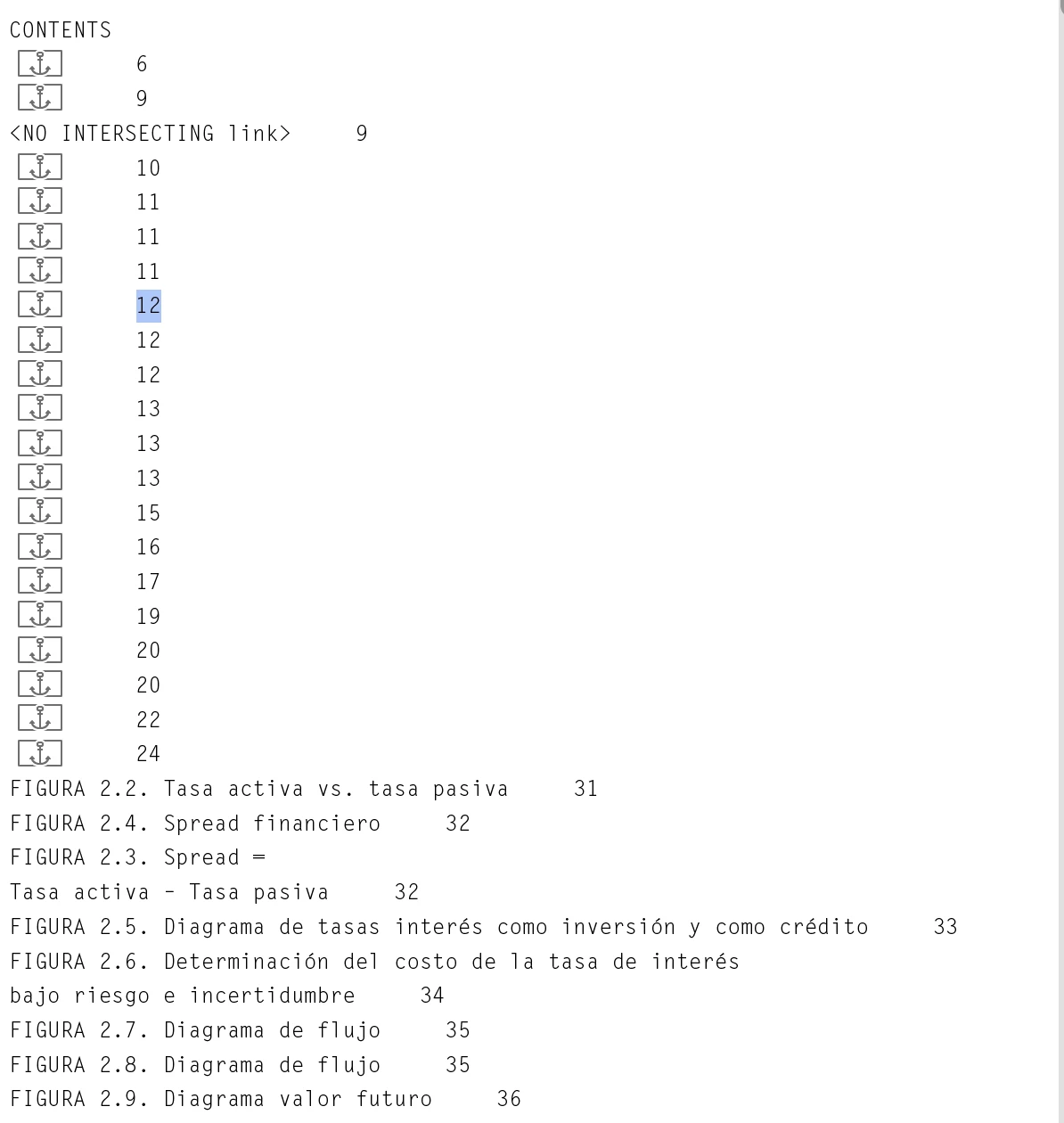

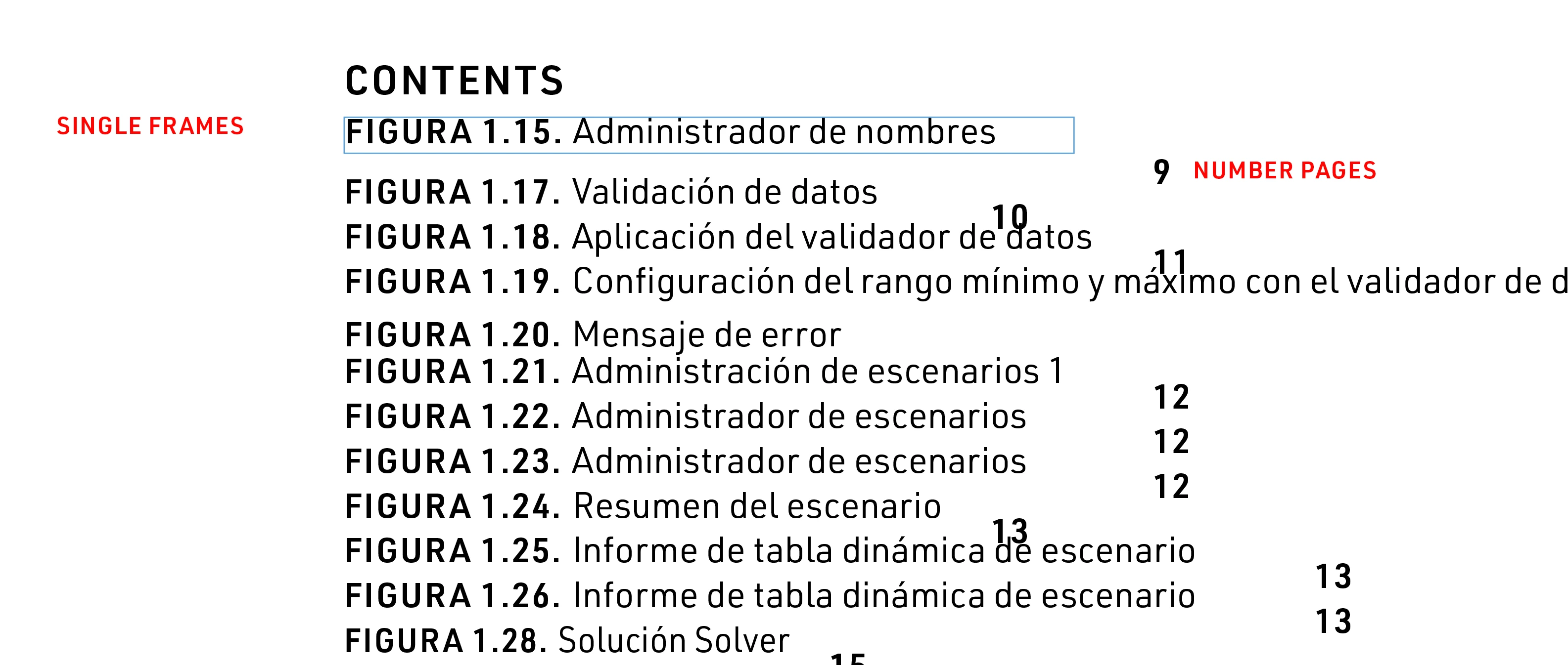

The generated TOC galley behaves strangely. It comes fragmented in unthreaded lines of text. It is selectable but does not make a copy and is clearly a badly damaged galley.

this post clearly stated that generating a table of contents from paragraphs that have been created under the menu Object/Captions only works properly if you do not group the image with the caption, as the menu supplies it. This positive result eliminates that the steps or styles for creating the table of contents are not correct. They are fine if the group option is not used.
Assuming that a table of contents is «poorly» generated when its output has turned into a jumble of loose parts and anchored elements does not seem adequate. It cannot be logically inferred. There is deep structural damage here as can be seen in the photos. Never seen.
Obviously tests have been tried in several ways and the result is the same. Using the "group" function in the captions menu is a disaster. Not using it gives a normal result. The problem is that we need to use this option and now we are faced with repeating what we have already done.
