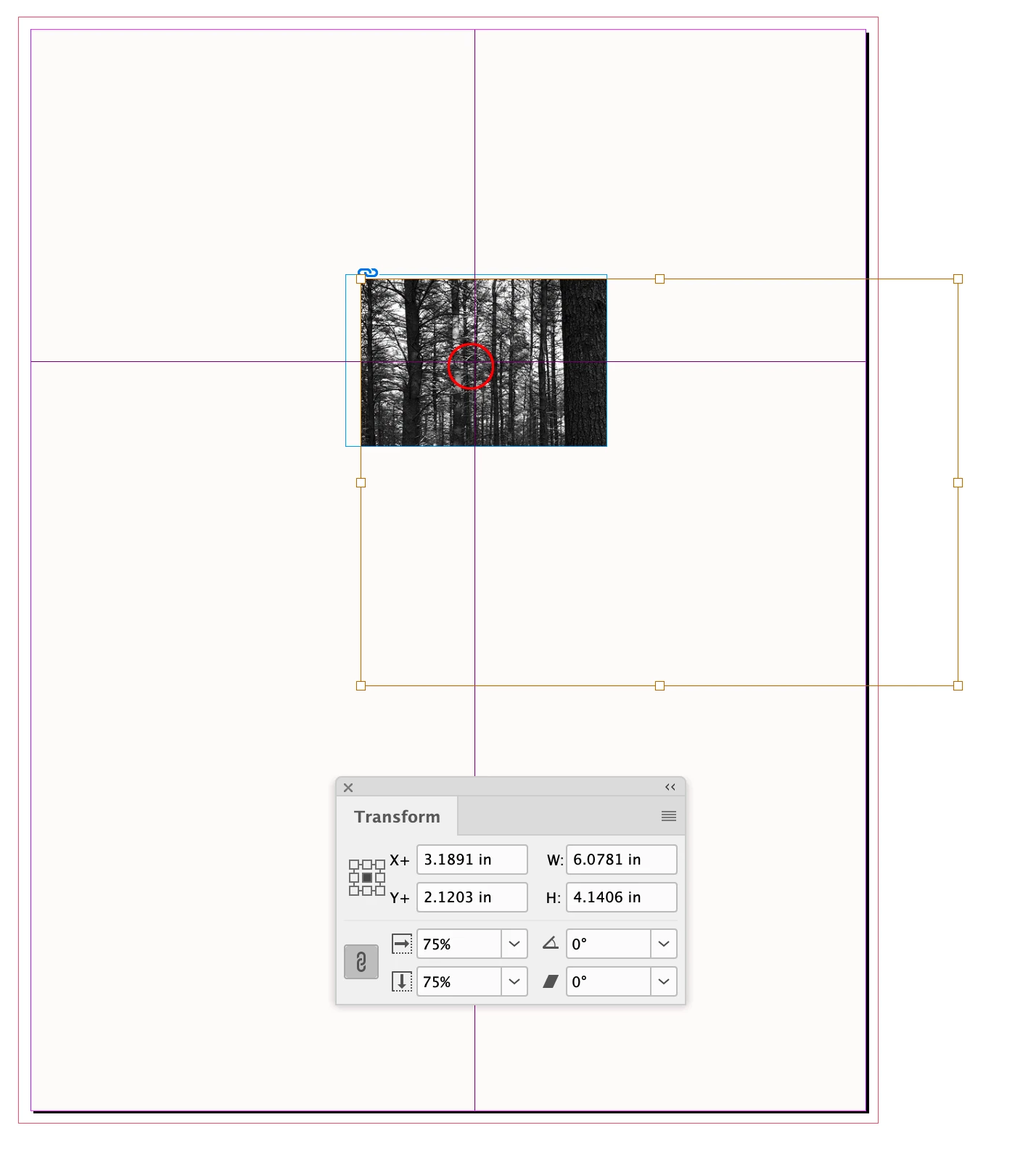

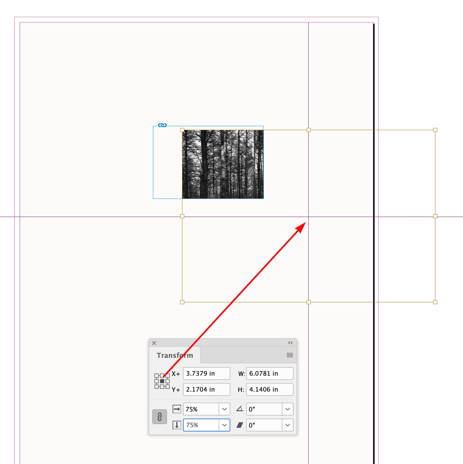

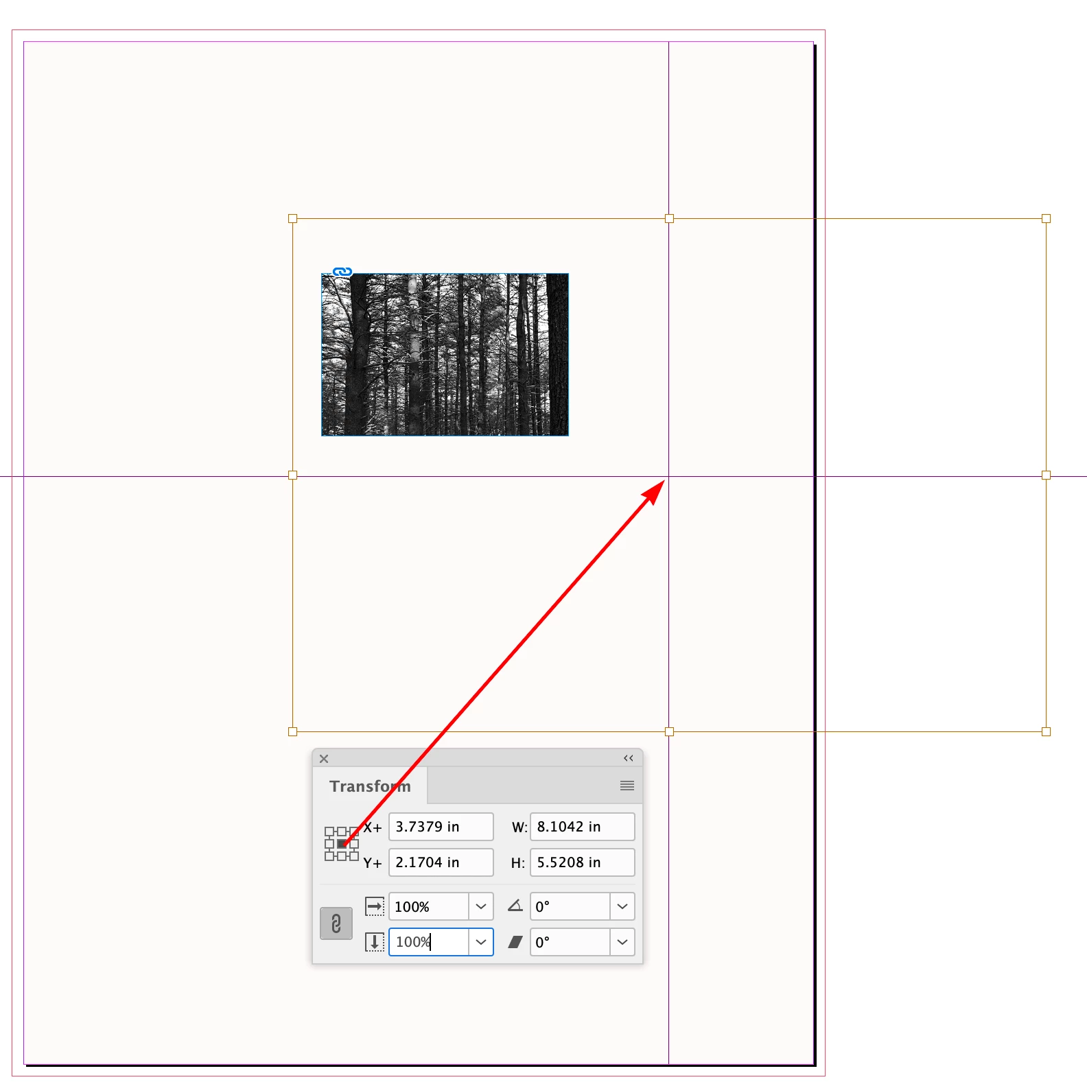

    rob day
    May 9, 2026 9:10 PM UTC
    Hi ​@turner111 , Just to clarify, your large image is not centered in the container frame the way it is in ​@jmlevy ’s capture right? The Transform reference point is relative to the selection not its container
    I think you would need a script in order to scale without moving the image, like this?:
    turner111Author
    May 9, 2026 9:25 PM UTC
    Hi Rob - correct.

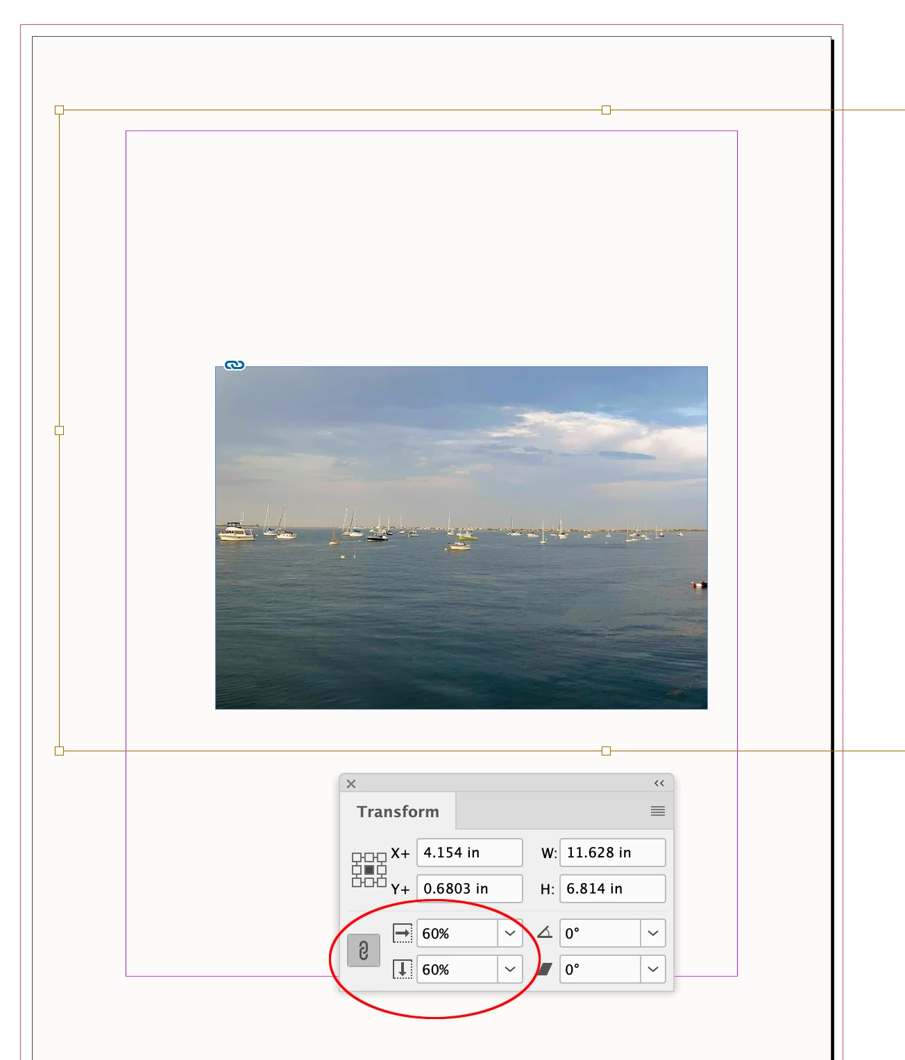

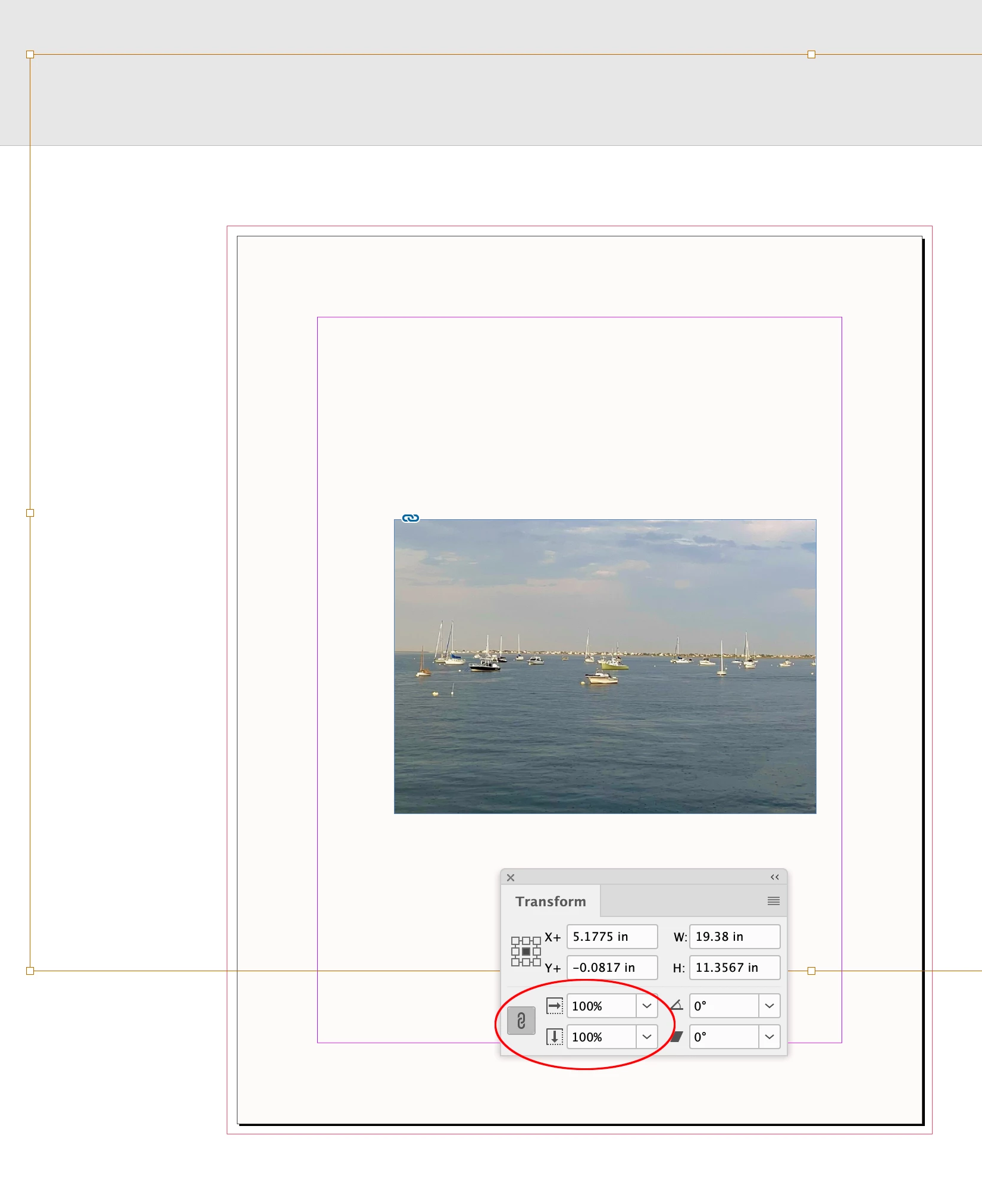

    rob day
    May 10, 2026 11:55 AM UTC
    I might try to figure out a script
    If you haven’t tried to code this yet it’s tricky, maybe this?
    scaleSelectionCentered(.6)
    * Scales the selected link centered
    * @ param ammount to scale
    function scaleSelectionCentered(sa){
    var sel = app.selection[0]
    if (sel == undefined || !sel.hasOwnProperty("itemLink") ) {
    alert("Select an Image")
    return
    var sb = sel.geometricBounds //image bounds
    var pb = sel.parent.geometricBounds //container bounds
    var phc = [pb[1]+((pb[3]-pb[1])*.5)] //container x center point
    var pvc = [pb[0]+((pb[2]-pb[0])*.5)] //container y center point
    var shc = [sb[1]+((sb[3]-sb[1])*.5)] //selection x center point
    var svc = [sb[0]+((sb[2]-sb[0])*.5)] //selection y center point
    sel.transform(CoordinateSpaces.PARENT_COORDINATES, AnchorPoint.CENTER_ANCHOR, app.transformationMatrices.add({horizontalScaleFactor:sa, verticalScaleFactor:sa}));
    sel.move([0,0],[(phc-shc)*(1-sa),(pvc-svc)*(1-sa)])
    Before and after

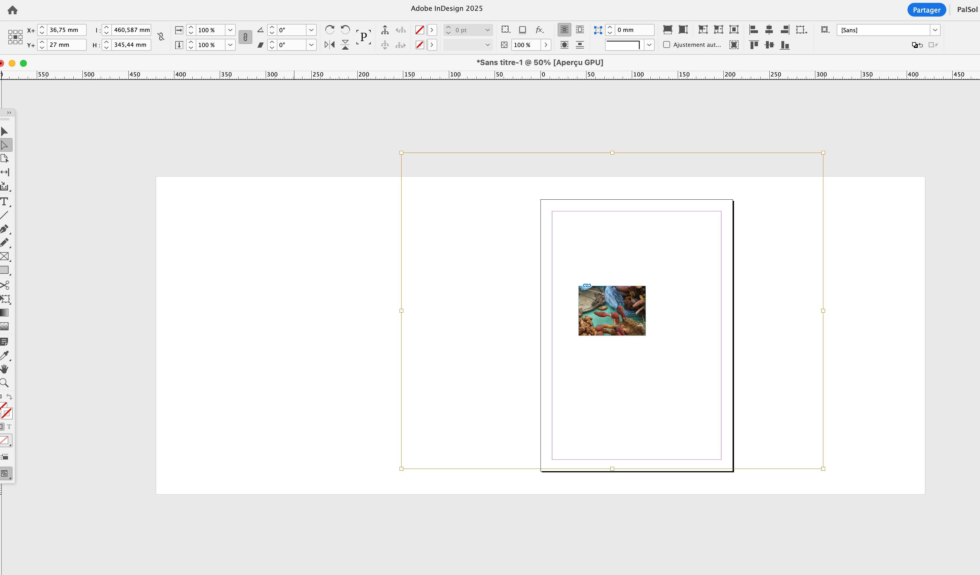

    jmlevy
    May 9, 2026 3:31 PM UTC
    Yes: before starting scaling, select the proxy icon and click on the center dot.
    turner111Author
    May 9, 2026 6:38 PM UTC
    I tried that, but it doesn’t scale the content from the center.
    jmlevy
    May 9, 2026 7:12 PM UTC
    Are you absolutely sure that the content is selected? Because it works:
