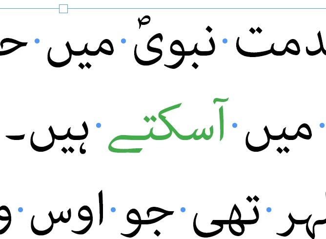

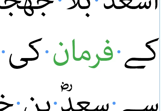

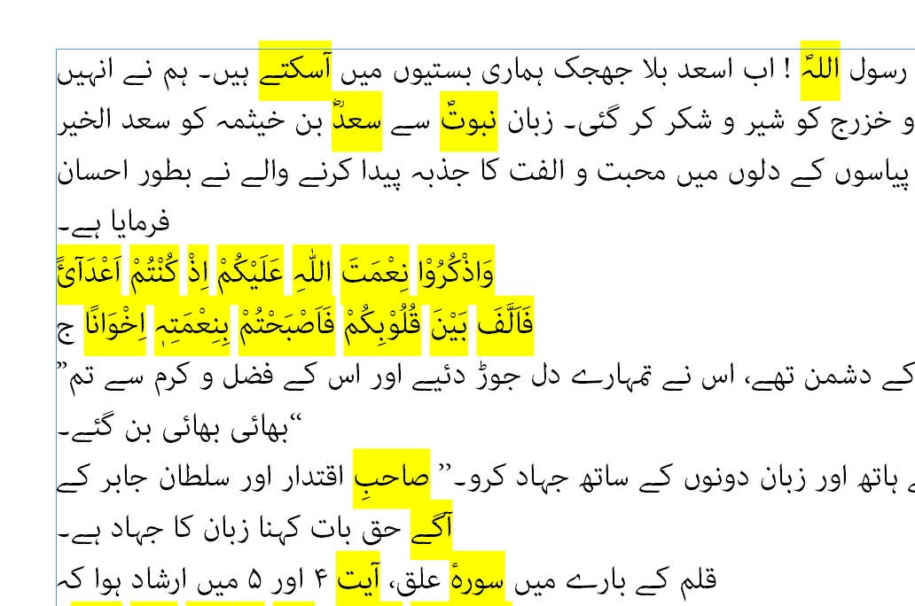

here are two problems with the queries tried out here. The first is that apparently Urdu uses some Arabic diacritics, so that the queries that centre around \p{mn} capture Urdu words as well:
Secondly, by centring the queries around diacritics, (single-letter) words that don't contain a diacritic aren't captured, see e.g. the last glyph in the second line od Arabic in the screenshot, above.

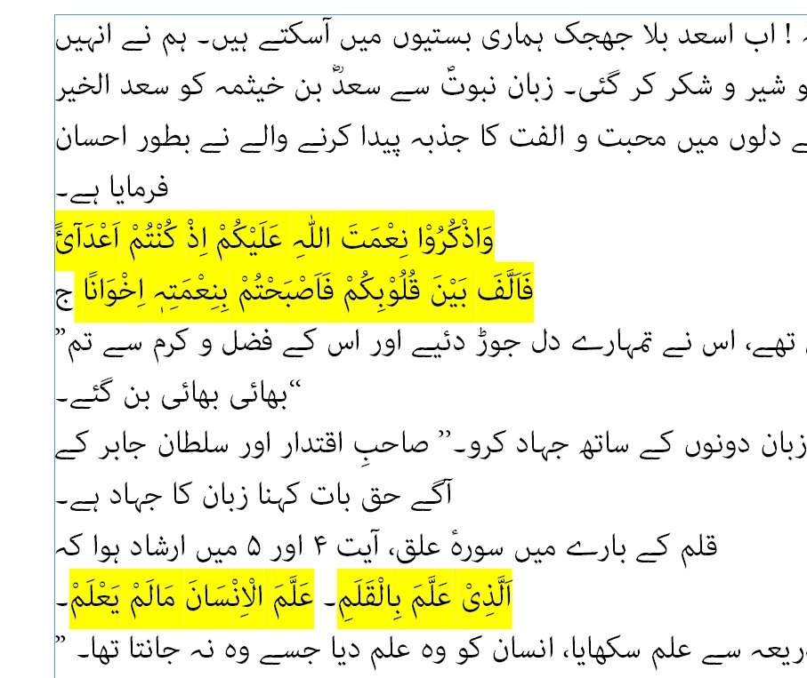

So far @Bedazzled532's (cumbersome) original query appears to work best:
By the way, @Bedazzled532, when you want to assess the results of a query this script is useful:
https://creativepro.com/files/kahrel/indesign/grep_editor.html
It highlights all the matches; the screenshots shown here were taken from the script's captures.
Peter

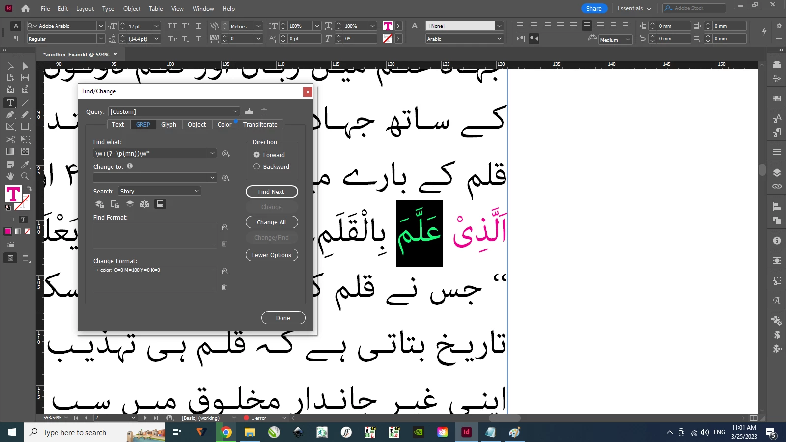

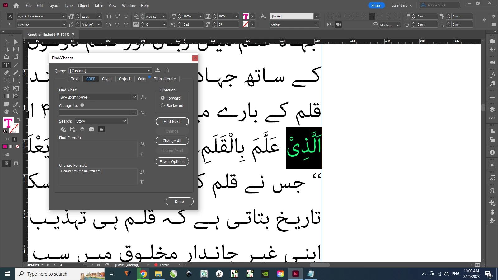

Bedazzled532
March 25, 2023
@Peter Kahrel Even I thought the same that it wont affect diacritics if I use Look ahead. To try that, I did a find and changed itgs color to Red. I tried your code and my code and both works the same, which is weird. In my code it should not change the color of diacritics but it is changing it.
I have attached output of your and my code. Both are working same.

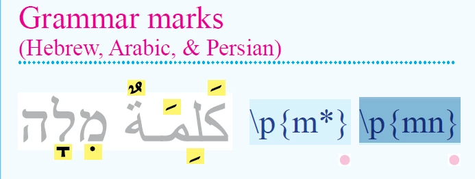

@Peter Kahrel Actually I am looking for a word and through \p{mn} I am looking for a diacritics after that word. If there is a diacritic on it then it means its an Arabic matter otherwise it an Urdu matter.
As per Dhafir Photo's GREP Quickbook, the code \p{mn} looks for Arabic Diacritics. Screenshot attached.
If you look at the bold lines in the sample which I originally posted, you will see that they have diacritics on them and other lines do not.
Using the above code some urdu words will also match but as I said its not 100% code, so I will have to accept it.
If this code can be modified further, I would really appreciate help.

Peter Kahrel
March 22, 2023
Arabic only: [\x{0600}-\x{06FF}]+
You want to add spaces and maybe some other characters, simply add them to the list. E.g., here \h (horizontal space) was added: [\h\x{0600}-\x{06FF}]+
