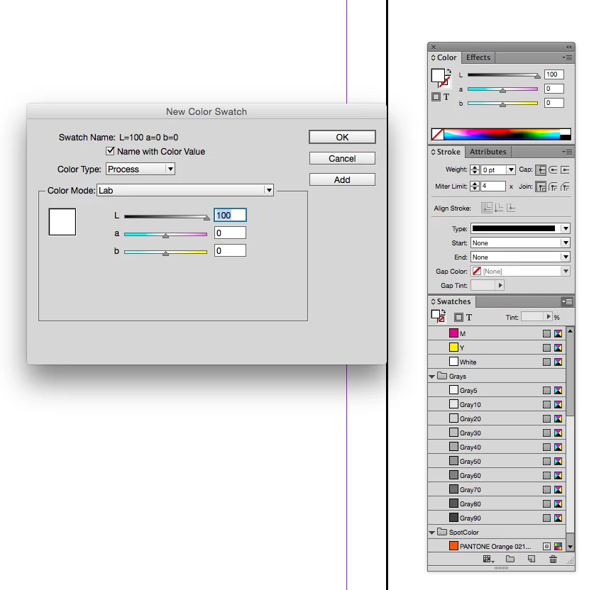

The initial color mode you get when you choose New Swatch from the Swatches panel depends on the current mode you have set in the Color panel. The Color panel's initial application default setting can be set with no documents open. So here my New Swatch dialog is defaulting to Lab because my Colors panel is set to Lab.
You can't set the default New Color Swatch to a Pantone book color, if the Color panel is set to a book Pantone color the New dialog will usually give you a Lab color, which is the color mode of Pantone's solid libraries.

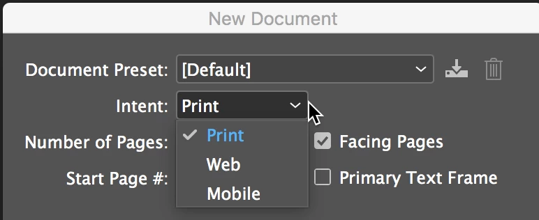

The default color mode is established when you create the document. It depends on the Intent in the New Document dialog (shown below):
For a Print document, the default is CMYK which is appropriate. For Web or Mobile document which is to be viewed on-screen, the default is RGB.

In the new document dialog box, if the Intent is set to Print, the color space will automatically be set to CMYK. If the intent is Web or Mobile, it will be RGB. A document can also be converted from CMYK to RGB by going to the Color panel menu.
