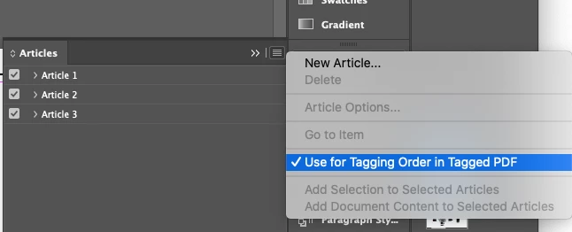

    • Watch out for these Quirks of the Articles Panel
      • — Once you drag one element, frame, graphic, etc. into the Articles Panel, everything must be dragged into it. It's an all or nothing tool. If something is left out, it will become untagged content in the PDF, not artifacted, but not accessible either. The left-out items are in Zombie-land...neither alive nor dead and often fail accessibility checkers.
      • — For each Article you create in the panel, check its option to Include When Exporting. Easily missed when you're on deadline and so frustrating when it doesn't tag your stuff! Wish Adobe would set its default to ON so that we didn't have to think about this one. Don't foret to set it for each Article.
      • — Set the panel's options to Use for Tagging Order in Tagged PDF. This is in the panel's options drop-down menu. Set this once and it controls all articles in the panel.

FOLLOW UP: you can control the "read order" and the "tag order" by putting each text frame into InDesign's ARTICLES pane ...and SELECT the "Use for Tagging Order in Tagged PDF" option from the Articles pane drop-down menu. (see attached image.)
For threaded content, you only need to put the FIRST text frame inside the article pane.
The Articles pane allows you to select and drag the content into any order you choose. And, as long as you select the "Use for Tagging Order in Tagged PDF" option, the tags will be PERFECT on the PDF output.

When using  InDesign's ARTICLES pane to control the "read order" and the "tag order" ..you must SELECT the "Use for Tagging Order in Tagged PDF" option from the Articles pane drop-down menu. (see attached image.)
