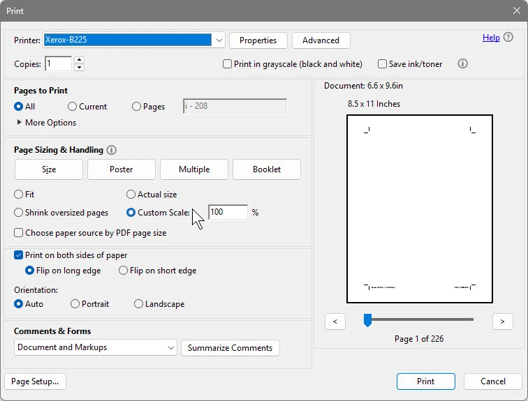

    Randy Hagan
    Feb 4, 2026 12:29 PM UTC
    I would check my settings for printing the PDF.
    By default, Acrobat is set to Fit the page onto the output sheet in the Page Sizing & Handling section of the Print dialog box. This ensures that you get the entire PDF document page layout on the sheet you print it on. I would try changing the options to Actual Size and print it, then to Custom Scale: of 100% in the print dialog box, and see if you get better results than running with the defaults.
    I recommend that you try both of the full-sized page options, because sometimes anomalies you can’t see may affect how your final output appears on the printed sheet. I’m hopeful that you will find the right setting(s) there to get the printed results you’re looking for.
