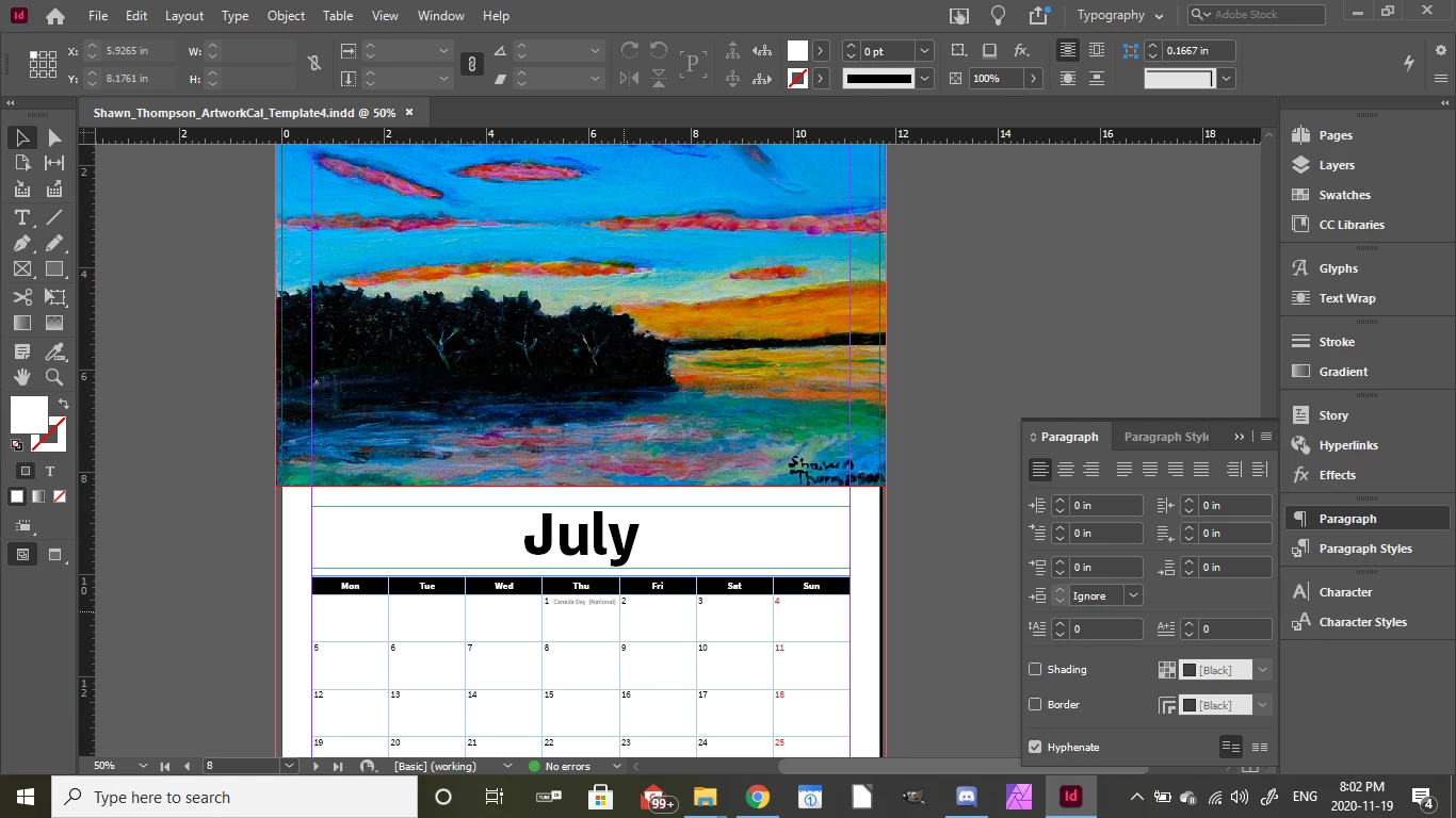

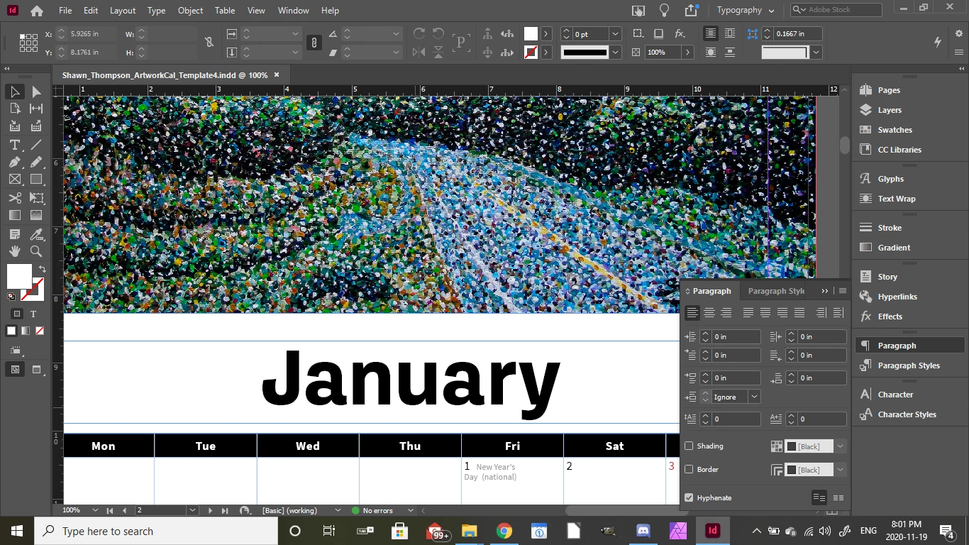

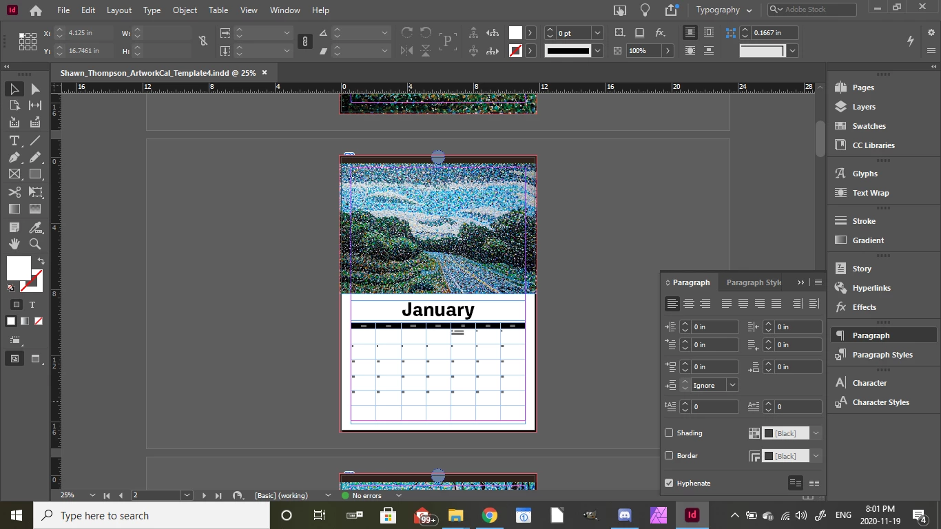

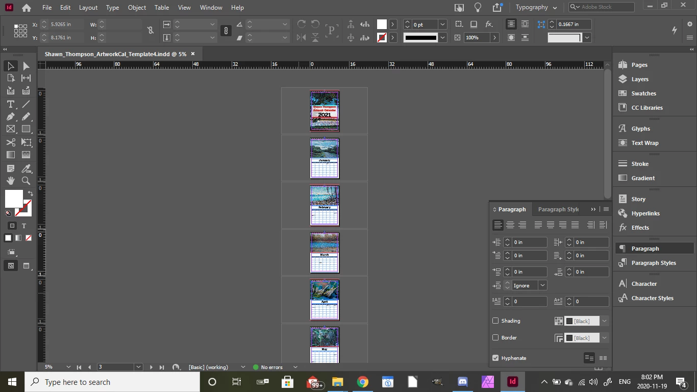

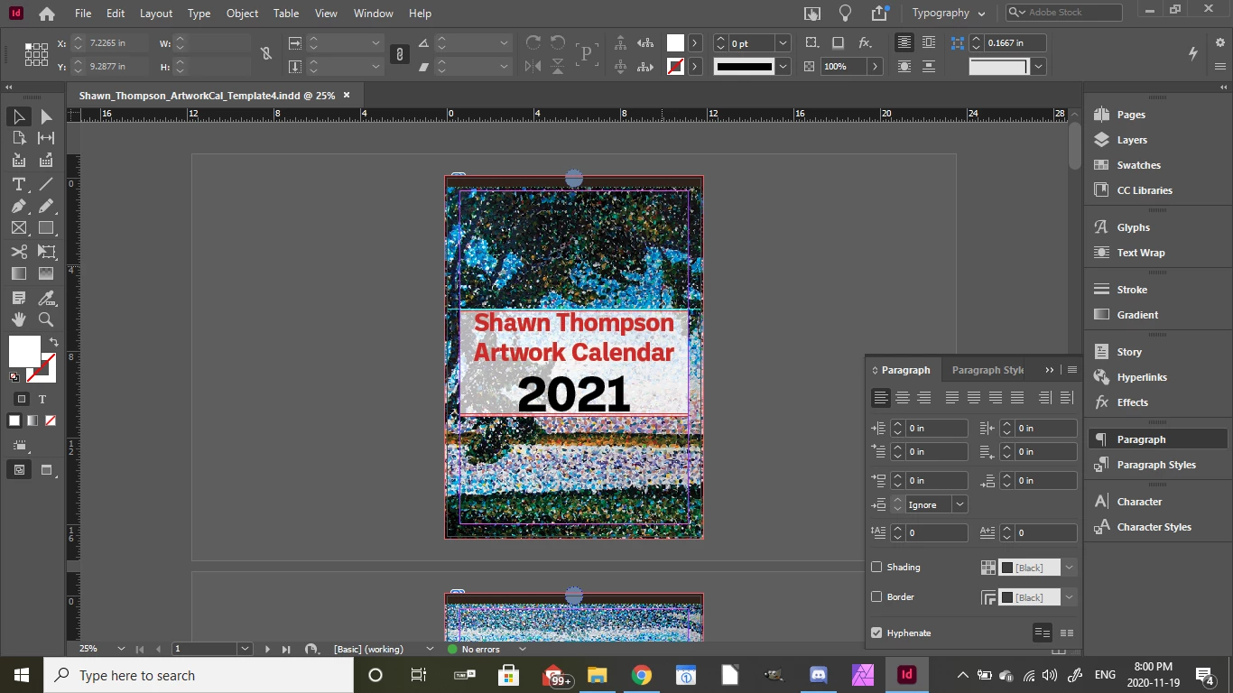

I've been trying to create a calendar in Adobe InDesign, and found what I thought was a good template to make things easier.
However when I try to print it, I have no idea how to get the pages in order to fold up the way how a typical wall calendar does. I printed a very rough version of the calendar, but it does not seem to fold up right. Is there a way specifically designed to set up a calendar with a fold in InDesign?
In college I always had a hard time figuring out page order of a book, especially with folding pages by hand. I did manage to find the print book feature in InDesign but it seems useless for managing the folds in the calendar.
Here are some pictures of my setup. It is an A3 piece of paper.
It seems that in order for it to print properly the images need to be in a different order so that the image folds in place for each month.
