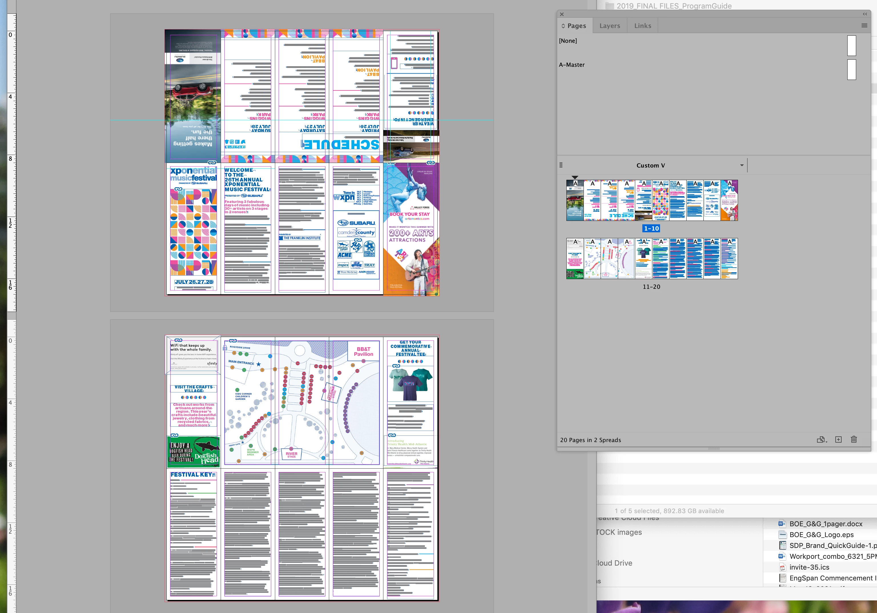

I am updating a brochure for a client that folds like a map (I believe it's called a double accordion map fold based on a printed guide I have from the foldfactory.com. They have given me all the Indesign files from when it was created several years ago. I'm baffled by the page set-up in the document. Somehow the pages appear to be automatically reversed/("ganged up" for print) in the main art board window, while they appear side-by-side in the pages panel. (ssee attached screenshot). I cannot figure out how this was done, which I'd like to know in case I need to recreate this from scratch or make any adjustments. Anyone know where/how this is done?

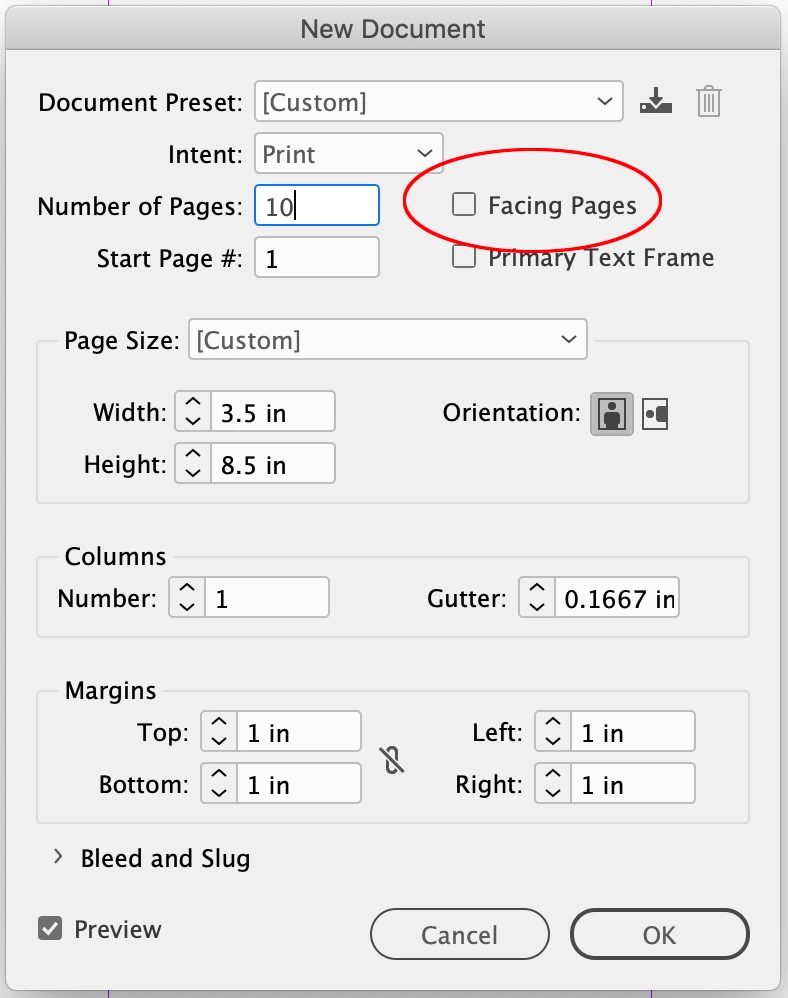

Try setting your New Document Setup to something like this—Facing Pages unchecked, Width and Height set to the folded trim:

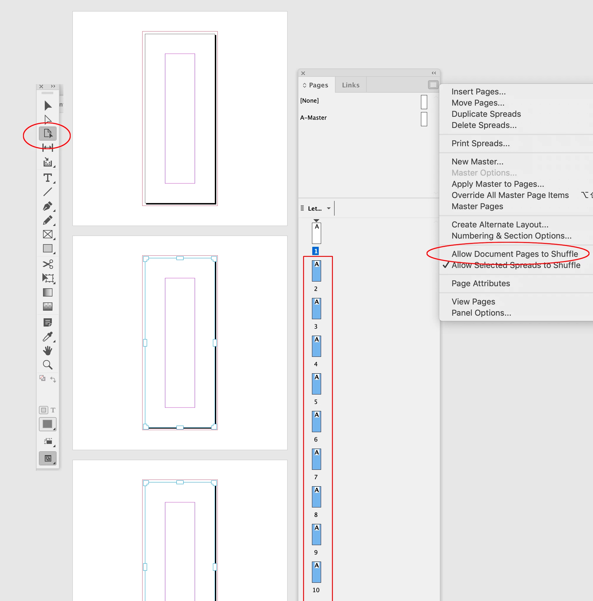

With the Pages tool selected, select pages 2-10 in the Pages panel and make sure Allow Document Pages to Shuffle is unchecked:

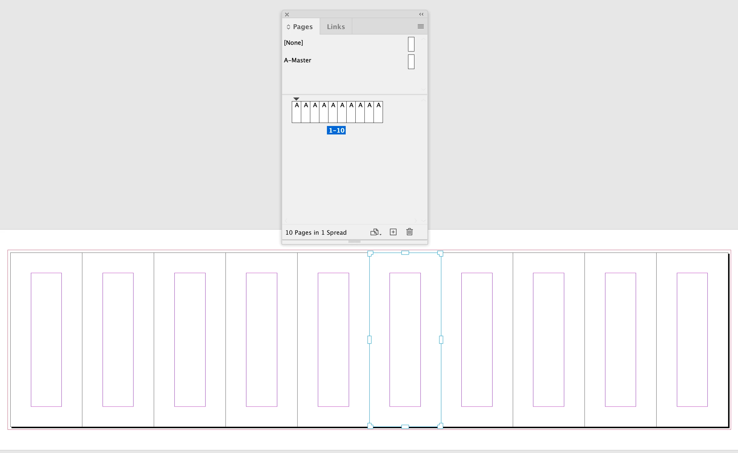

Drag the selected pages to the right of page 1 until you get a bar icon:

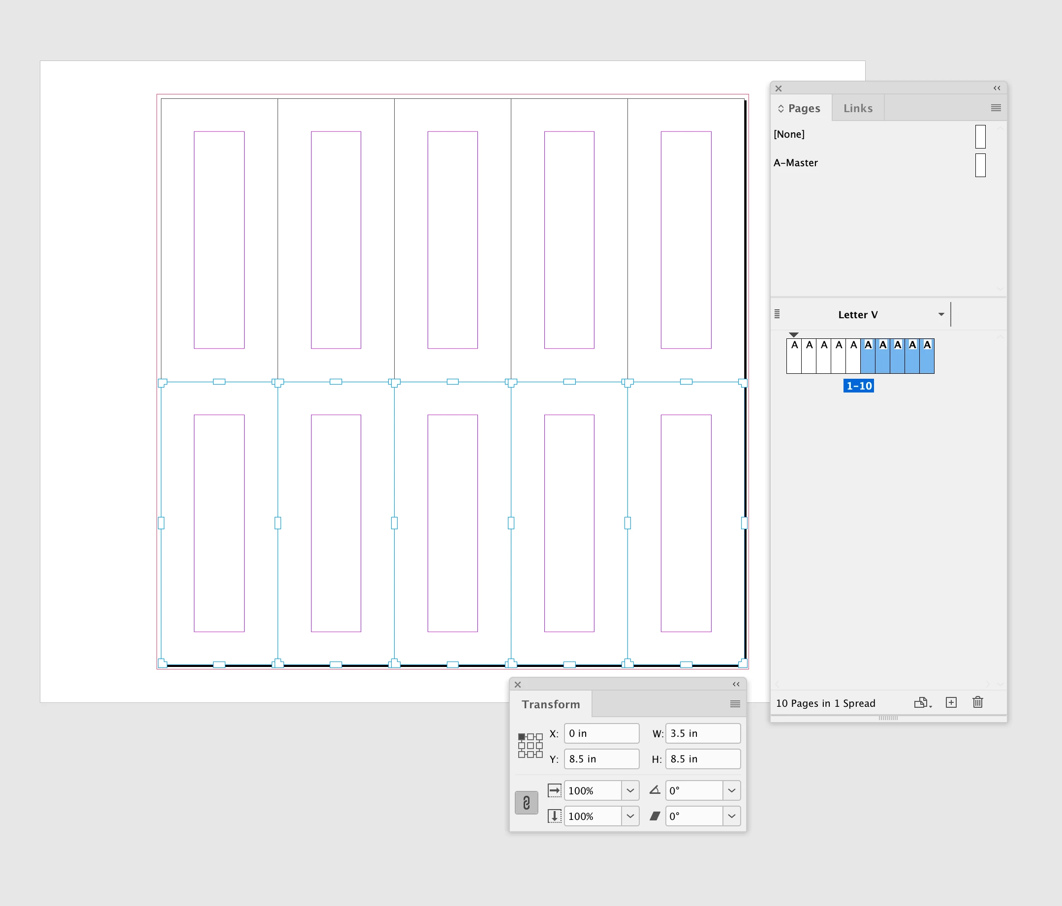

Open your Transform panel and with pages 6-10 selected with the Pages tool, set the transform reference to upper-left corner, set Y to the page height (8.5" here), set X to the width minus the width x 5 (3.5in - 17.5 here):

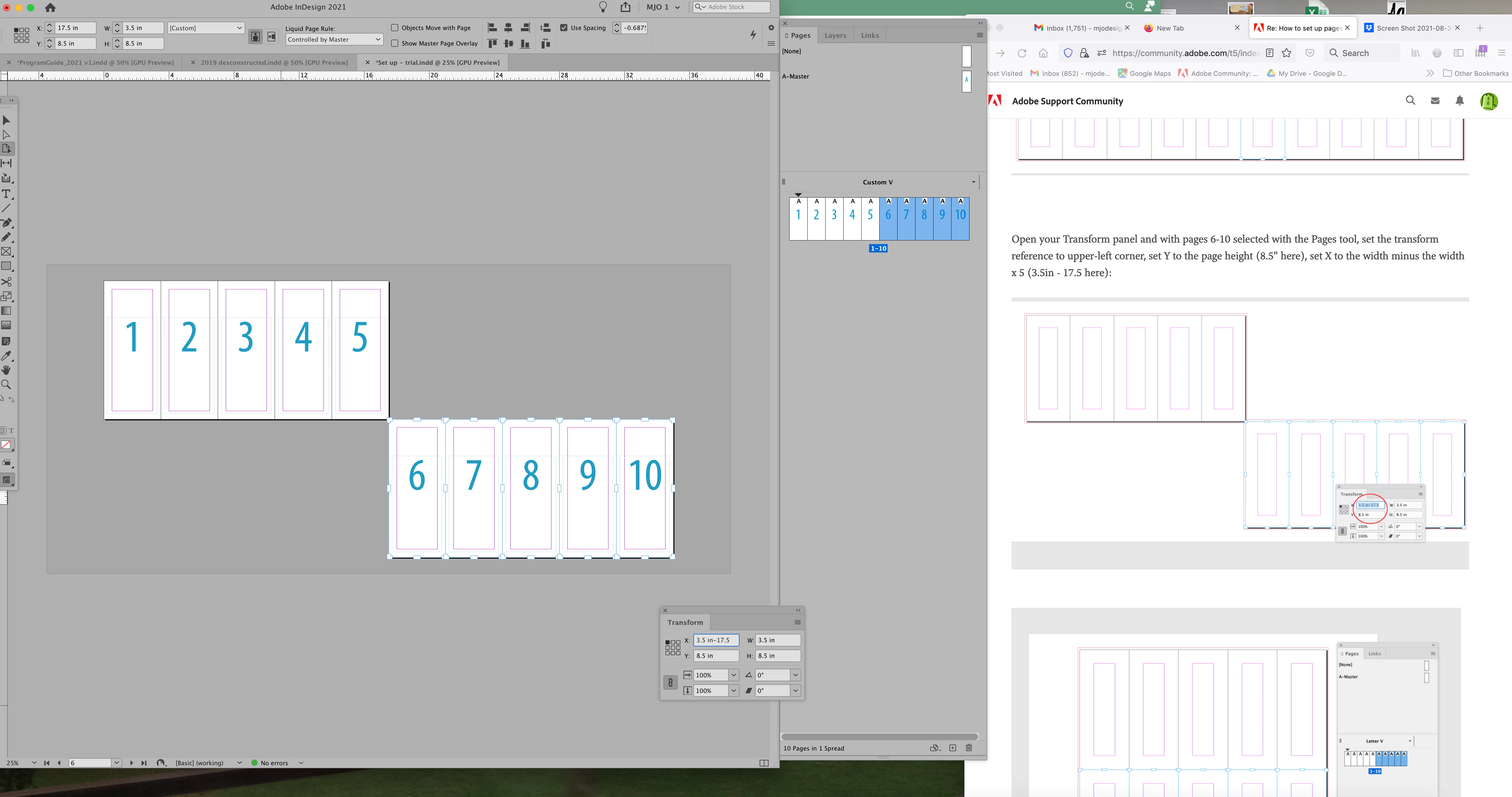

Thanks for these clear and detailed instructions. I was able to follow everything until the last step: When I set up the Transform exactly as you describe, the panels don't align the way yours do. Only panel 1 lines up over panel 10. I've attached screen shots with my file on the left and your instructions on the right, showing the panels and transform settings before and after that last step. Did I miss something?
ALSO, the top panels need to be upside down so it prints correctly. Is that included in your instructions? (I can't tell because there is no content on the pages. I added page numbers to mine.)
Thanks!

Not sure how that happened, but maybe try selecting pages 1-5 and setting the X to 0? In your capture page 1-5 have moved to 14". You can also manually move the spread by dragging—I prefer the Transfom dialog for checking accuracy.
No, you would have to rotate the content. You could design the panel pages in a separate InDesign document, place those pages in the "imposed" spreads document and rotate the links. Also as @Luke Jennings3 mentions the panels might have to be slightly different sized to accomodate the folding. You are basically imposing the panel pages, so it might be worth communicating with the printer on the setup.
