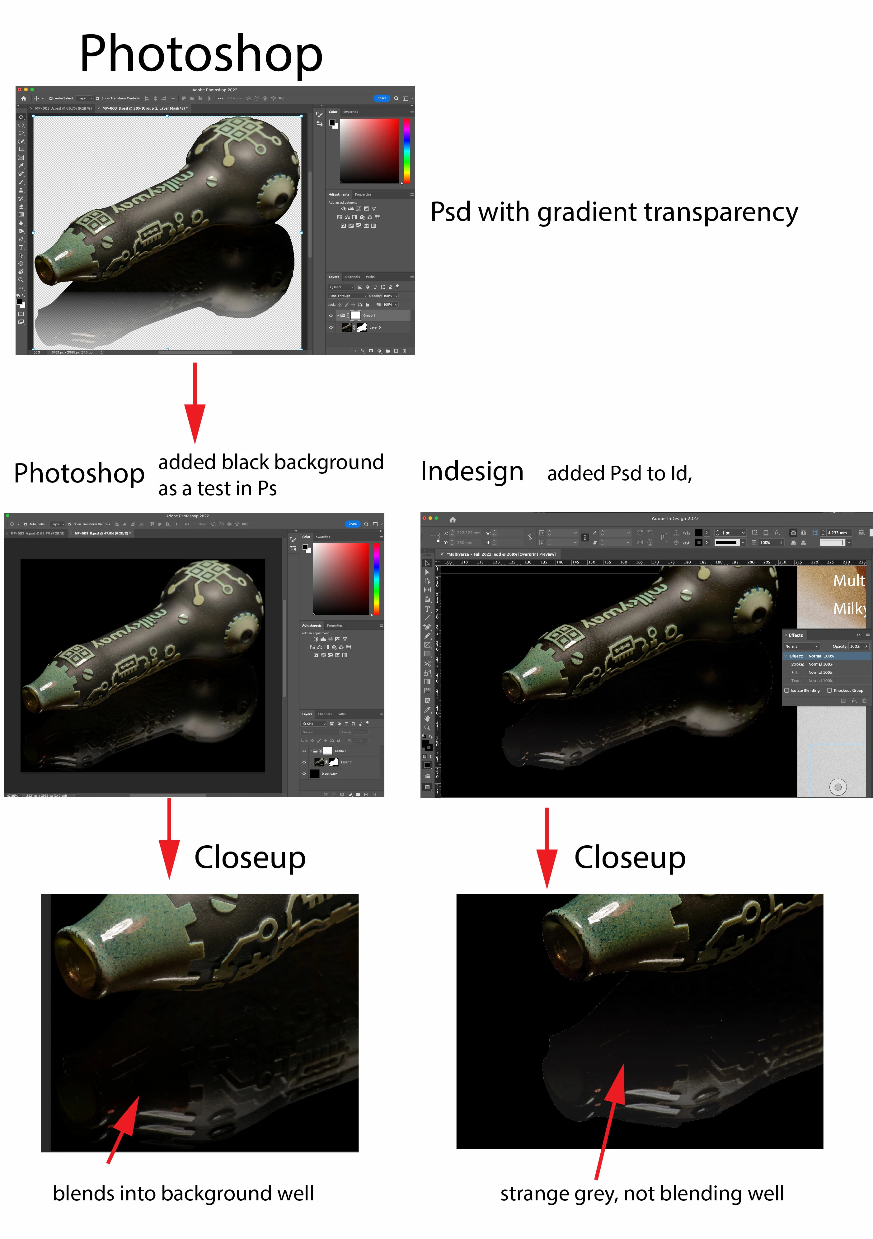

I am placing a psd file over a black background in inDesign for a printed brochure.  The psd has a transparency gradient on it which i applied in photoshop.  The psd is interacting with the black background and producing a grey effect that doesnt blend into that black background (which is set to 'regisitered').
This seems to be a problem with everything.  any transparency applied in any way interacts with the black background placed via parent pages. I've tried adding different blend mode, but can't seem to get rid of this, does anyone have any advice?

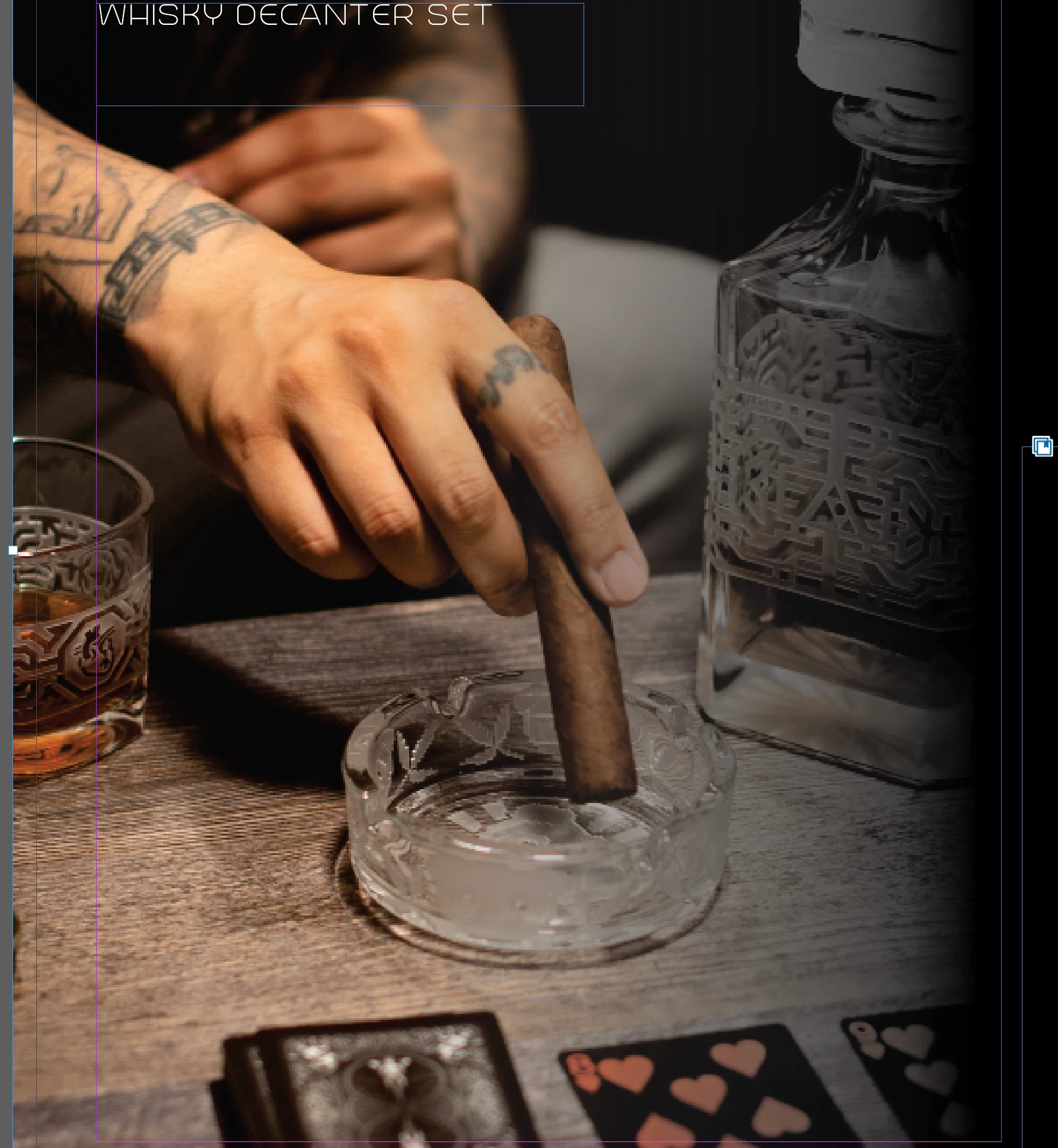

Hi Mike, I tried using 'black' still getting a similar result.  I also noticed that then i use feather transparency tool, the black bleeding through mutes the color making it look black and white, not sure if this is related to this issue.  Please see attached.
If there is no way to do it in inDesign, then i'm fine to do it in Ai then place that PDF in indesign.  If so, any pitfuls in doing that?
thanks!
