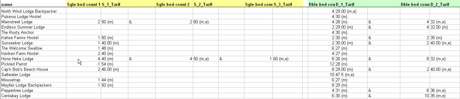

I have a large spreadsheet that displays the bed count, price and room configuration.
What knowledge I do have is that I can create character styles in InDesign, complete a datamerge and layout the template.  I intend to use the character styles for the colour coding on the room type configurations.
My problem is I don't know how to identify the different price colours and range by the fields given to me in the spreadsheet without having to manually place each room type, bed count, price and colour ID in separate columns.  This would be too manual a process.
Here is an example of what I have to work with in the spreadsheet including a hostel record for a visual.  Please note that the room config types are showing by using (m) madeup (m,e) madeup ensuite (e) ensuite. And for those room types ie Single, dorm etc that have no beds at all to offer then I need to insert a hyphen "-" only.

My problem is not how do I layout a template in Indesign and how do I merge the data, its more like "how do I clarify the data in the spreadsheet column to separate them into using conditions in Indesign".  That's the best I can describe my problem.
I explained my conundrum in my first message in this thread.
