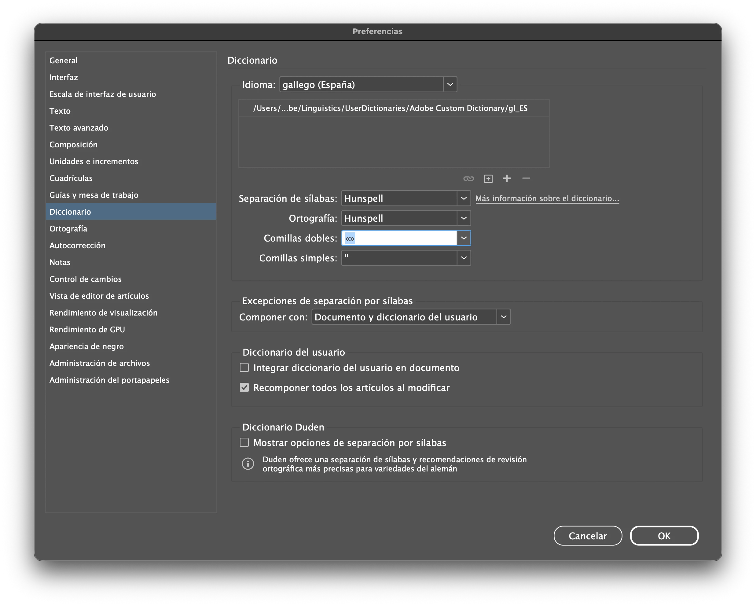

What is Edit > Spelling > User Dictionary set to?
What is Edit > Preferences > Dictionary set to?
Could you post screenshots of these?

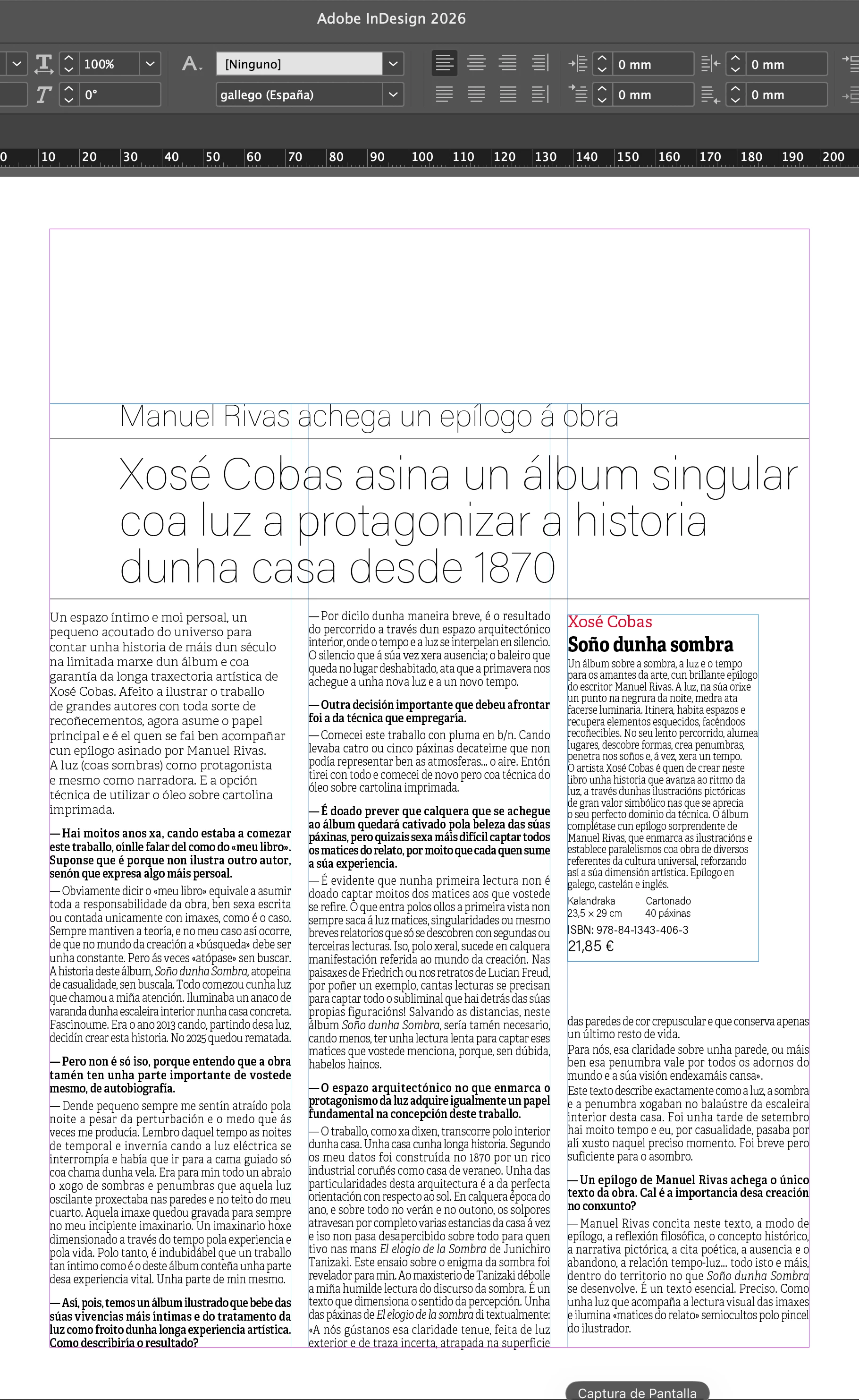

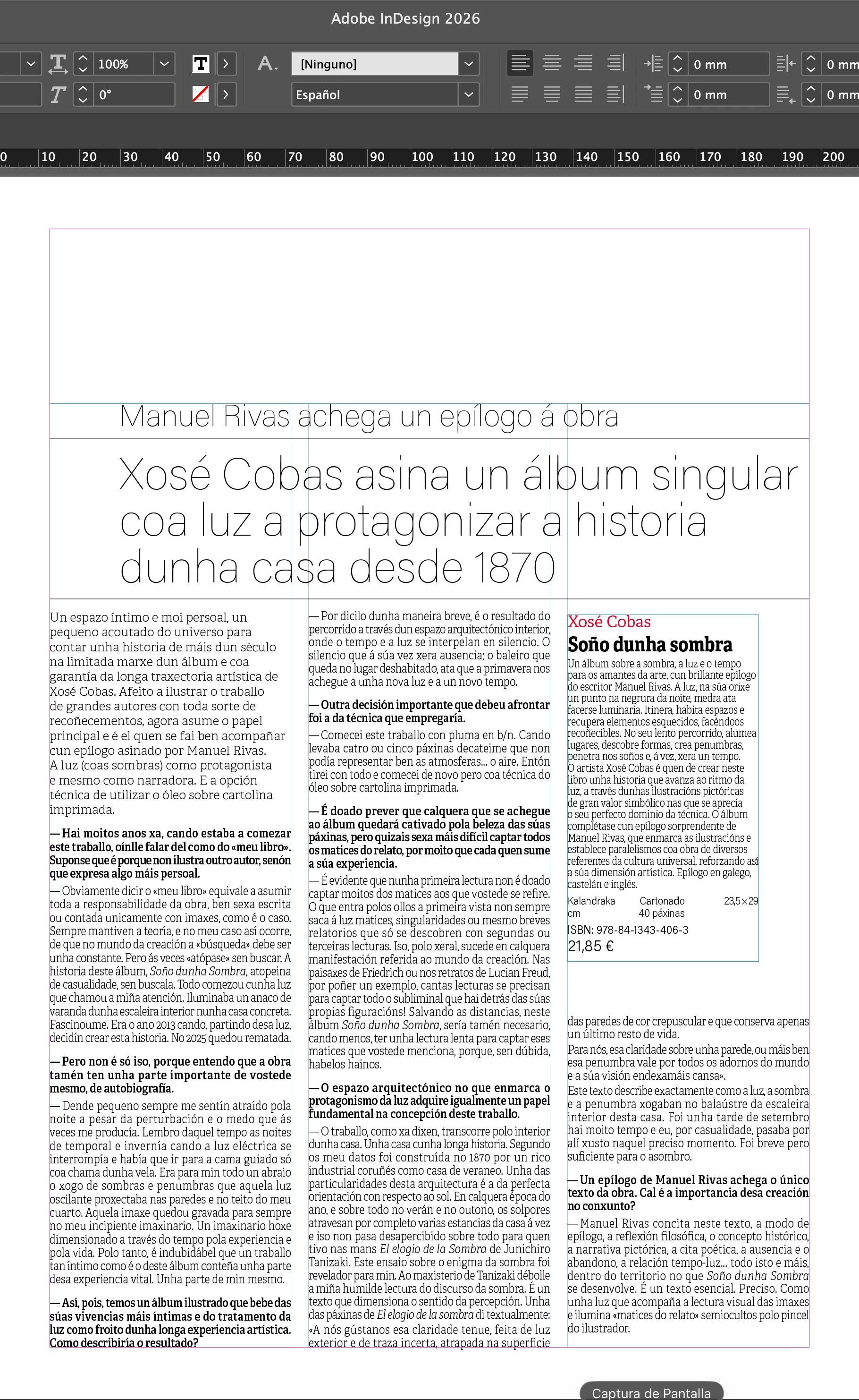

Nov 14, 2025 10:01 AM UTC
I can send you any screenshots you like, but I don't know what use that would be...
Notice: The OS is in Spanish, not English. (It doesn't exist in Galician unfortunately)
  • The first screenshot, Preferences: Indesign shows no anomaly.
  • The gl_ES folder is installed in .../LILO/.../Adobehunspellbundle.../Dictionaries
  • Second Screenshot: Galician text appears to be correct. All partitions are fine.
  • The unit is turned off. It is turned on and
  • Third screenshot: Indesign does not understand any hyphenation. Neither in Galician nor in any other language. (Screenshots 4 and 5)
