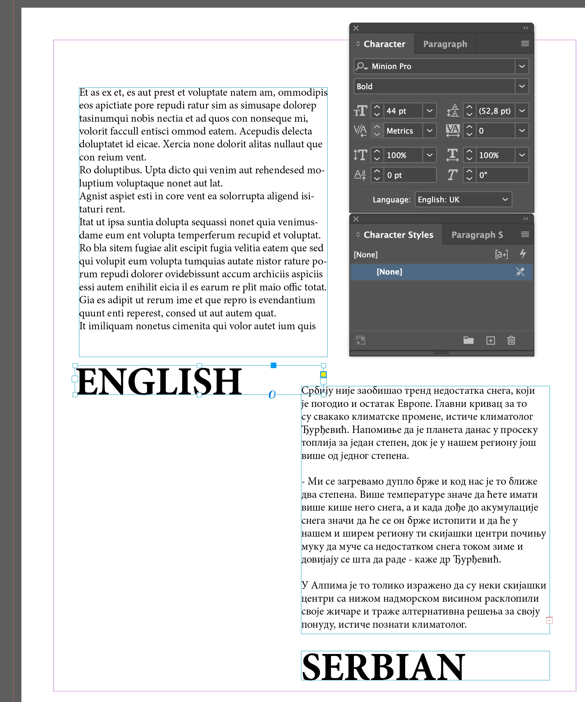

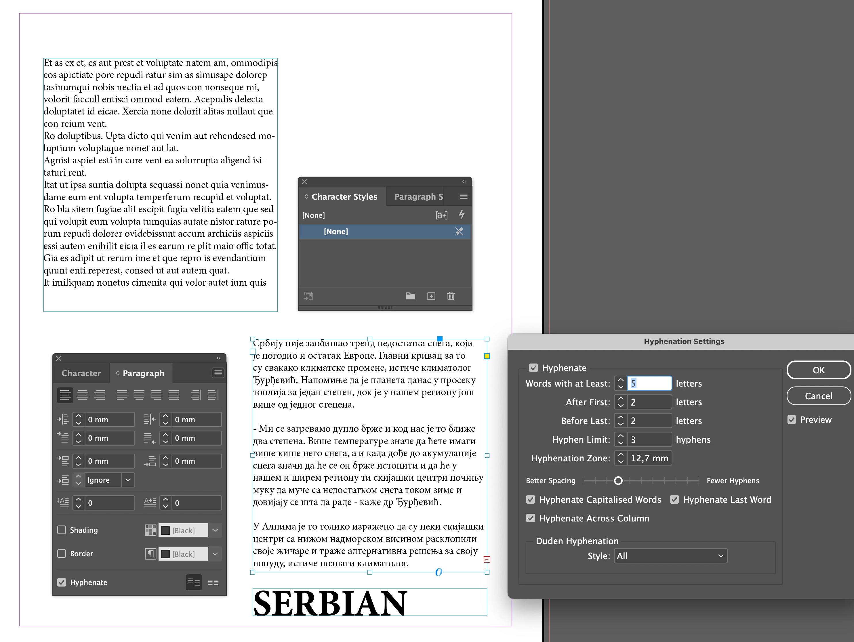

I am reaching out to request assistance with a persistent issue I am experiencing with hyphenation in InDesign, particularly when working with both Cyrillic and Latin scripts in the Serbian language. Despite ensuring that dictionaries are correctly installed and configured, the hyphenation function fails to operate as expected. This issue is not limited to Serbian; I have also encountered problems with English hyphenation. However, when I adjust the settings to use the Proximity method, English hyphenation resumes normal function, an adjustment that, regrettably, does not resolve the issue for Serbian.

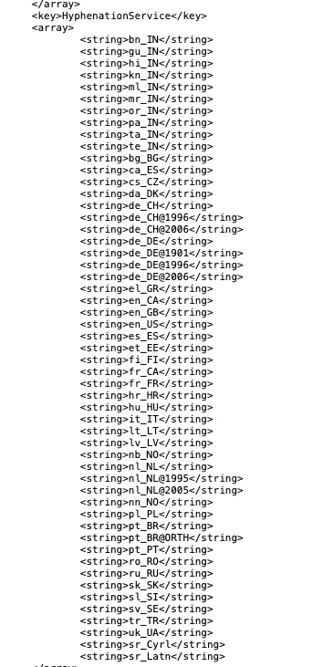

I followed these directions:
https://helpx.adobe.com/indesign/kb/add_cs_dictionaries.html
and I'm guessing you found the correct language and country code?
Is it sr_RS ?
Mike Witherell
Feb 8, 2024 8:28 AM UTC
Thanks Mike,
Exactly the same method I have used to run the language.
Since serbian is using both cyrillic and latin, it is: sr_Cyrl and sr_Latn.

Thank you, Mike, for sharing your experience regarding the addition of an additional language.
I can confirm that the info.plist file is functioning correctly, as it operates without issues on a PC. However, it remains a true ENIGMA why the Mac platform does not support this.

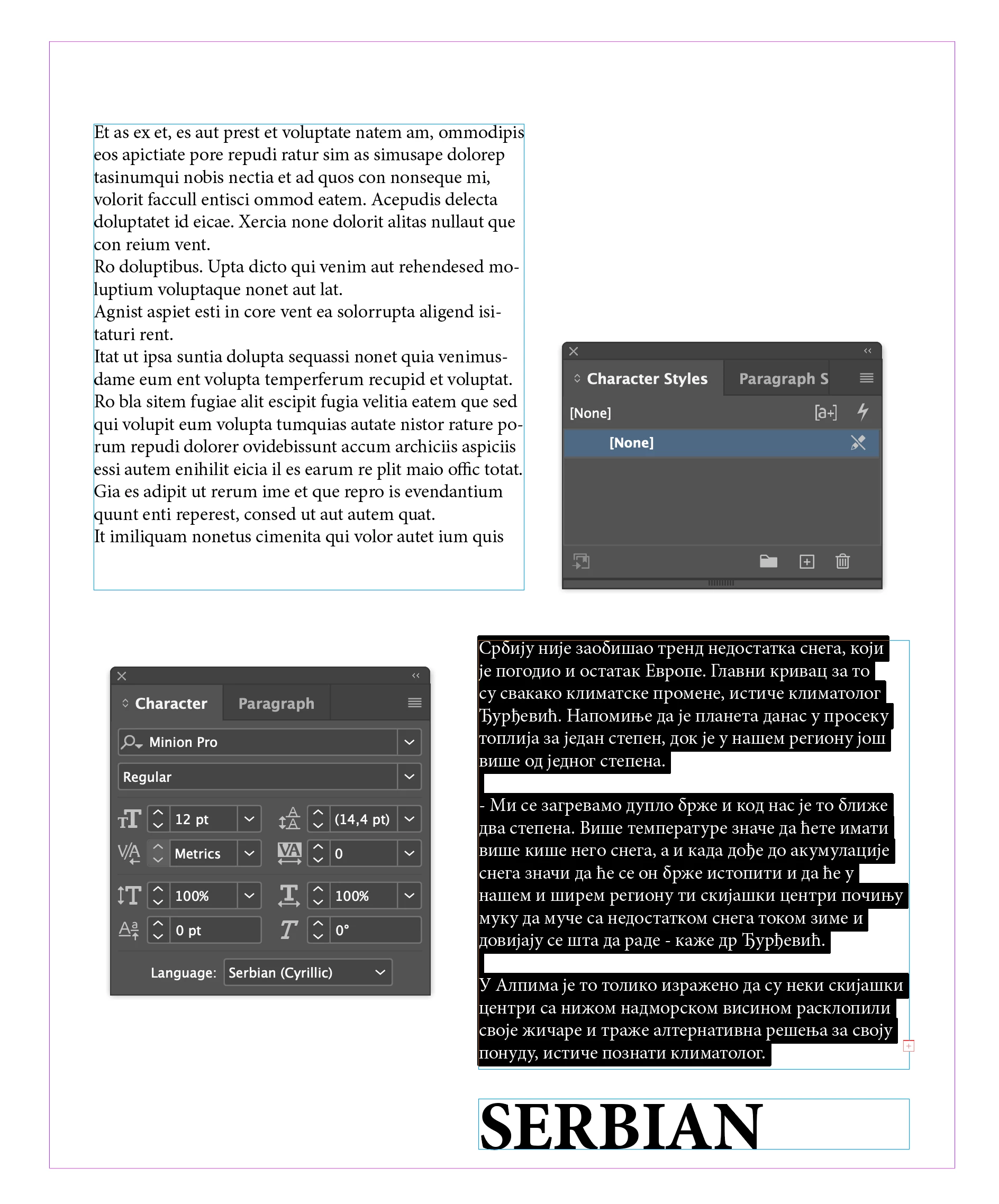

Thank you Mike for your time.
In the example provided, the Serbian language is selected in the Character tab, as illustrated in the screenshots attached.
For example, while working on a book, I ensure to apply Paragraph styles that are set to the Serbian language of course. However, the primary concern is not with the language settings themselves;  it is with the hyphenation feature, which does not function on Mac OS and that is a quite of a problem.
Interestingly, the hyphenation works normally on a PC, while using the exactly same edition of InDesign.
