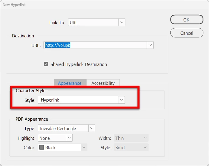

Do you get this dialog box when creating a new hyperlink?
The first time you create a hyperlink InDesign should create a character style for it. The default is blue with a blue underline but you can make it anything you want. Select the text for one of the troublesome hyperlinks and then open the character styles panel.
Is hyperlinks selected? Does it show any overrides?
