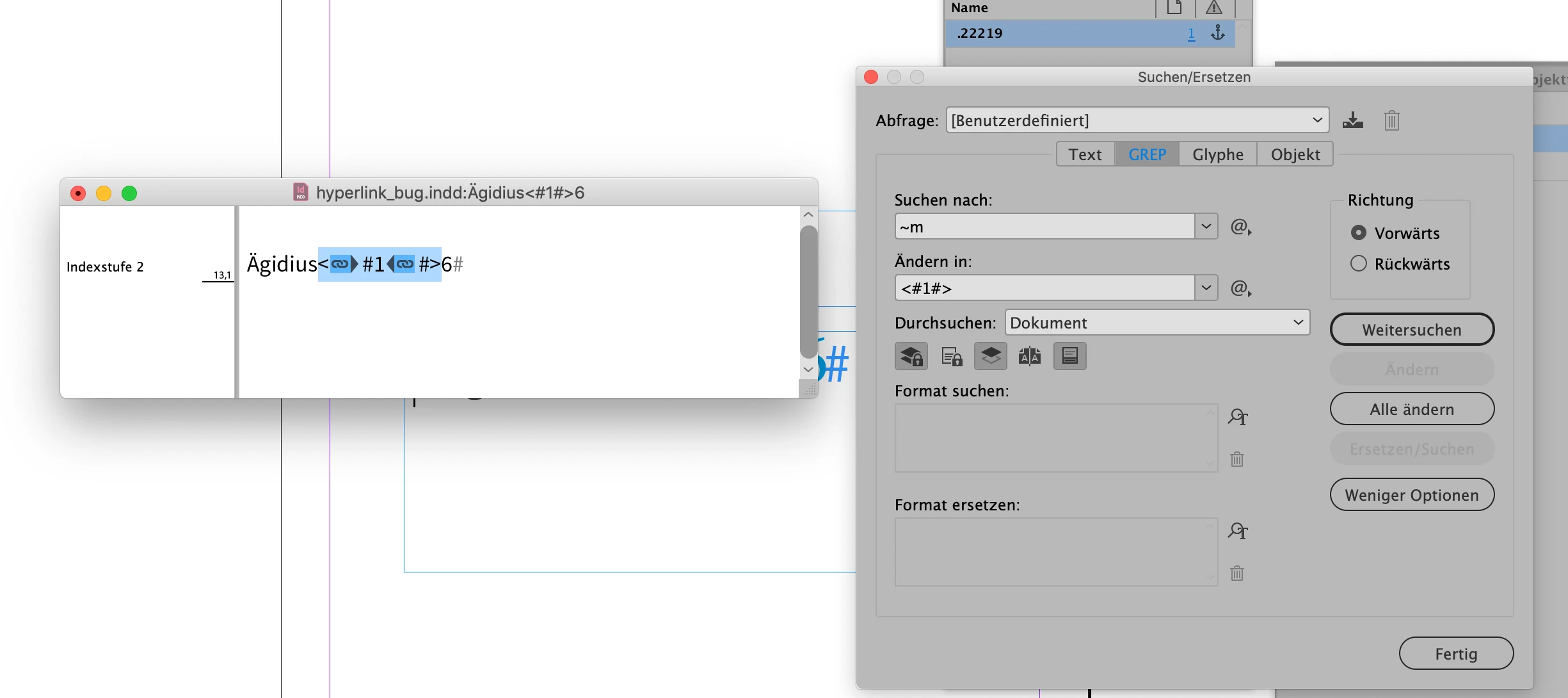

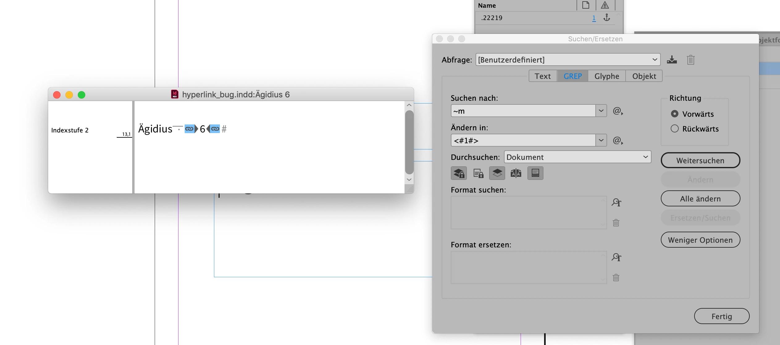

If I replace a character in front of a hyperlink with multiple characters using Find/Change, the hyperlink shifts.
Before:
After:
If only one character is replaced, no shift occurs. Tested with InDesign CS6, 2020 and 2021, MacOS.
Does anyone know a workaround for this?

This is clearly a bug. Did you report it? (https://indesign.uservoice.com)
There is a workaround though, you need InDesign 16.2.1 or later for that. It uses the fact that you can now insert text at an insertion point without making an actual replacement. It works like this. You need two passes:
Find what: (?=~m)
Change to: <#1#>
The Find what expression is just the lookahead, nothing else. The query says 'insert the tag before em-spaces'. The whole text tag stays out of the hyperlink.
Then delete the em-dash in a separate pass.

My customer is still using InDesign 2020. But your idea has put me on the right direction. It also works with:
Find what: ~m
Change to: <#1#>$0
And than remove the em-dash in a second pass.
