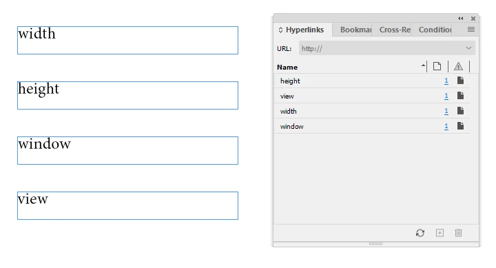

The script creates a new document, places four text frames, adds the name of a zoom setting, and creates a page destination for each setting to the first page and a hyperlink for each setting. That produces this:
Click each hyperlink to check that they work. Then export the document to PDF. In there, you see the same behaviour. Naturally, sometimes height and view are the same (depending on the page size), but width should always show a different view. You can zoom in or out manually and click a link to see that (and howw) it works.
Now in InDesign change the document size to A3 (or bigger) and move the four frames to the centre of the page. Click the hyperlinks again, then export to PDF again and check the behaiour of each link. A bit laborious but it's instructive.

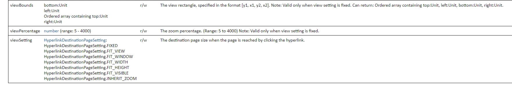

Now change the viewBounds of e.g. the view hyperlink:
app.documents[0].hyperlinkPageDestinations.item('view').
   viewBounds = [100,100,300,300];
And click the iew hyperlink in the Hyperlinks panel. Nothing much happens. Then export to PDF. No difference.
My conclusion would be that the viewBounds property doesn't do anything and if it does, it can't be changed with any visible effect.

Yes! You are right, viewBounds property does not do anything. I am surprised why they given this property.
Also, I find the sample script provided by the Adobe and there is no sample for viewBounds.
