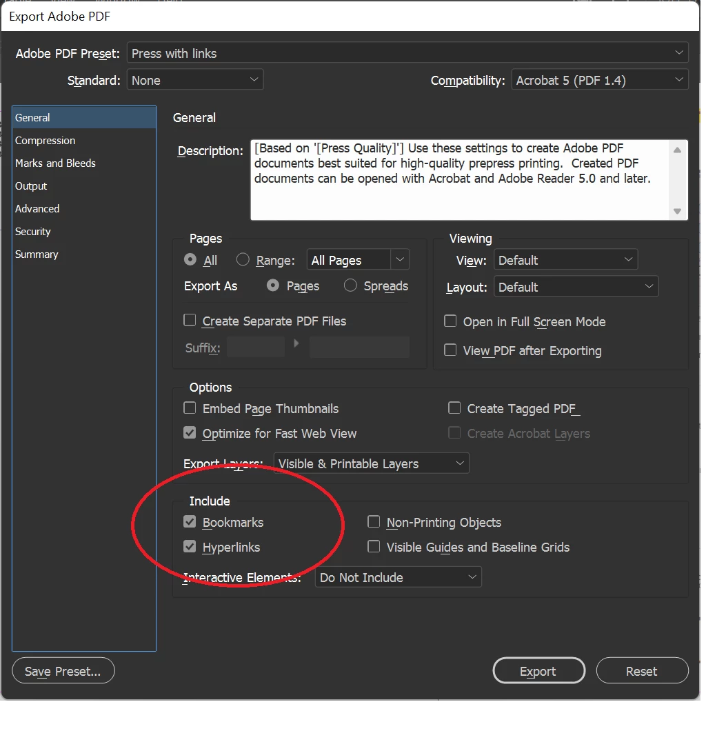

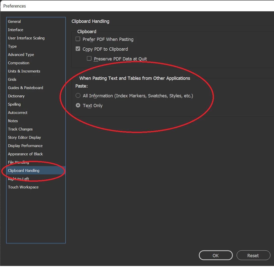

A few other caveats: There's a preference in InDesign for treating the clipboard as either raw text or rich text; if you have it set to raw text, it'll always strip out the hyperlinks.
Also, when exporting PDFs, not all PDF export presets include hyperlinks, so you may have to select a different preset, or manually turn on hyperlink export:

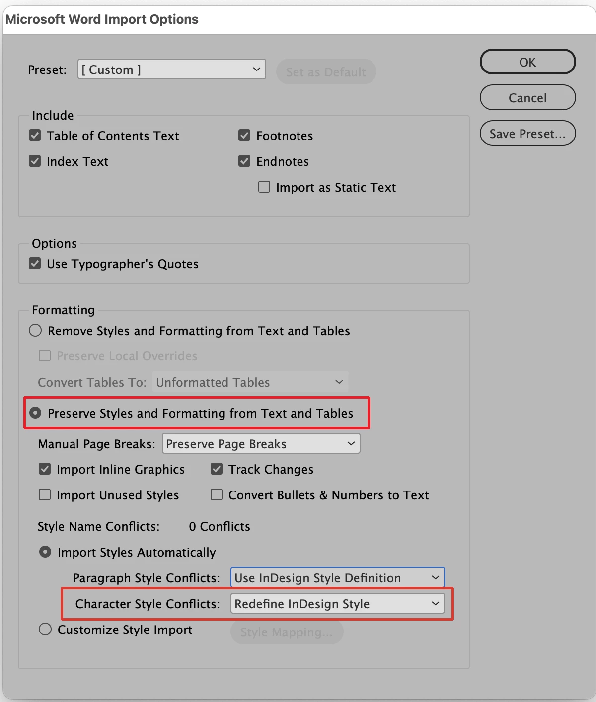

If rather than copying and pasting the text into an active text frame you use File>Place with Import Options checked with an active text frame you will get the Microsoft Word Import Options dialog as shown below. In this dialog you can make sure that all Styles and Formatting from the word document are maintained and if you have used a character style for your hyperlinks in the Word document that it will supercede any character styles with the same name that may exist in the InDesign file (although simply using a different name for the character style in either the Word file or the InDesign file would certainly be much easier).
