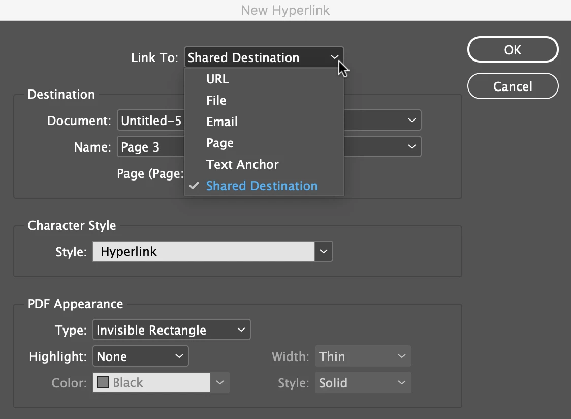

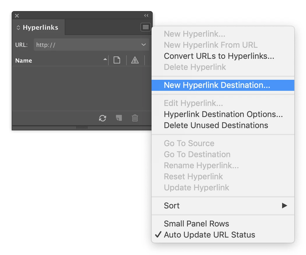

    What about setting up Hyperlink Destinations from the Hyperlinks panel?
    3 types can be created.
    When creating a new hyperlink select Shared Destination from the Link To section

    Things can get a little complicated in InDesign when you are trying to jump to pages in documents that have different flavours of page numbering going on in different sections. The reason I was suggesting Hyperlink Destinations was as a way of bypassing this whole issue altogether while retaining your preferred design.
    Good to hear you've got yourself a solution.
