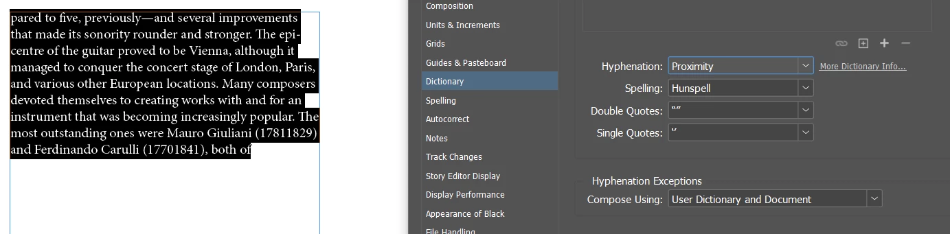

I have my paragraph styles set to English UK, and the hyphenation seems to be wrong in several places.
From other posts found here, I checked that the hyphenation is indeed wrong in ID and that the only solution woud be to manually edit the user's dictionary. But is that so?

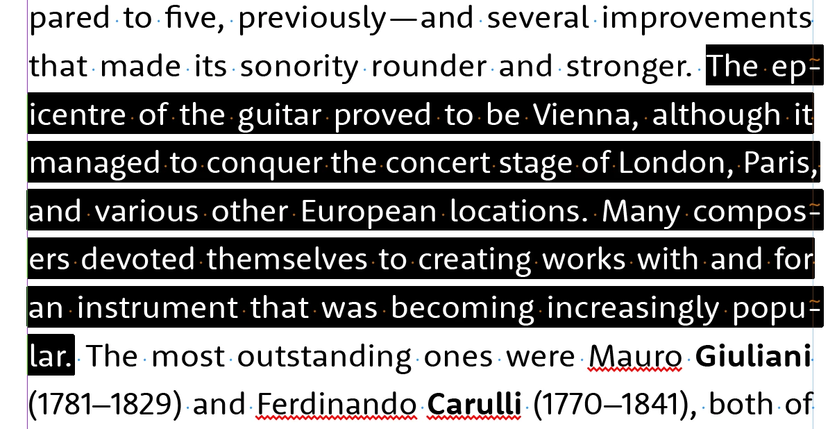

Look at this:
The word "epicentre" should be "epi-cen-tre", which I can get to if I change the hyphenation rules to be after the first 3 letters instead of 2, but is that the solution? The word "composers" should be spelled "com-po-sers" even if the spelling check on one website gives me "com-pos-ers".
What should a user do in general when things like this happen?
What should I do in this particular case?
Thank you
PS: modulation is given as mod-u-la-tion. The Italian word for this is "modulazione", with syllabication mo-du-la-zio-ne. What's wrong with English? 🙂

In your preferences change from Hunspell to Proximity
https://creativepro.com/the-shocking-truth-about-indesigns-spell-check/#:~:text=Proximity%20is%20the%20dictionary%20default,such%20as%20volts%20and%20watts.
Check out the comments in this too
Hope that helps

I see that the Hunspell deals better with numbers contained in words, but what is causing it to spell those words differently? Is this an update to the English language itself? Or is Hunspell wrong and Proximity good? Can one use a dictionary just for a specific paragraph, for example?
May 5, 2024
I don't think you can. Best to adjust the hyphenation to be 3 letters l, always felt it was awkward with 2.
Even better just turn off hyphenation, it's awful, but you can put discretionary hyphens in words so it will break at point if you wanted
