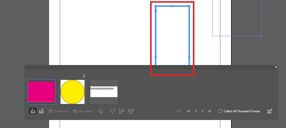

I am baffled by the "content collector."
I've read the documenation here, which is pitifully inadequate to say the least. It also presents not one but two bad links that are supposed to take you to info about the Links panel or menu.
Opening this "tool" reveals a panel with a bunch of thumbnails on it. I may have loaded the "conveyor" with all items from a document in my first experiment with it. Clicking on the thumbnails on this conveyor does nothing. Selecting an item on a page and attempting to "load" the conveyor from the selection does nothing. There's no apparent way to remove stuff from the conveyor.
There does not appear to be any way to name any of the items in this thing. So, for example, if you have two reusable elements that are visually similar, there's no way to tell which one you're looking at in this row of dinky images.
There's no explanation of the numeral that appears on some thumbnails.
Switching to "content placer" and clicking on the page dumps a huge load of text that is apparently one of the items on the conveyor, but it doesn't resemble any of the thumbnails and there's no way to choose what gets dumped.
How is this thing useful?

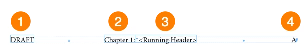

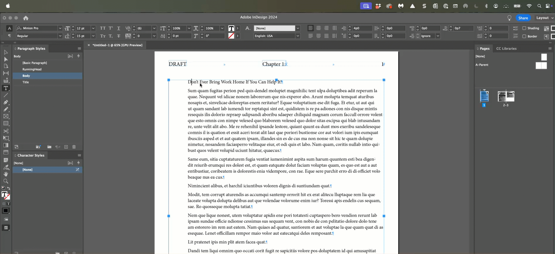

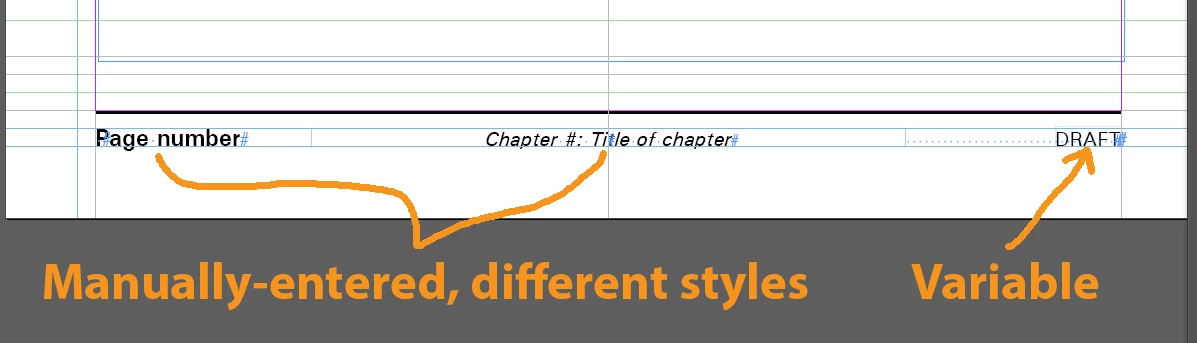

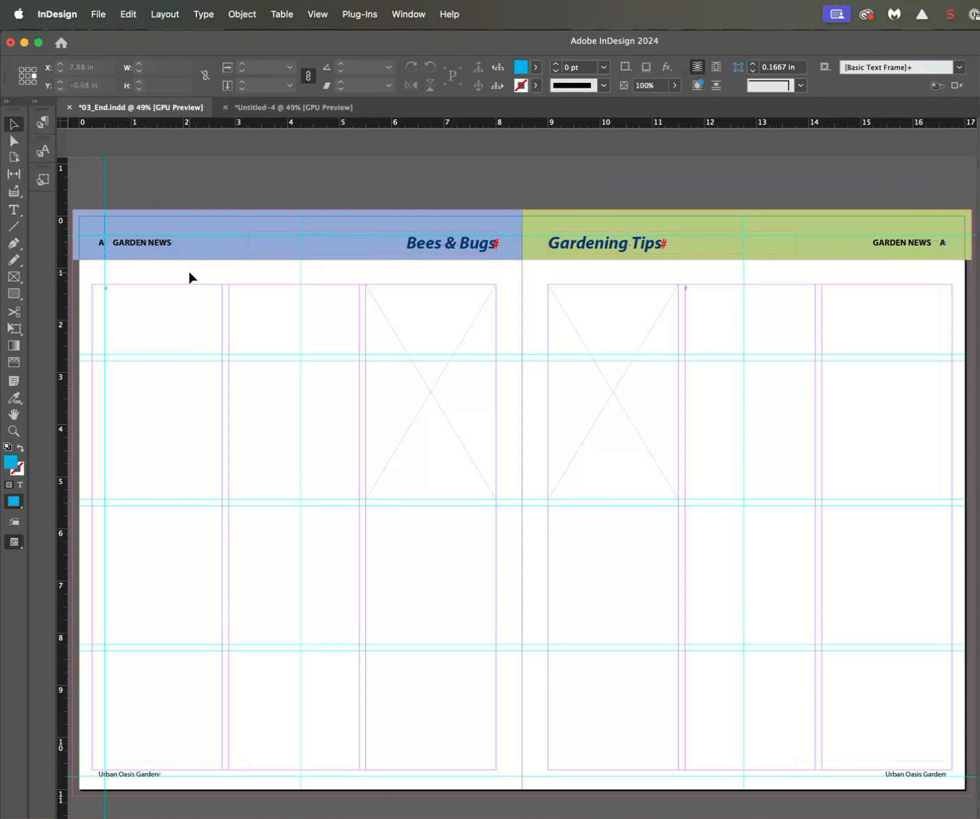

Apr 10, 2025 2:40 AM UTC
Hi Mobius/Thomas:
Yes, you can add text before and after a variable. But looking at your example, I'm not clear where you would add the extra text. I'd do everything with variables and with tabs not tables—not that tables are wrong—I would just set tab stops because I'm comfortable with them and to me, they are less fussy that tables.
Here's an example parent page set-up. There are three variables and one marker:
  1. DRAFT is a Custom Text variable defined as "DRAFT".
  2. Chapter 1 is a Chapter Number variable with the word chapter in front and the colon after.
  3. Running Header is Running Header <Paragraph Style> variable defined to call in text assigned the Title paragraph style
  4. A is the Current Page Number Marker.
In a table or using tabs, this is all automatic. The only thing to be aware of is that the chapter number variable only increments if you're using a book—this means that each InDesign chapter (.indd file) needs to be a single .indd file and then we pull them all together into an .indd book file.
What I find difficult about answering questions on the forums is we don't know what you know. This might all be completely familiar to you and you're rolling your eyes because you knew all this or maybe you didn't realize how extensive variables can be.
If you have additional questions you know you can just ask us. We are always happy to help.
~Barb

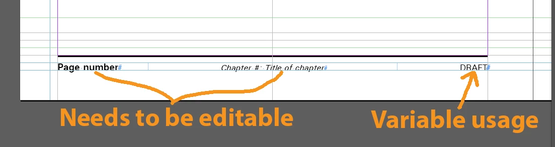

Apr 10, 2025 8:21 PM UTC
That's awesome, Barb! It's an unusual situation. As for my background, I did a huge amount of automation in Word using WordBasic back in the day, and wrote a whole manual in FrameMaker after that... doing everything with styles and variables and very little (if any) ad-hoc slop. As far as I could tell, it was all done the "right" and most resilient way.
Right now I'm in a situation where we have large manuals to which we publish updates, but only the pages (front and back) that contain changed information. That's why, in the footer, only the name of the revision makes sense as a document variable. Nothing else in the footer is predictable from one page to the next, because one updated page might be chapter 3, pages 7 & 8; and the next page after that is chapter 7, pages 13 & 14. That's why all that stuff has to be hand-enterable directly on the page: Using variables for those would make no sense, because you'd have at least half as many variables as pages.
I agree about the tabs. I inherited documents where the author was new and resorted to tables to make the layout work; I was going to switch to tabs, but then realized that this prevents me from pre-assigning a style to each of the three text areas above.
So for the footer I'll likely put the revision-name field in the corner on the master pages and then... I wanted to put placeholder text in the footer area for future writers who use the same master pages, so they know where to put the page number and chapter name from the original manual. But I guess that's not really needed; we have guidelines around the footer area.
Unless you have some better ideas!
Robert at ID-Tasker
Apr 10, 2025 8:31 PM UTC
@Thomas_Calvin
Why can't you use automatic PageNumber and contents of the appropriate ParaStyle / CharStyle - for Chapter's name?

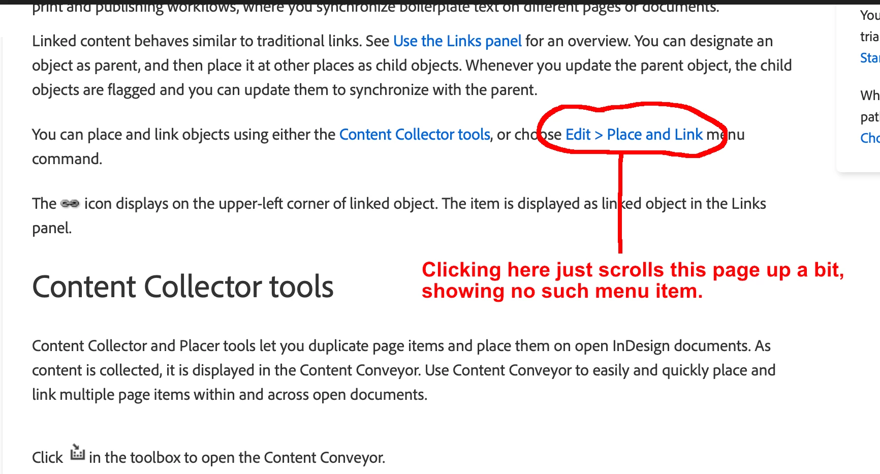

Barb Binder
Apr 7, 2025 1:53 AM UTC
BTW, @Mobius Strip —I went to report the broken links you mentioned but only found the one on Using the Links panel. We would like to get these fixed but I'm not seeing a second one. Can let me know where it is?
Thanks in advance,
~Barb
Apr 7, 2025 7:11 AM UTC
Thanks for following up to fix that! Here's a screen shot.

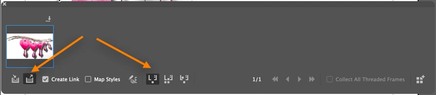

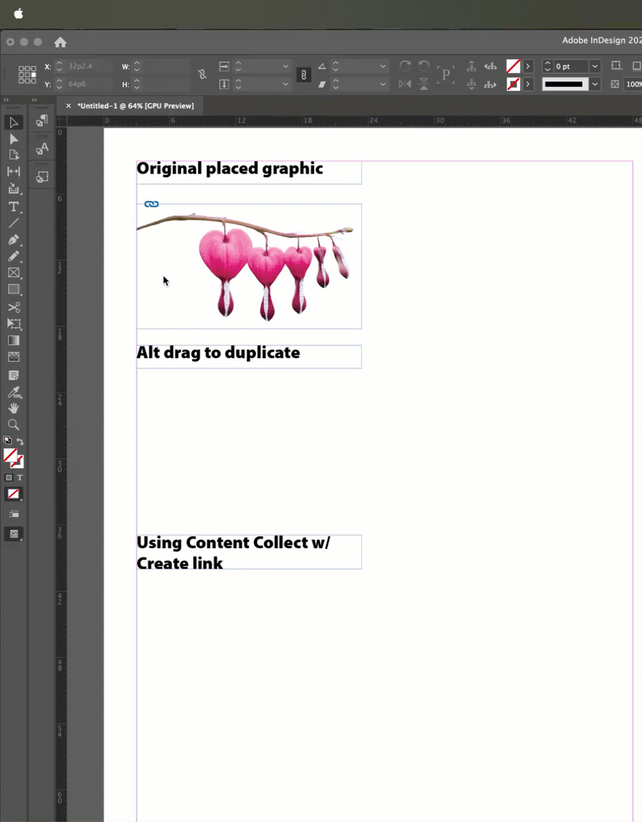

Apr 7, 2025 1:21 AM UTC
Hi @Mobius Strip:
I'll share an example of how this can be used below.
Before I start, please note that the Content Collector tool (it's also available as Edit > Place and Link) was introduced along with Alternate Layouts and Liquid Layouts for use in a DPS (Digital Publishing Solution) workflow, which was briefly included with InDesign before being removed and made available as only at the enterprise level. These three tools remained  within InDesign and while some people use them to create ads in various sizes, most people never use the Content Collector, Liquid Layout or Alternate Layouts.
We have image size limitations here so my little video is going to go by quickly. You might have to watch it a few times for it to make sense. I place the bleeding heart image at the top. The second occurrence is duplicated by Alt/Opt dragging so these two are not linked together. The third one is added with the Content Collector tool and I'll link it to the original.
There are two basket buttons in the lower left of the conveyor belt: the first one shows the arrow pointing in (add image to the conveyor belt) and the second shows the arrow pointing out (add image from the conveyor belt to the page). I add the top image to the conveyor belt, then click the 2nd icon to get ready to remove it. I enable Create Link and choose Remove From Conveyor to the right of Map Styles. When I place the image, it is removed from the conveyor belt. Also, check the Layers panel—the linked image looks a bit different.
Finally, I add a drop shadow to the original image. You will see the blue link on the last image change to an alert to tell me that the original was modified. Clicking it will update it. And this is the point of Create Link: you can place an image multiple times, but have all occurrences tied back to the parent item, so changing the parent item can update the others too.
Finally, to remove your images from your conveyor belt, click the two buttons I'm pointing at below and click on the pasteboard to place each one. Once off the belt, you can just remove them from the page.
~Barb

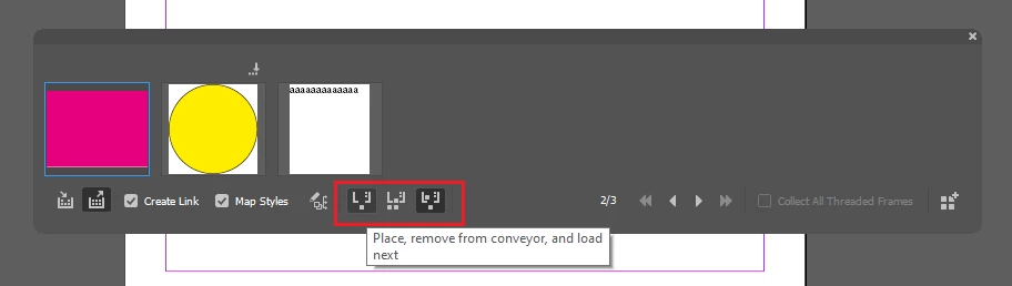

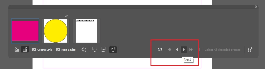

Apr 6, 2025 1:55 AM UTC
First two icons - you can switch between LOADING and UNLOADING - or you can press "B":
When you're in LOADING - object over which you'll hover your cursor - will be "highlighted"
To switch between active item:
Hover over those three - and you'll get tooltip what they are doing:
Apr 6, 2025 5:44 PM UTC
Thanks for the reply. I never see highlights in my conveyor. Also, the transport-style controls are always greyed out.
I have examined all the ToolTips, but the ones that exist don't answer the questions. For example, how do you remove stuff from the conveyor? Not "place and remove," just remove.
And there are still the unexplained numerals, and the fact that there's no way to name anything in this collection... so you can't find what you want to place.
Dave Creamer of IDEAS
Apr 6, 2025 11:29 PM UTC
To remove an item, make sure it is active in the conveyor and hit the Escape key.
