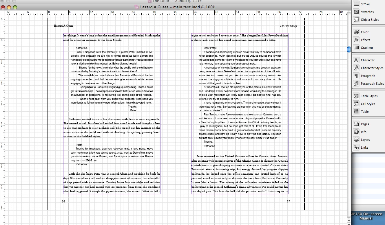

    A screen shot might help.

    I knew I would give it a day or two to see if anyone could help, so yesterday I went through all approx. 300 pages. Those spreads that are only 'main body text' or spreads that contain elements that I can set leading to match the 'main body text' (15pt.) were fine. I went ahead and hand-set the 'space before' in the paragraph palette on any spreads where I needed to adjust the last line to the bottom margin baseline across the spread.
    The screen shot below shows a spread where I think I used this method. Baseline grid was turned off.
    As I said, with all the various fonts, sizes etc. I was not sure if there was a way to automatically have the last line always align across the spread, rather than to do it by hand - where I am still not sure if the lines align perfectly.

    The screenshot you have posted shows the document grid, not the baseline grid.
