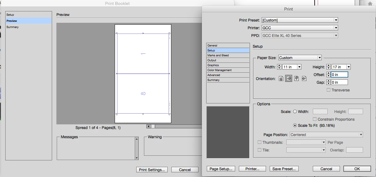

    That should work. The Print Booklet feature is famous for not working well with some print drivers. Can you show a screen capture of the Print Booklet dialog set to Preview with Print Settings open like in my #1?
    You could also try exporting a PDF using the PDF/X-4 preset and trying Acrobat's Booklet printing.

    Make sure Scale to Fit is not checked under Print Settings...>Setup>Options. Here my letter spreads with crops won't fit on a tabloid sheet, so with Scale To Fit checked it gets reduced:
