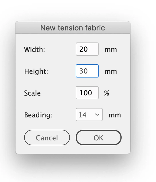

While your dialog is displayed InDesign can't do anything. Change the dialog to a palette-type window (like an InDesign panel) and the script can continue to create a document. In this line:
var dialog = new Window("dialog", "New tension fabric");
Change 'dialog' to 'palette'.
That's the easy solution. It would have been more appropriate to collect all the values you need, close the dialog, then create the new document. As it is now, creating the document is part of the interface, which will cause all kinds of logistical problems. (Still amazing what ChatGPT comes up with.)

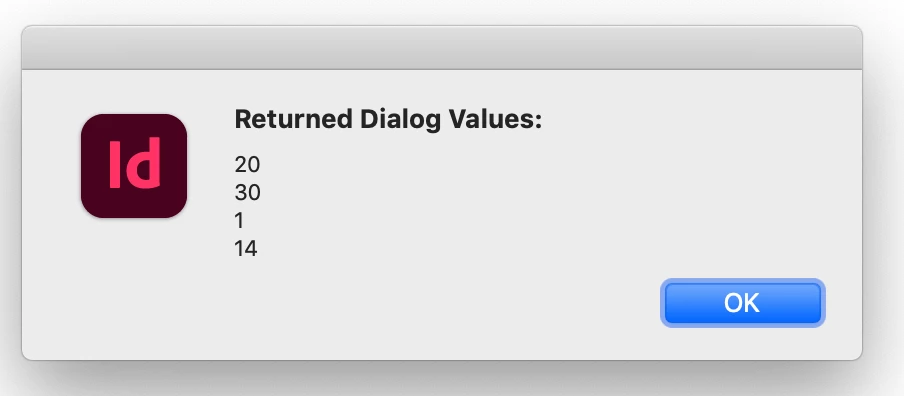

Hi @kylep77360271 , Also, the part of the ChatGPT script that constructs the document is going to throw a bunch of errors—page.bounds are read only so you can’t change them, you would have to transform the page. Pages also don’t have bleed or slug properties, so all of those lines are going to throw an error (bleed and slug are document properties).
Here’s an example of capturing the dialog values, where I’ve declared the variables in the first line and the given them the values in the onClick function, then display them in an alert after the dialog closes:

    alert("Returned Dialog Values: \r" + width + "\r" + height +"\r"+scale + "\r"+selectedBeading)
