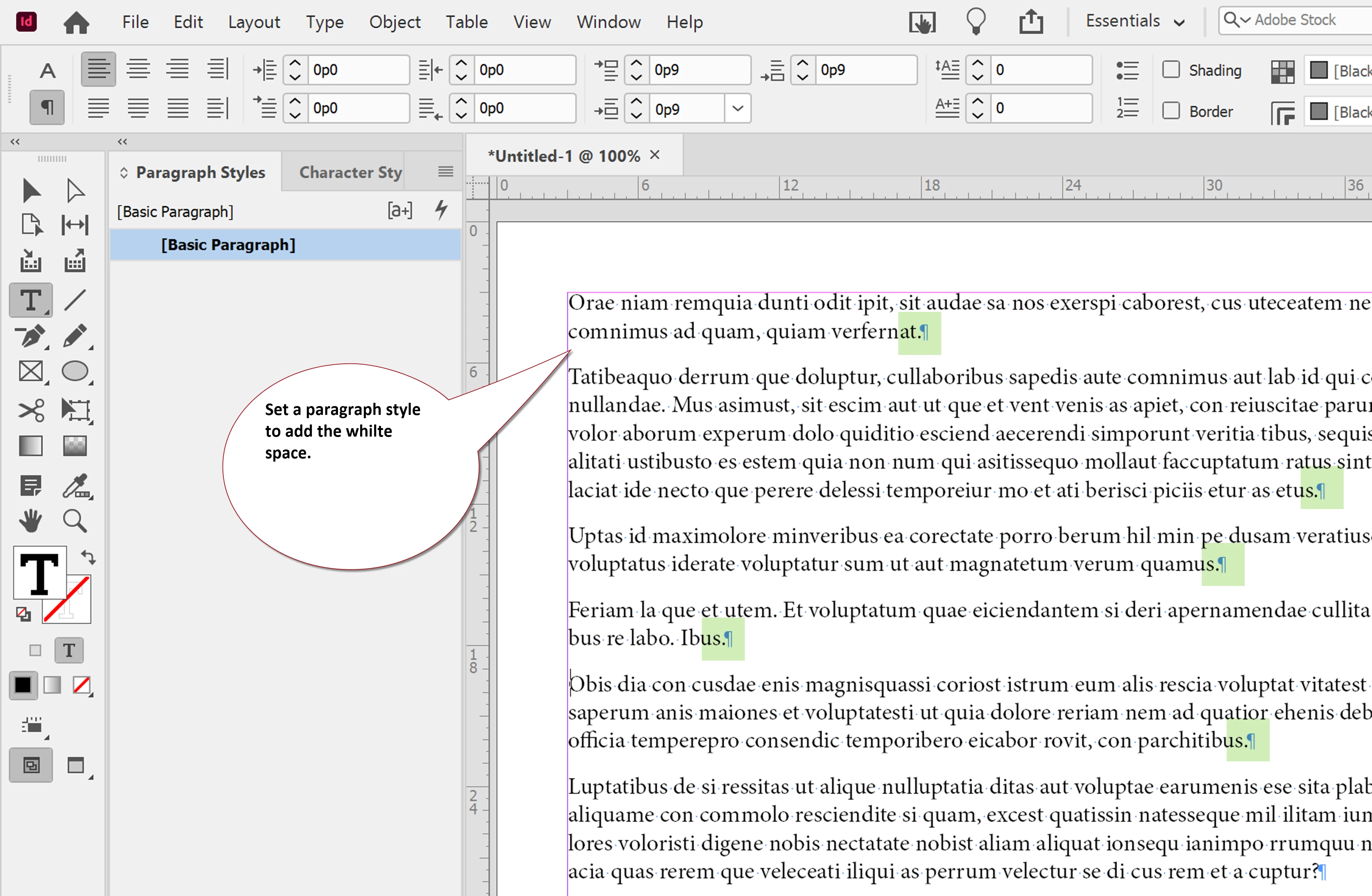

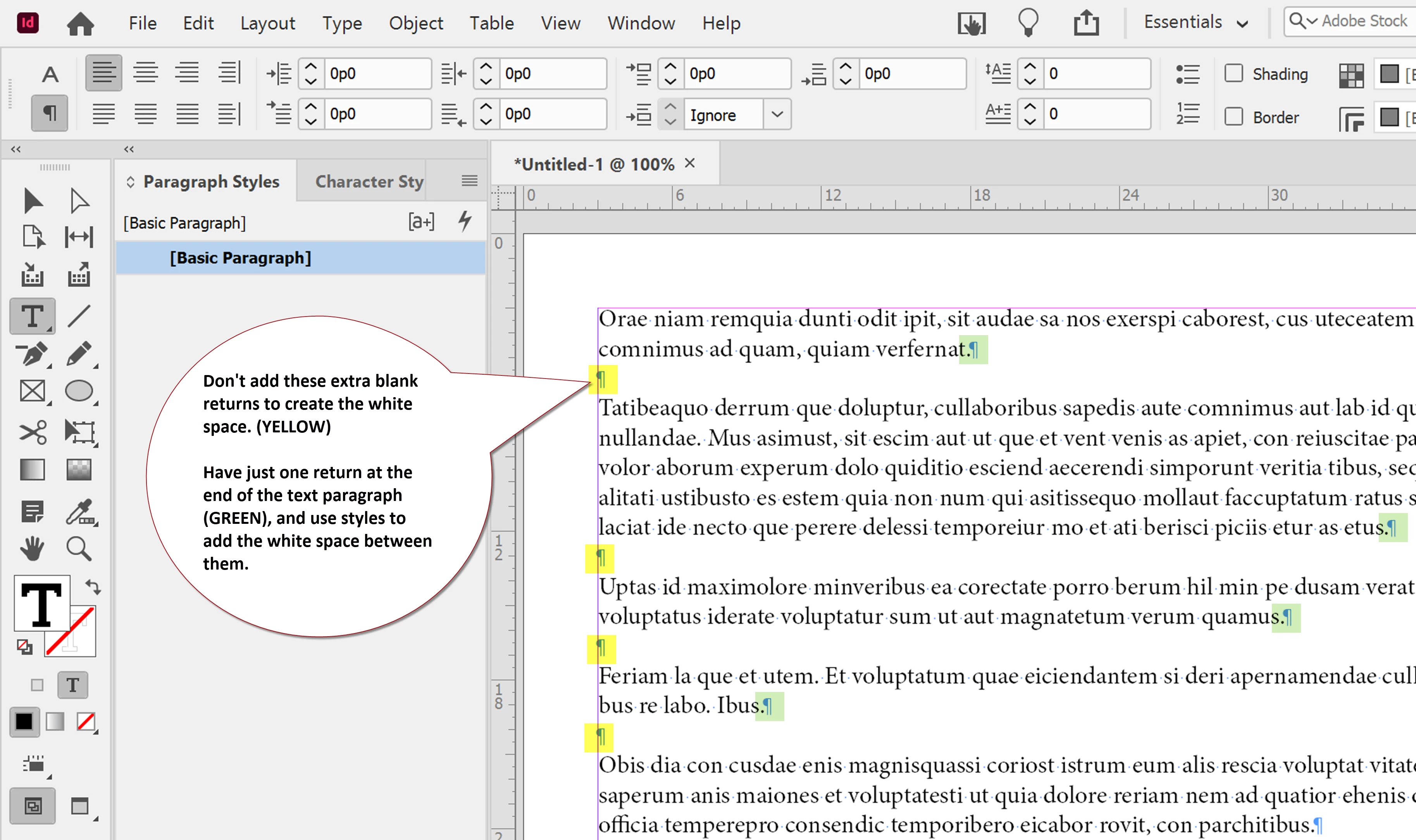

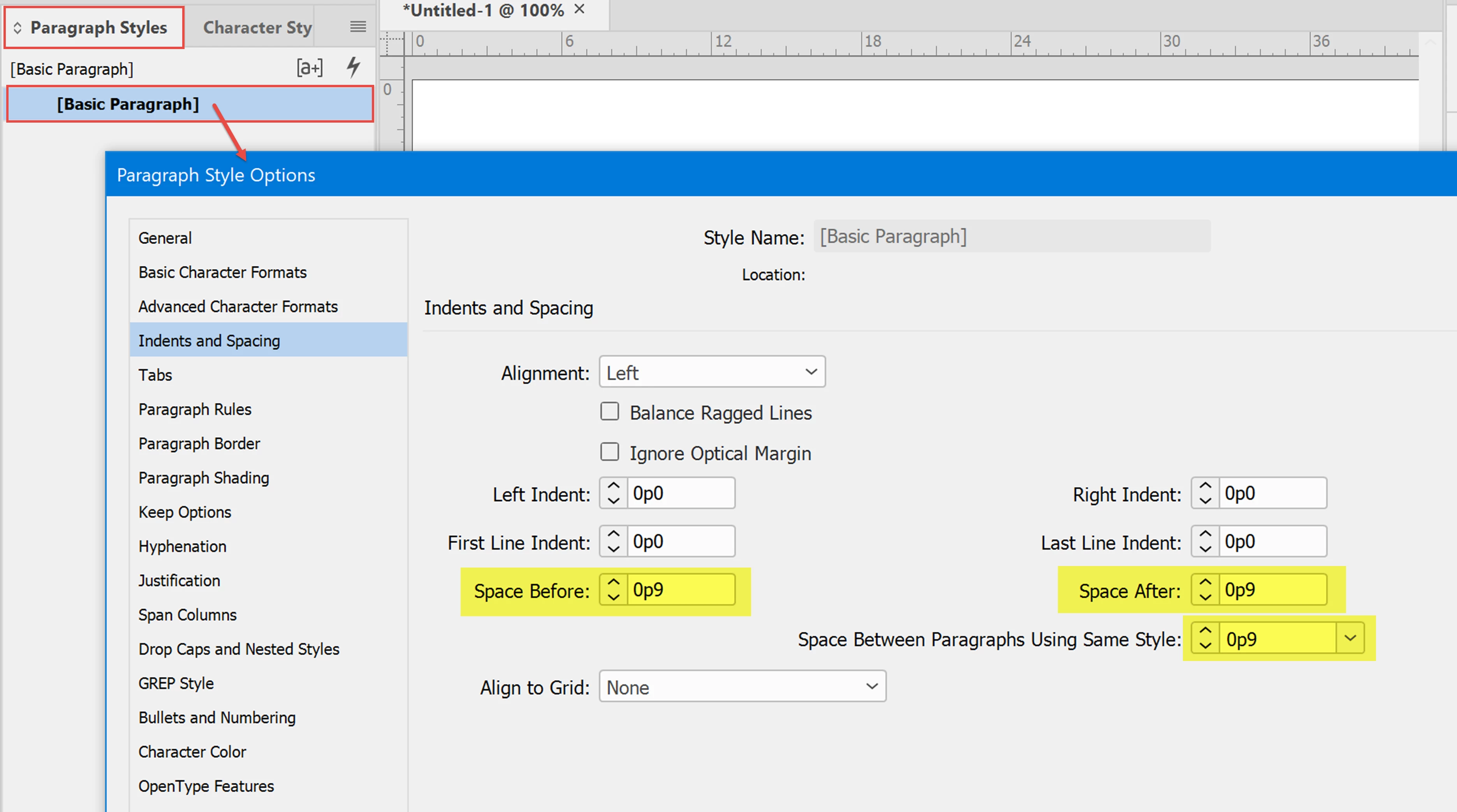

May 22, 2023
It's called a Hard Return or Carriage Return and you insert one by using the ENTER or RETURN key on your keyboard.
Yes, just like you're in word processing, it ends one paragraph and begins a new paragraph.
To get white space in between the paragraphs, use HTML/EPUB CSS styles (or an InDesign style that will convert to a CSS style) that programs in white space before an/or after the paragraphs (those things with the Hard Returns).
Dont do this!
Do This Instead!
In the above screen capture, there is only ONE hard return, at the end of each paragraph of text.
Edit the Basic Paragraph style or other body text style to add white space above/after the paragraphs.
