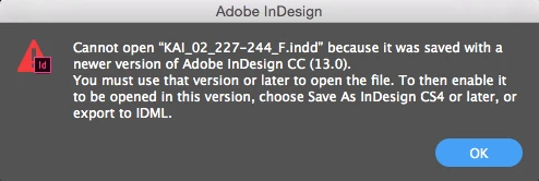

I'm having some issues opening some files from a shared network that all my coworkers have access to, and I seem to be the only person having trouble with these files. I get an error message claiming that the files were created with a newer version of Indesign (despite the fact that I have the current version, and these files were probably made with either an older version or the current one.) They'll appear either of these two ways.

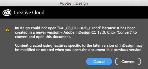

For a while it gave me an option to convert the files and that worked fine for a while, so I shrugged it off. Now I'm getting an error message saying that the conversion services aren't available. I am logged into creative cloud. Trying again later changes nothing. These files are now completely inaccessible to me.

Compare the numbers. The message says 13.something and you say you're running 12.something.

I'm running Indesign CC 2017, recently updated to build 12.1.0.56 on OSXYosemite 10.10.5.
CC 2017 is not the most recent version—2018 (currently 13.0.1.207) was released a month or so ago. It will not run on Yosemite, which is probably the reason you are not seeing it available for download in your CC app.

All evidence is to the contrary. Those file were created in CC2018.
Upgrade using the CC Desktop app. It's labeled InDesign CC. There's no year designation.
Your computer must meet the system requirements. On Mac that means OSX 10.11 at a minimum.
