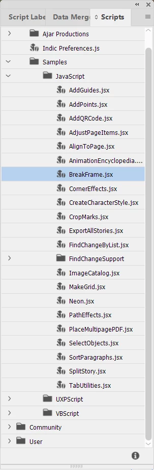

    Seems like normal behavior. There is a sample script that is installed with InDesign called break frame. Use that.
    Select the frame and double click it the script to run it.
    February 22, 2026
    Thanks. That’s how I broke the frames in the document in the first place. But you shouldn’t have to run a script to disconnect panes. If that’s true, the document is what, permanently ruined from the standpoint of InDesign by itself?
