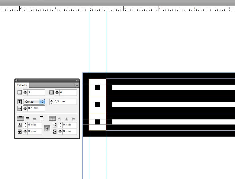

May 13, 2014
If the cell's insets are all set to 0, I have no problem with Jongware's code.
But this was InDesign CS5.5.
With CS6 v8.0.2 there will be an error!
app.selection[0].cells.everyItem().width = "0.5 mm"; //ERROR in CS6, will work in CS5.5
Or will fail silently for the setting a value for width , if more than one property, the width, is applied over:
app.selection[0].cells.everyItem().properties = {autoGrow:false, width:"0.5 mm", height:"0.5 mm"};
InDesign CS5.5 screenshot:
I think we have a bug here…
Uwe
