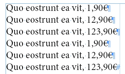

I need with a Find/replace script code to remove prices
  • September 17, 2012
  • 1788 views
I need to know what code i can use to completely remove all the prices in a catalog (they're at the end of a line, so the format is ", 12,90€"). Using the find/replace function seems to be the best?
I tried inserting a string of wildcards but nothing I tried seemed to work...
Thank you very much!

September 17, 2012
Given this example,
you can do it like so:
Which means find comma + space + one/two/three digits + comma + two digits + euro sign at the end of line and replace it with nothing (leave "Change to" field empty).
September 17, 2012
Yeah! Great, thanks!
