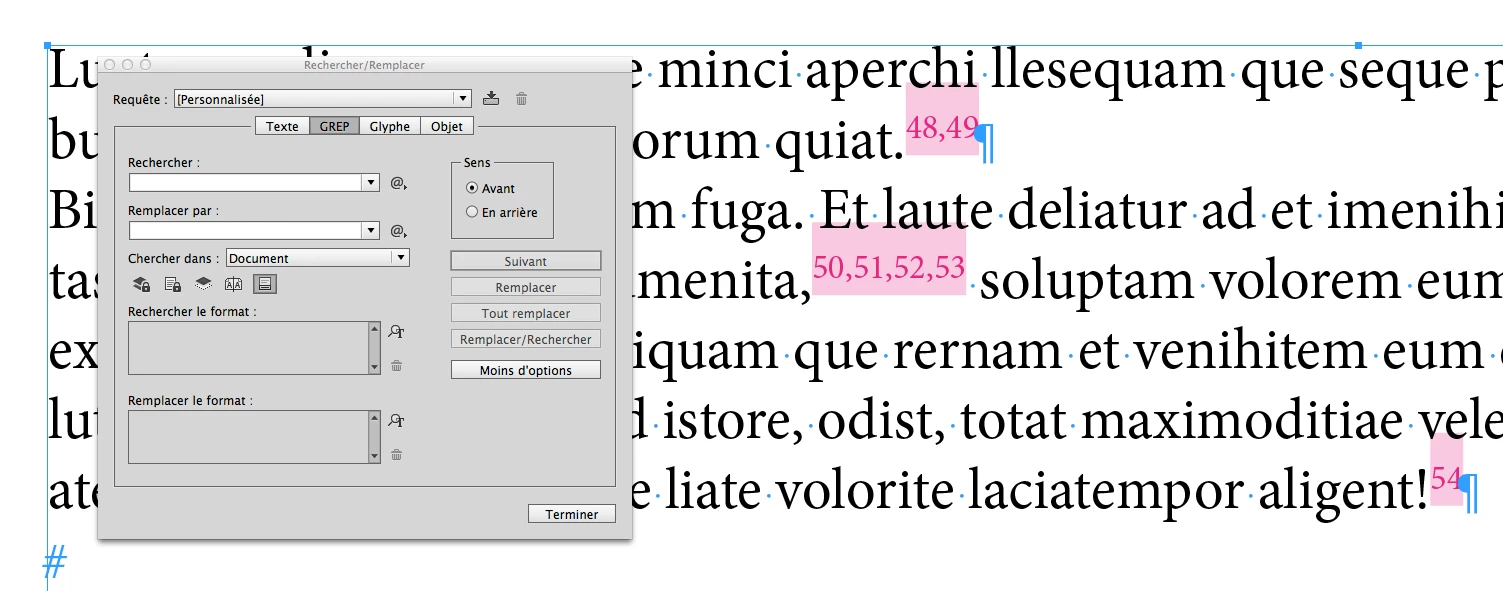

I want to put the period before my superscript footnote numbers. How? GREP?
  • October 16, 2017
  • 2724 views
In my document all superscript footnote numbers at the end of a sentence have the period follow the footnote number instead of preceding it.
The footnote numbers all have a character style.
How can I change the position of the period to BEFORE the superscript numbers?
THANKS!

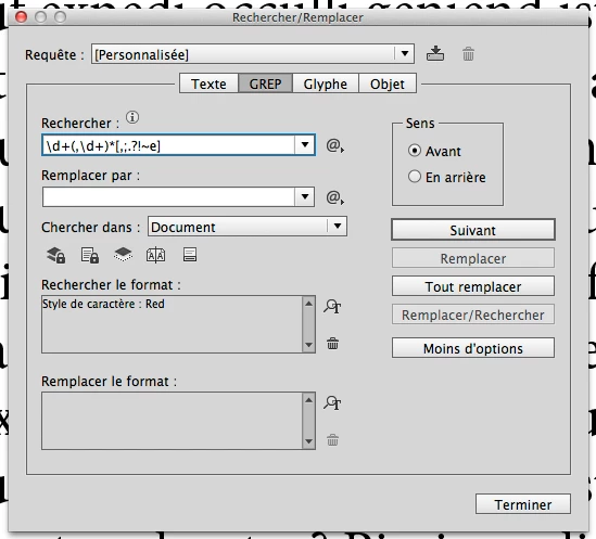

Obi-wan Kenobi
November 10, 2017
Surely not with a simple Grep code!
~F(,~F)*[,;.?!…]    if you play with "true" footnote calls!
\d+(,\d+)*[,;.?!…]    if you play with "false" note calls!
In the first case, don't try! … To play it, you'll need a script!
In the second one, euh! … Well! you'll need the same script! [more simple to explain!  ]
Of course, in the 2 cases, just enter the first or second Grep code into the first form ["Find:"] of the Find/Replace InDesign window …
… and just 1 click for launching the script!
Done!
