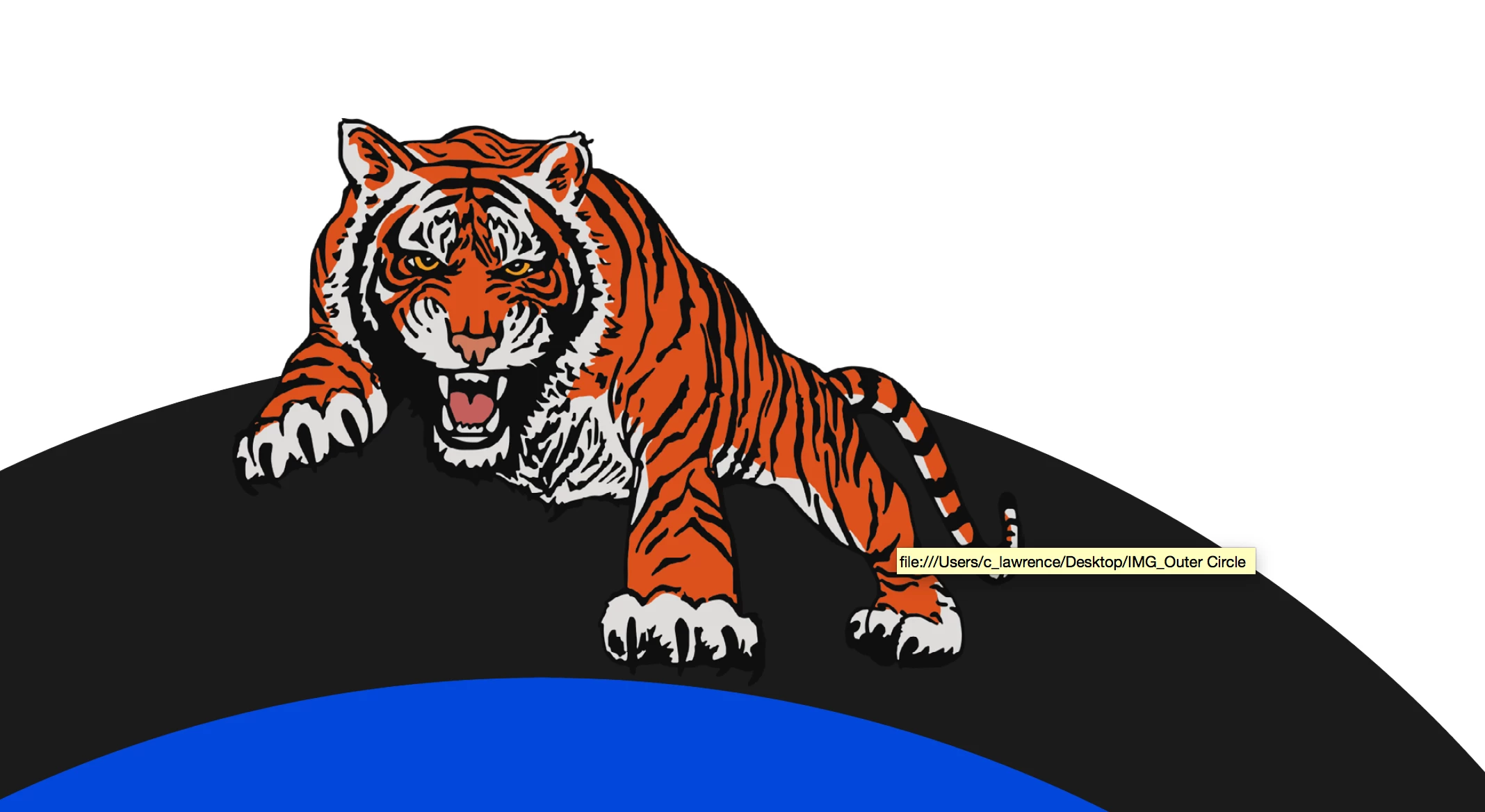

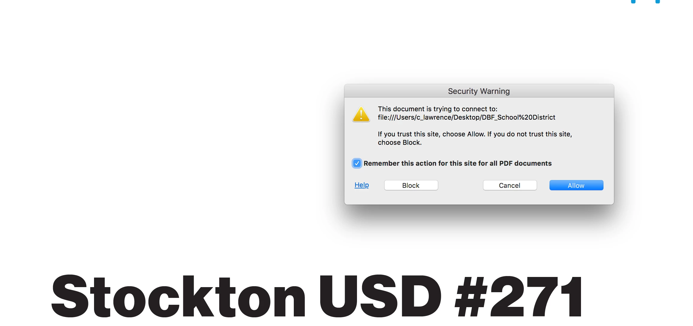

We are using ID 2019 and the data merge function to create unique pdfs but are running into an odd problem. When you create then view the interactive pdf all of the frames that have data merge contents inside are clickable and attempt to redirect you to the origin path of the document (determined by the CSV from data merge). If i hover over the text/image frames from the data merge it will also show the path as well and the cursor will change to the "clickable" pointer. I have no idea what could be causing this issue. if we export the ID file as a print ready pdf there are 0 complications with the document.
Attached is a screenshot of what occurs when i click on the text/image frames

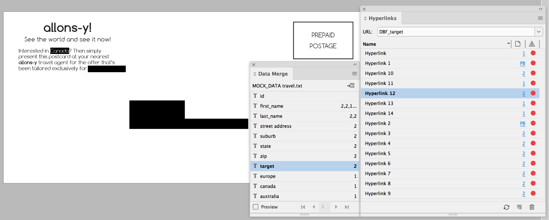

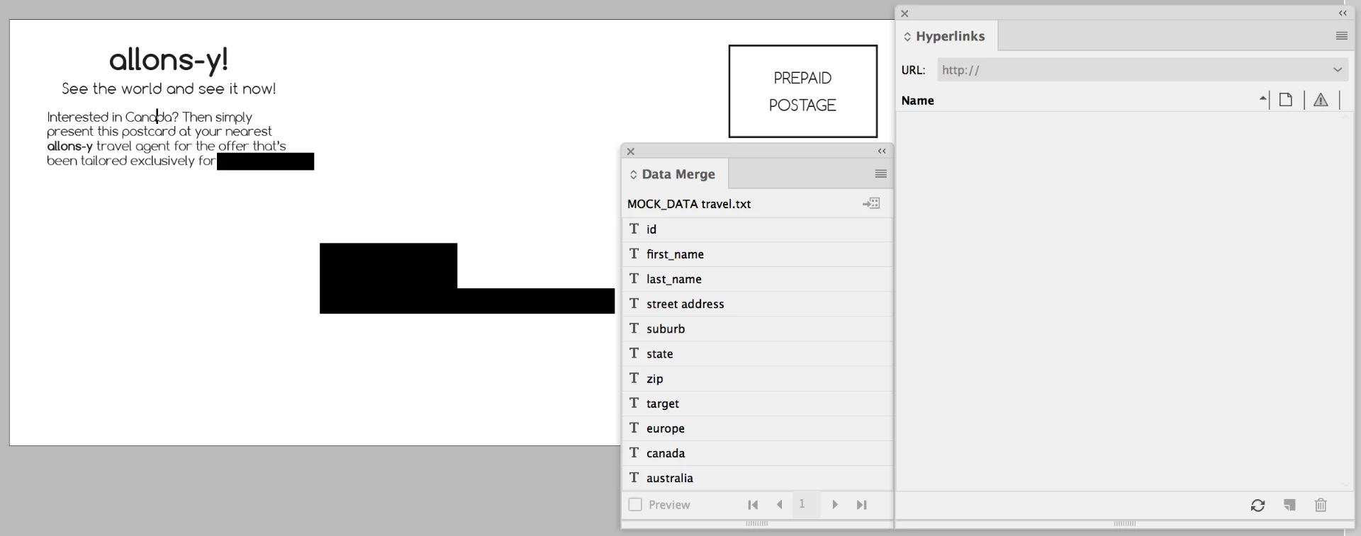

My suspicion is it is a "behaviour" of how data merge works. I say this because during a data merge, the merge fields that are in use can be found in the hyperlinks panel:
While the data in this demo is completely fake and generated at mockaroo.com, I've redacted it for the sake of complying with forum guidelines (no doxxing)
If the hyperlinks are deleted, then the field is no longer a data merge field, and the data merge panel behaves as if no data has been added to the document yet.
If I undo this and have the hyperlinks again, there's no way from the hyperlinks panel to stop the hyperlinks from being clicked on... and that makes sense because the usual purpose of a hyperlink is to be clicked on.

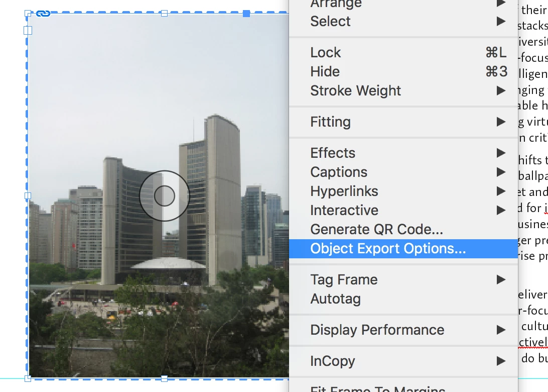

However, see if this helps. Using Bridge, edit the IPTC metadata of the Description of the images used in the data merge to read "test".
Back in InDesign, go to the variable image field and click on it with the right mouse button to call up the contextual menu and select Object Export Options.
From here, go to the tagged PDF tab and change the dialog box to the following:

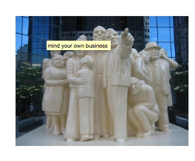

Export the interactive PDF as you have done, and run the action that you made that strips out links. What happens in this instance?
On my screen, the tooltip and the URL "duke it out" to see what should appear, UNTIL I run the action that strips out the links, then only the tooltip I made in the description panel of bridge appears.

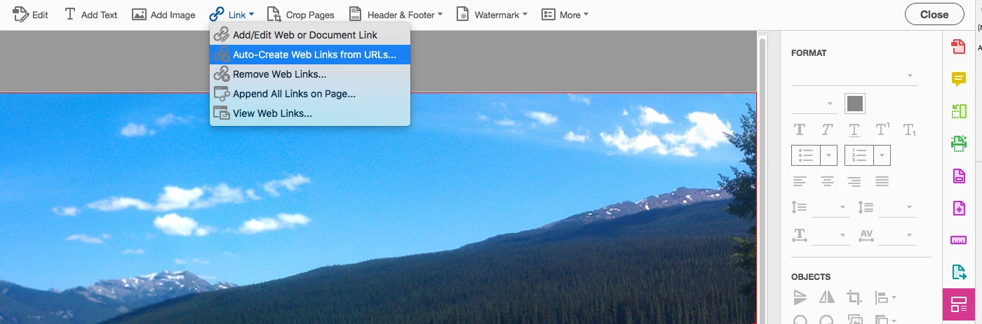

One workaround - that unfortunately also removes other useful and intentional hyperlinks in the document (such as real URLs, navigation buttons, footnotes etc) would be in the PDF itself - make an action that removes all links in the document (see this forum on such an action: Batch sequence to 'Remove all Links' ) and then rebuild the links from URL automatically from the following menu item:
