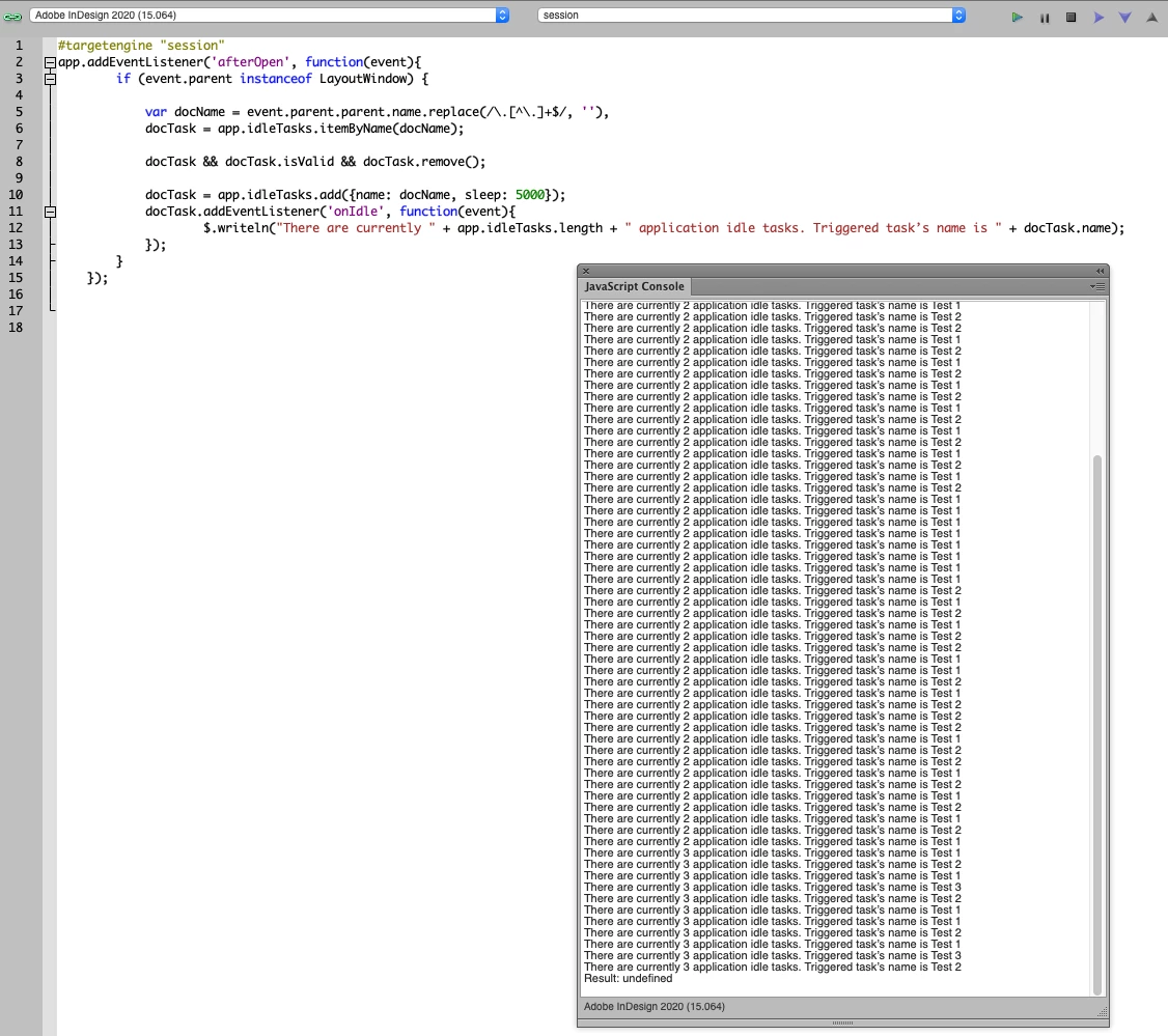

rob day
April 24, 2021
It looks like the alerts interfere with themselves, try a writeIn. You are adding the idleTask to the application, so when the task is triggered the docName might not be the active doc, and the tasks keep running after the documents are closed. Here I’m writing the number of application tasks and the triggered task’s name
#targetengine "session"
app.addEventListener('afterOpen', function(event){
        if (event.parent instanceof LayoutWindow) {
            var docName = event.parent.parent.name.replace(/\.[^\.]+$/, ''),
            docTask = app.idleTasks.itemByName(docName);
            docTask && docTask.isValid && docTask.remove();
            docTask = app.idleTasks.add({name: docName, sleep: 5000});
            docTask.addEventListener('onIdle', function(event){
                    $.writeln("There are currently " + app.idleTasks.length + " application idle tasks. Triggered task’s name is " + docTask.name);
