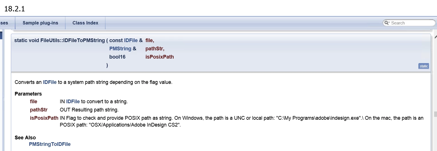

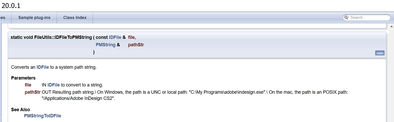

Hi All,
Currently I am upgrading my plugin from adobe 18.3 to 20.0.1.
while compiling with new 2025 SDK , getting below error:
 error C2660: 'FileUtils::IDFileToPMString': function does not take 3 arguments
while trying to match the argument list '(const IDFile, PMString, const bool16)'.
In 2023 SDK, this method of "IDFileToPMString" was having 3 parms but now with 2 only.
Its causing compilation failure. Is there any alternate for this issue?
If I remove additional(last) argument while compiling the code, the code is getting compiled successfully but it that proper way of doing it ?
Does it cause any issues while using my plugin with indesign ?
Below attached the references from both SDKs.

Dec 1, 2024 11:28 AM UTC
I'm not a plug-in expert - but POSIX paths has been made native for Macs - from version 19 / 2024 - so this extra param is probably no longer needed.

But for windows as well this path matters right ? as per the attached screenshots from SDK guide.

Robert at ID-TaskerCorrect answer
Dec 1, 2024 11:44 AM UTC
I think it only related to Macs - path on PC remains the same.
