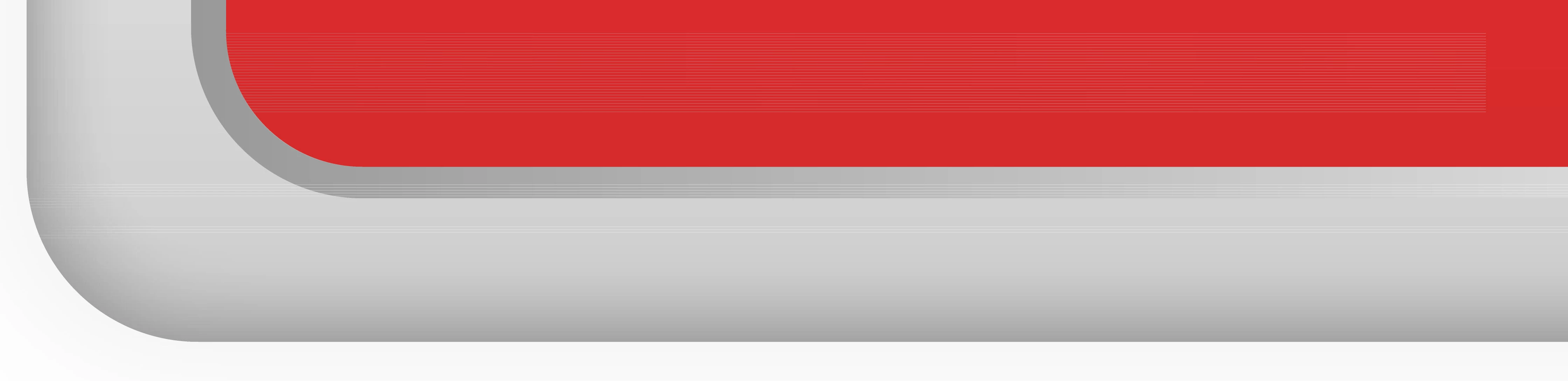

When I try to export my vector to jpg: Save for web and devices -> jpg with big resolution (8000x8000)appear strange white parallel lines at the jpg image. But if it (2000x2000) it's look fine

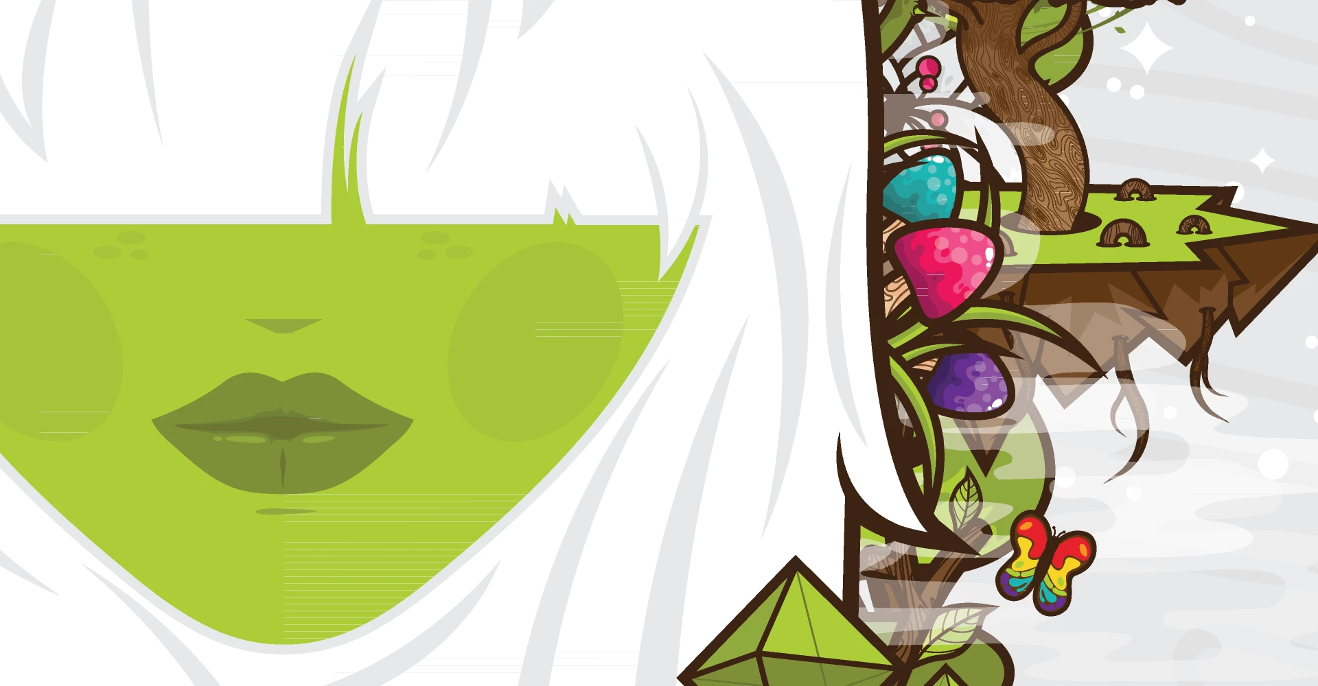

    July 18, 2010
    I have this exact issue.
    Happens in "Save for web" and in "export". I managed to keep CS4 still installed and took the exact same file and "exported" it and "saved for web", and no issue at all in CS4. This is def. an issue that has popped back up in CS5 then.
    On my attached image there is no gradients or special effects, just clipping masks.
    I've tried the new options they have in save for web, "Art Optimized" and "Type Optimized". The issue does not happen in "Type Optimized" but the quality in type optimized is lower and it renders the exact same as the vector file appears(so colors bleeding out a pixel behind some objects etc.) The issue does happen in "art optimized".
    Issues happens when saving in png and jpg format, with or without transparency.
    I've attached an example, notice the lines in her face. (same as initial attached image)
    So is this a "wait for an update" sort of scenario? or is this a "use a different program to save for web" scenario?

    May 15, 2010
    original vector is 800x800, red is two objects - red and white 20% transparency (it's part of gass button)
    when save jpg 2000x2000 it's fine
    when save jpg 3000x3000 or biggest it have white lines
    png, gif have some problem
    Illustrator CS4 save this as jpg 8000x8000 fine
    Maybe cs5 have new rasterization module?
    Just try rasterize Edit->rasterize - new image have white lines
