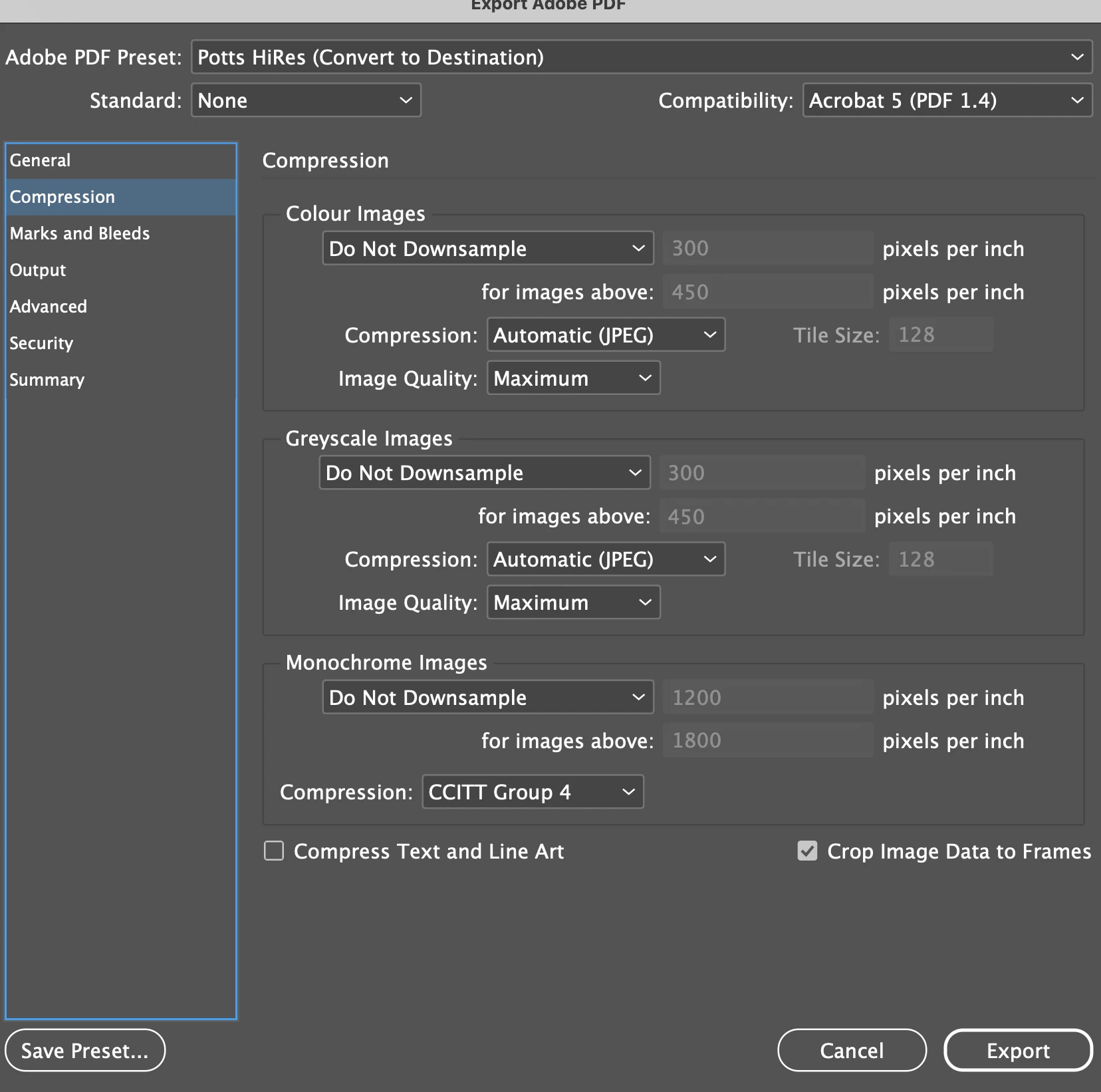

I'm not sure what the purpose would be of ever setting the PDF export to Do Not Downsample. Seems like you would want 200 or 300 if you want to zoom in on it.
The questions still is: in ID, what is the effective PPI of the placed graphic?

"I'm not sure what the purpose would be of ever setting the PDF export to Do Not Downsample"
As a prepress person I can answer that. The normal "usual" of downsampling to 300 is great for photo images, etc, but can destroy the quality of any rasterized text on a high-resolution output device, especially at smaller type sizes (it becomes "fuzzy and blurry" due to antialiasing of downsampling)*. To avoid this, we always ask for Do Not Downsample so the quality we receive in their PDF is the best possible.
The drawback then, is that some images may come to us at TOO high resolution, which is not normally a problem as our RIPs can handle it easily, but in the OP's case is causing issues with viewing.
* if you ever ordered business cards from a cheap online place that asks for a 300ppi JPG to print from, this is why your cards looks so crappy.

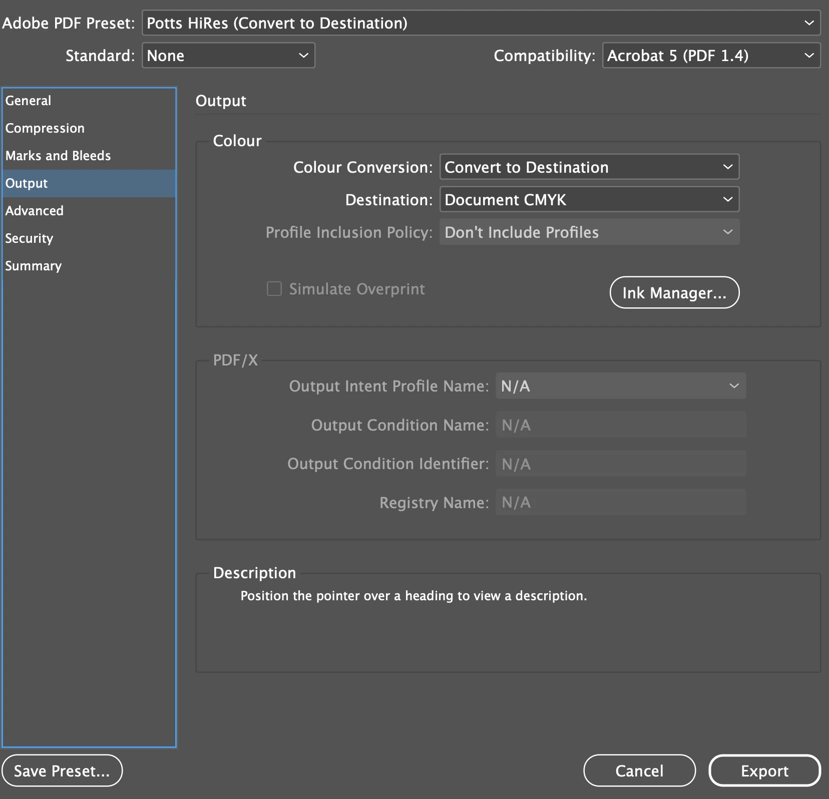

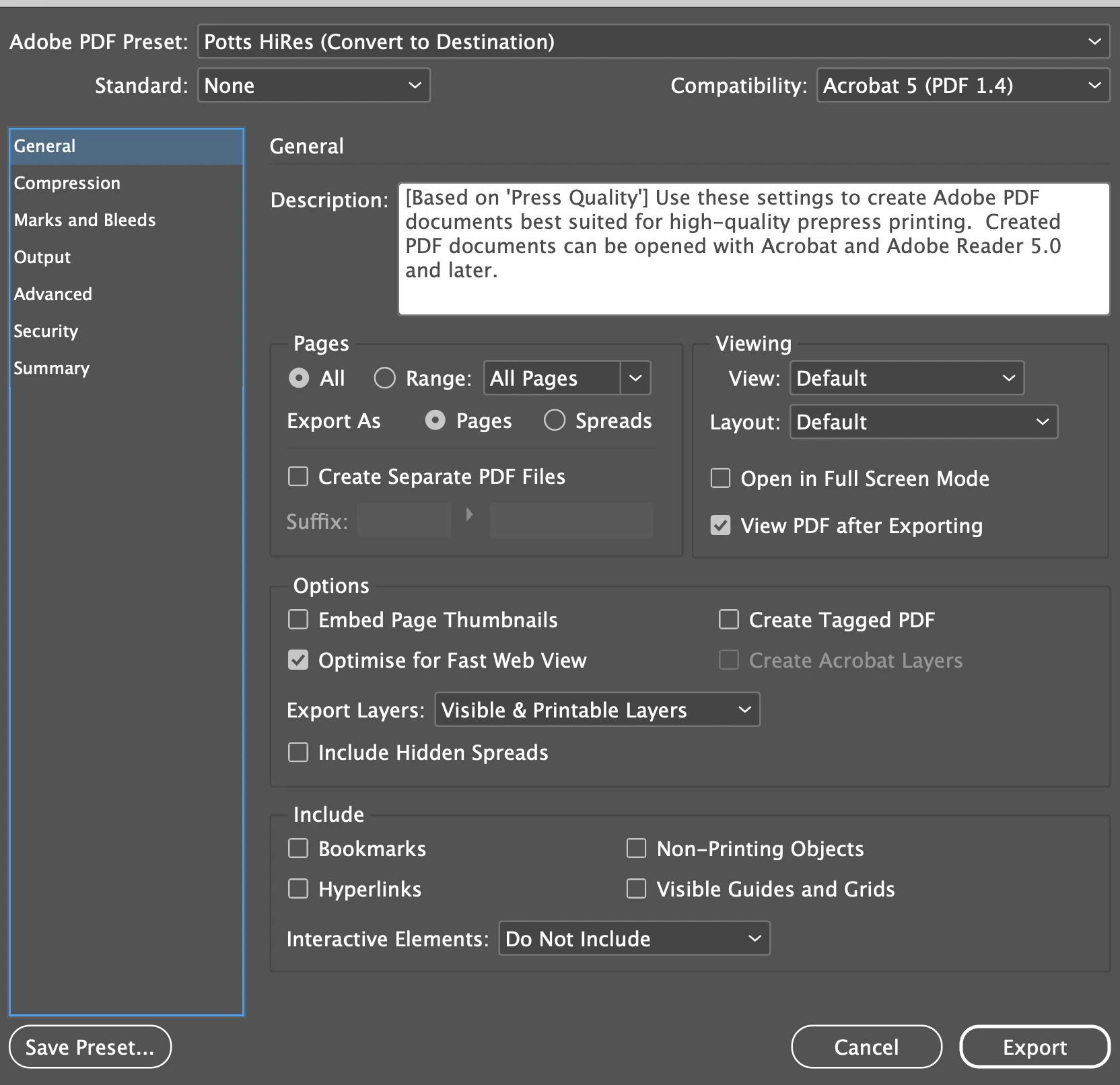

ATTACHED EXPORT SETTINGS (PROVIDED BY AN EXTERNAL PRINTERS  - COULD BE THE ISSUE)

The export settings are just fine if that's what they asked for (although not sure why you say low-res pdf when these setting are definitely not for that)
However, since they are asking you to turn off Downsampling, if your small images are very large resolution files, they may now be TOO high resolution when scaled down like that, and Acrobat is choking on them a bit.
(also check Acrobat Preferences > Page Display > Show Large Images)
What are the original (pixel) dimensions of your small images? and what are they scaled at in InDesign?
