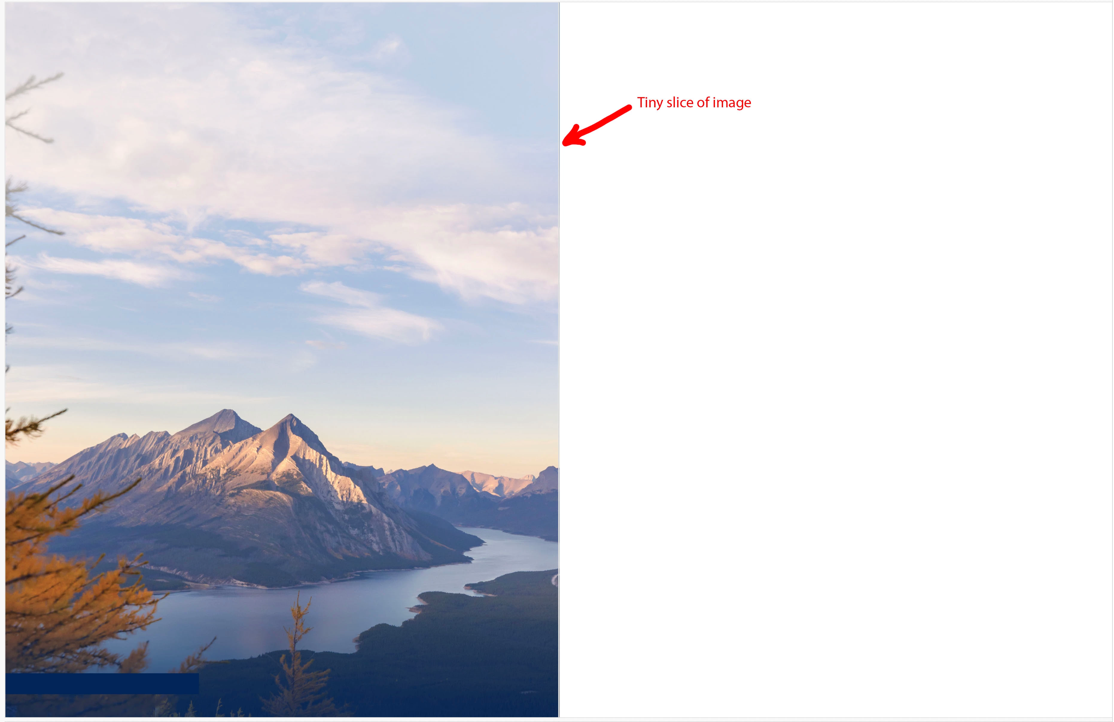

I have a 8.5 x 11 facing page document where some of the pages have a full page image which bleeds on (for example) the top, bottom and left if a left side page and I have a 1/8 set on top outer and bottom sides and 0” bleed on the inside. The image is aligned to the page edge on the inner gutter with no image bleeding to the right side. Verifying the alignment the right edge is at 8.5”. If I make a pdf there is a teeny sliver of the image showing up on the right hand inner margin of the facing page. I have one client that always flags this issue so I have to fix this by setting the image to 8.499”. This seems like a bug and once it is pointed out to me it really bothers me.  It only seems to do this for photos and not coloured boxes. Is there something I am doing wrong?

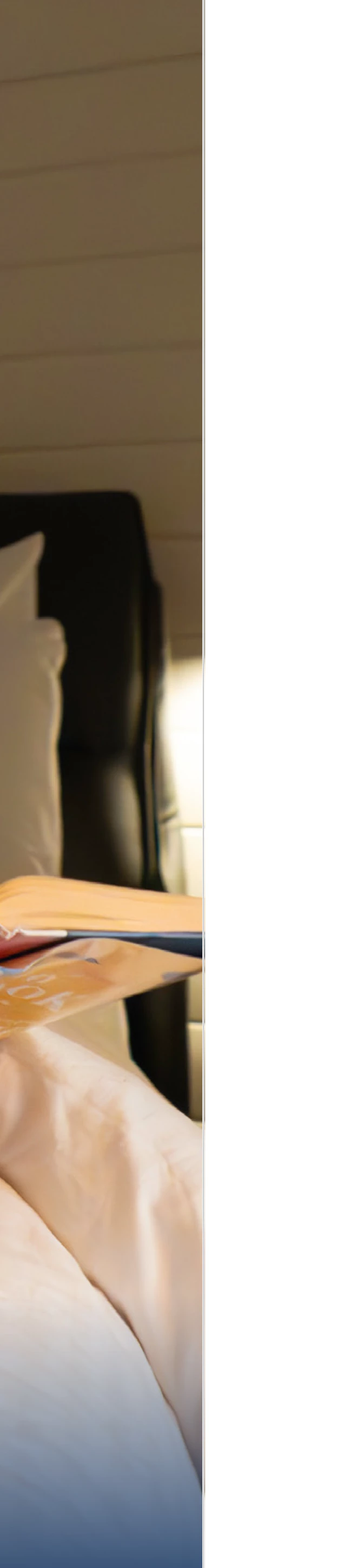

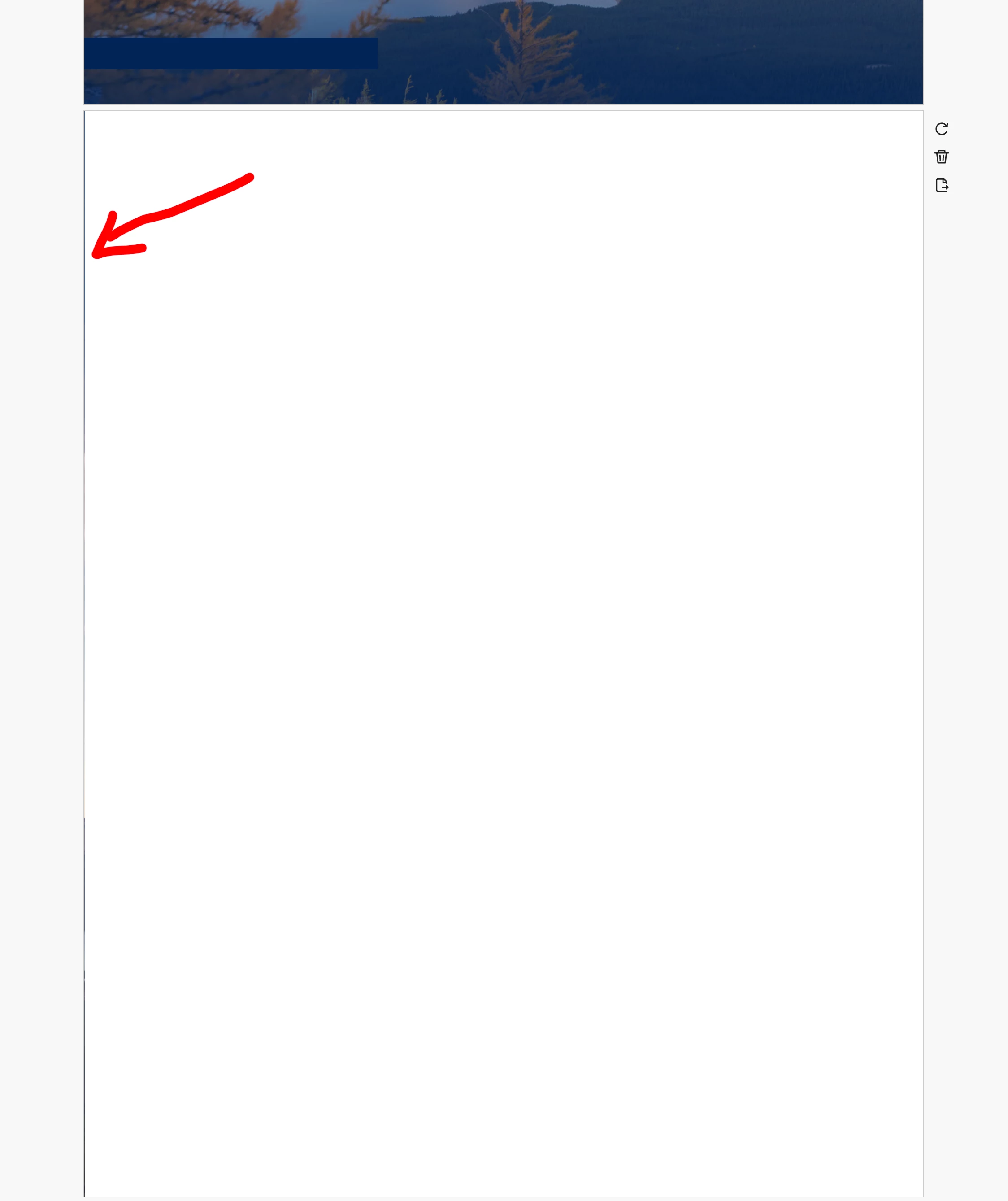

I have attached screen shots from the pdf. First image shows a 2up display where you can see the teeeny slice. Image 2 shows the single page view where the slice is more obvious (not big but it is there and my client hates it).
2up view showing image just slightly going over the gutter.
single page view showing the slice of image on the side of page edge

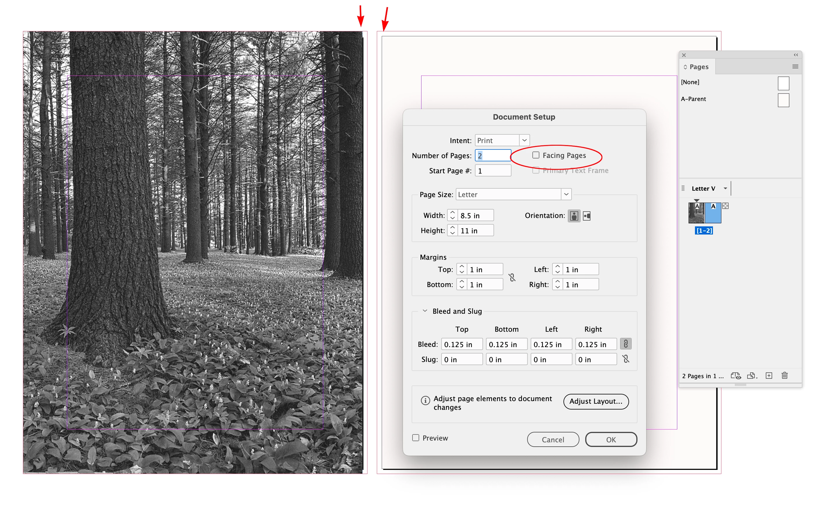

    Hi ​@Eugene Tyson , I wonder if this is because with Facing Page documents it is assumed that the facing pages will be folded at the inside spine and not trimmed. If the facing pages spread is folded, the right edge of the left page and the left edge or the right page share the same position. You can’t pull apart facing page spreads for this reason.
    If I set up a spread in a Non Facing Page doc, pull the pages apart, and export a PDF, the image on the left page does not crossover to the right page. I’ve attached the ID and PDF file

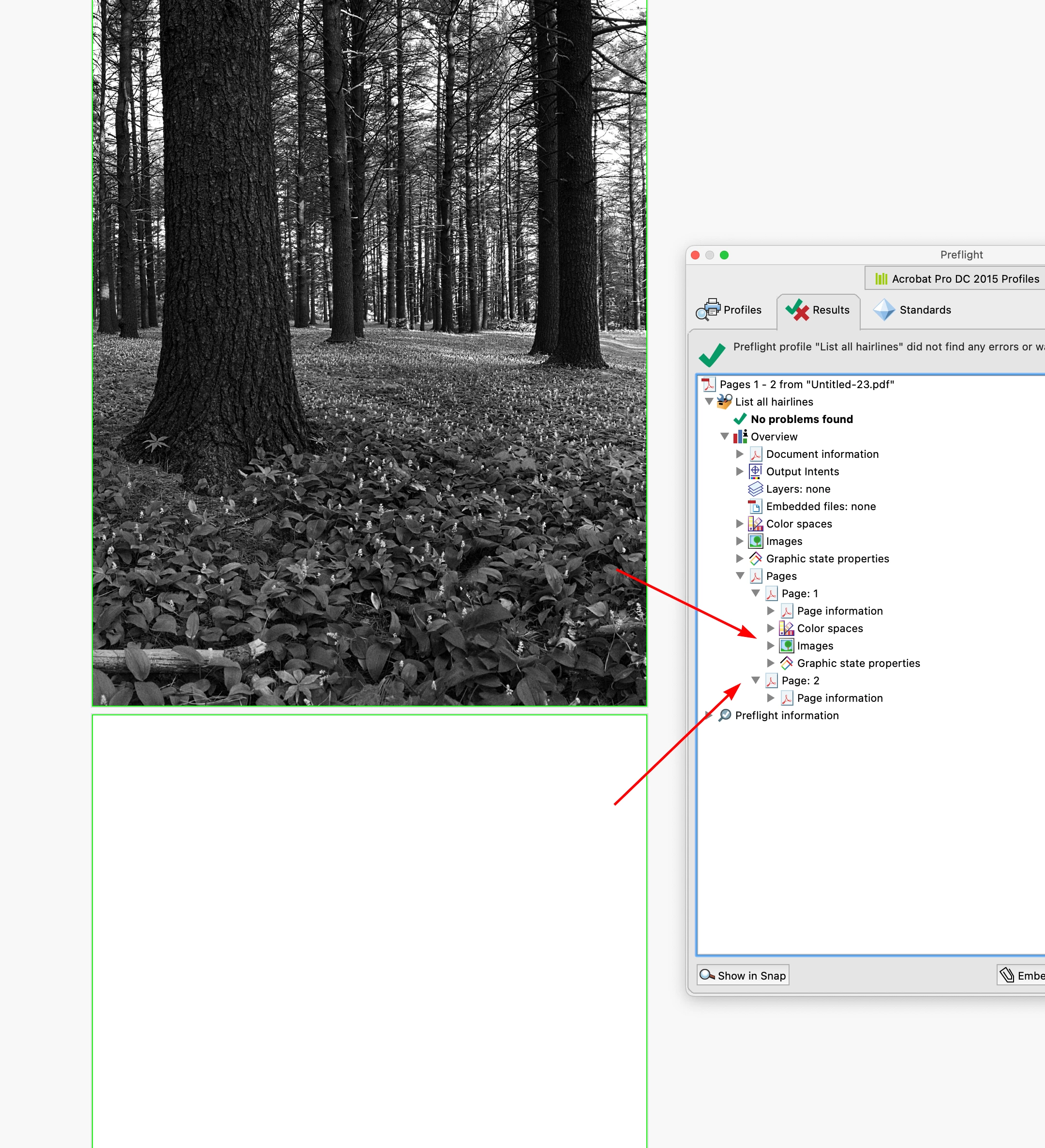

    The exported PDF Preflight:

    This is the right hand page when viewed as a single page view in Acrobat. See the thin slice of image on the right hand side? Not big but my client notices it every single time.

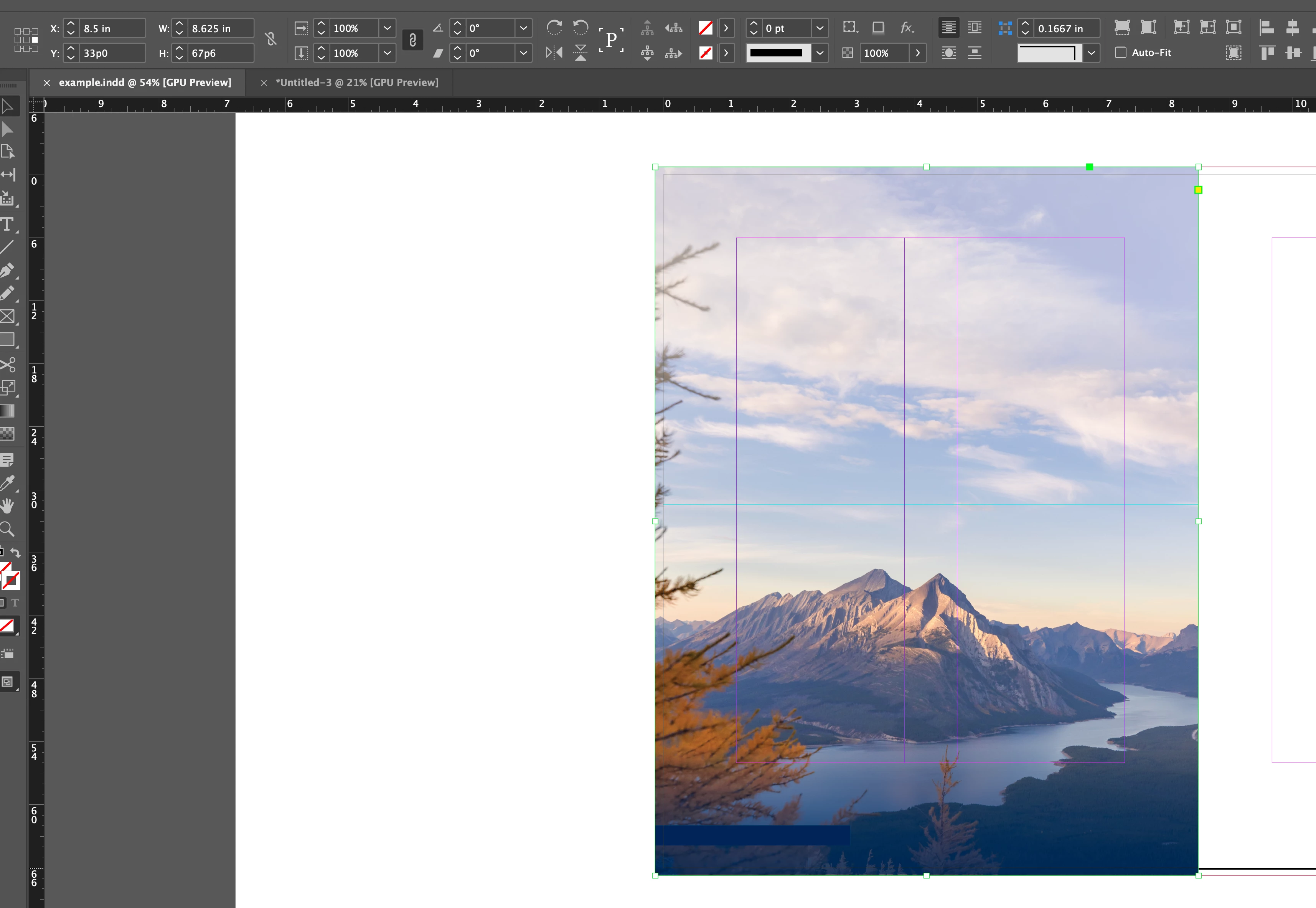

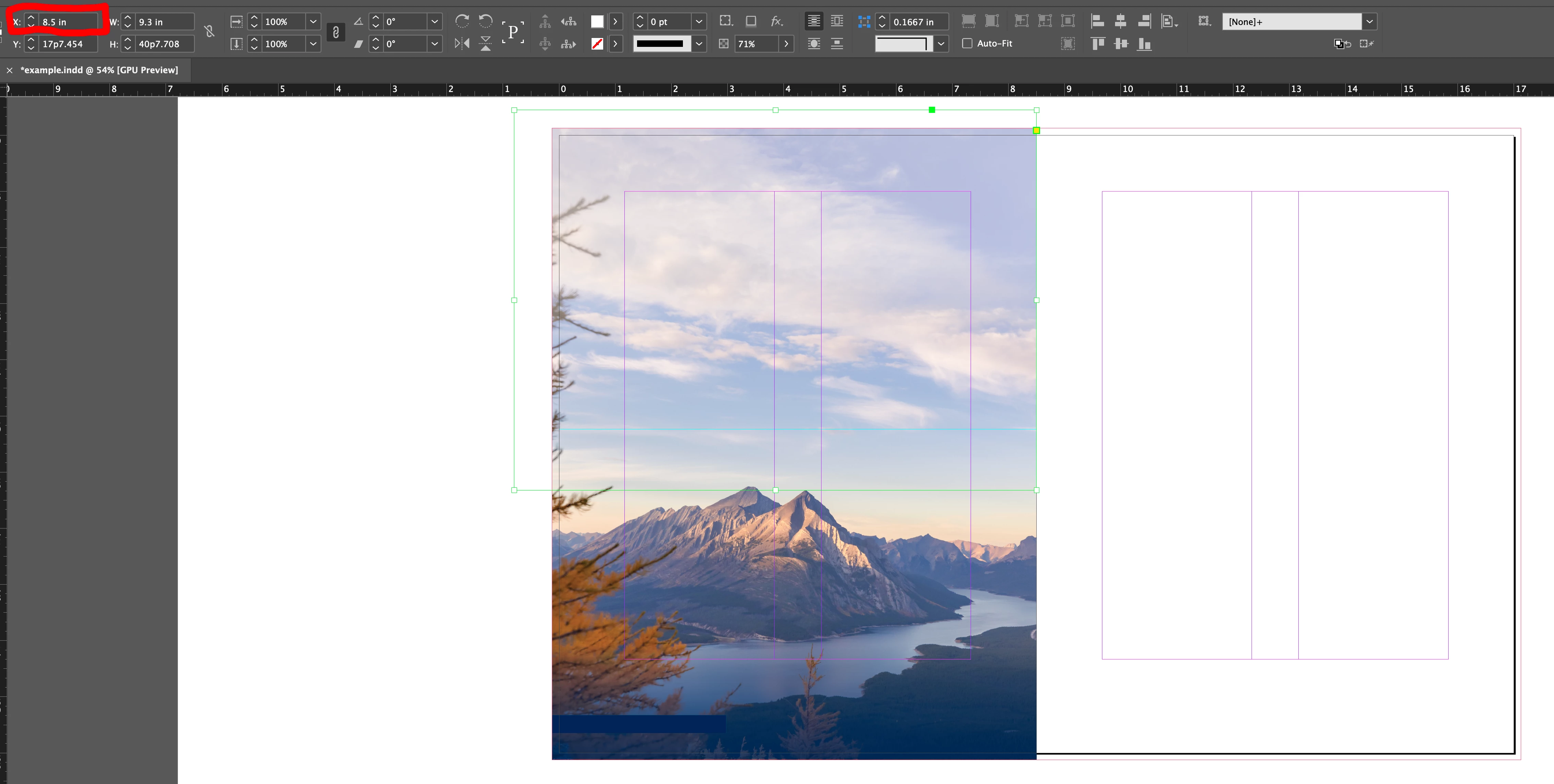

    Here is my setup. The right hand edge of the image is at 8.5” alignment (circled in red) which I used align to page edge.
    This is the pdf view with a slice of the image on the left page showing up on the inside margin of the right hand page.

    I’m not seeing this on my end.
    Can you upload a sample spread?
    What is the green box you have highlighted? It does not appear to be the graphic itself.

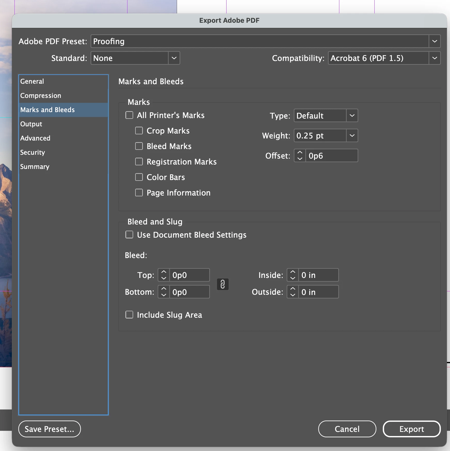

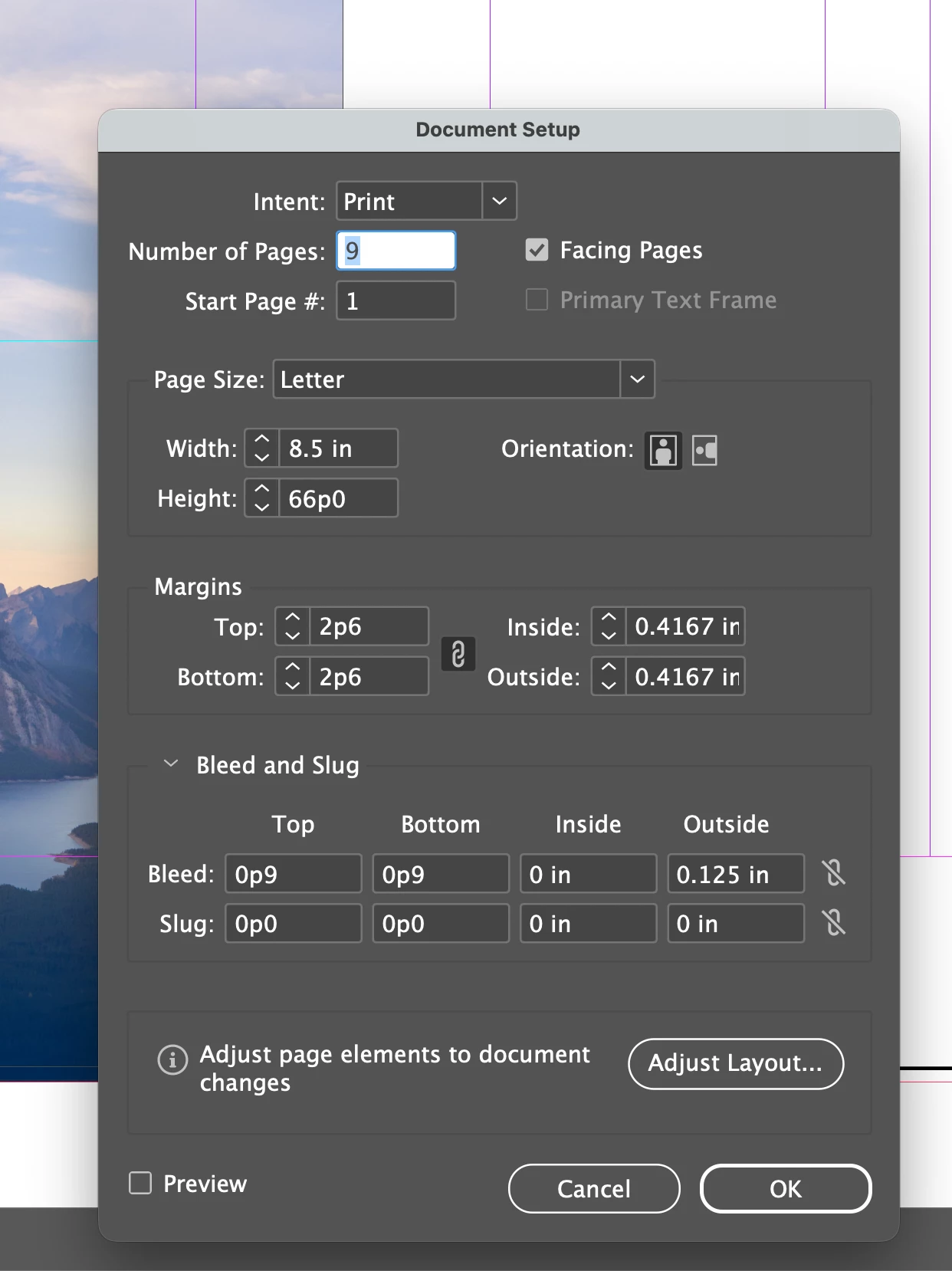

    Also, if you can’t upload a spread, please show your:
    • Document Setup showing page size and bleed settings.
    • Spread with BG image selected.
    • PDF settings, particularly the bleed settings.
    Jul 24, 2026 5:14 PM UTC
    Sorry the green selected I had selected a white transparent gradient overlay that I had to lighten the sky because the actual file has copy there. I meant to select the photo. New screen shot.
    pdf settings.
     This document is being printed cerlox bound so I will eventually have to add bleed to all edges but it will also be web posted and that is where this issue is being flagged as I am proofing as pdf and my client keeps noticing this tiny bit of bleed. I have cleaned out most of the information in the file since this is an Annual Report in progress. One image left in as well as attaching the pdf I export.

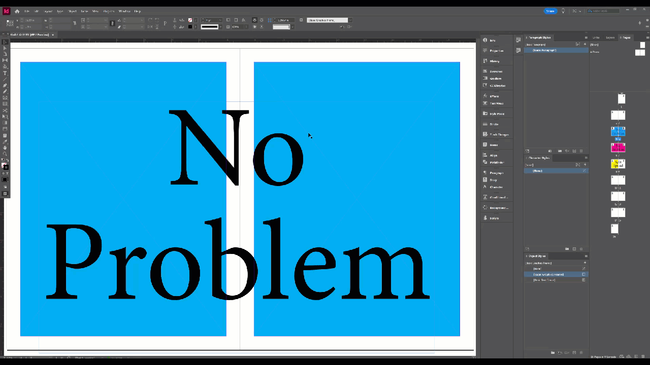

    Generally, you will have three types of spreads:
    • The page BG or images do not go near the edge; no need to touch these pages.
    • The page BG or images cross over to the other page; no need to touch these pages.
    • ou need to split these pages apart by turning off Allow Document Pages to Shuffle.
    Here is how you can do it (focus on the BG color, not the text):
