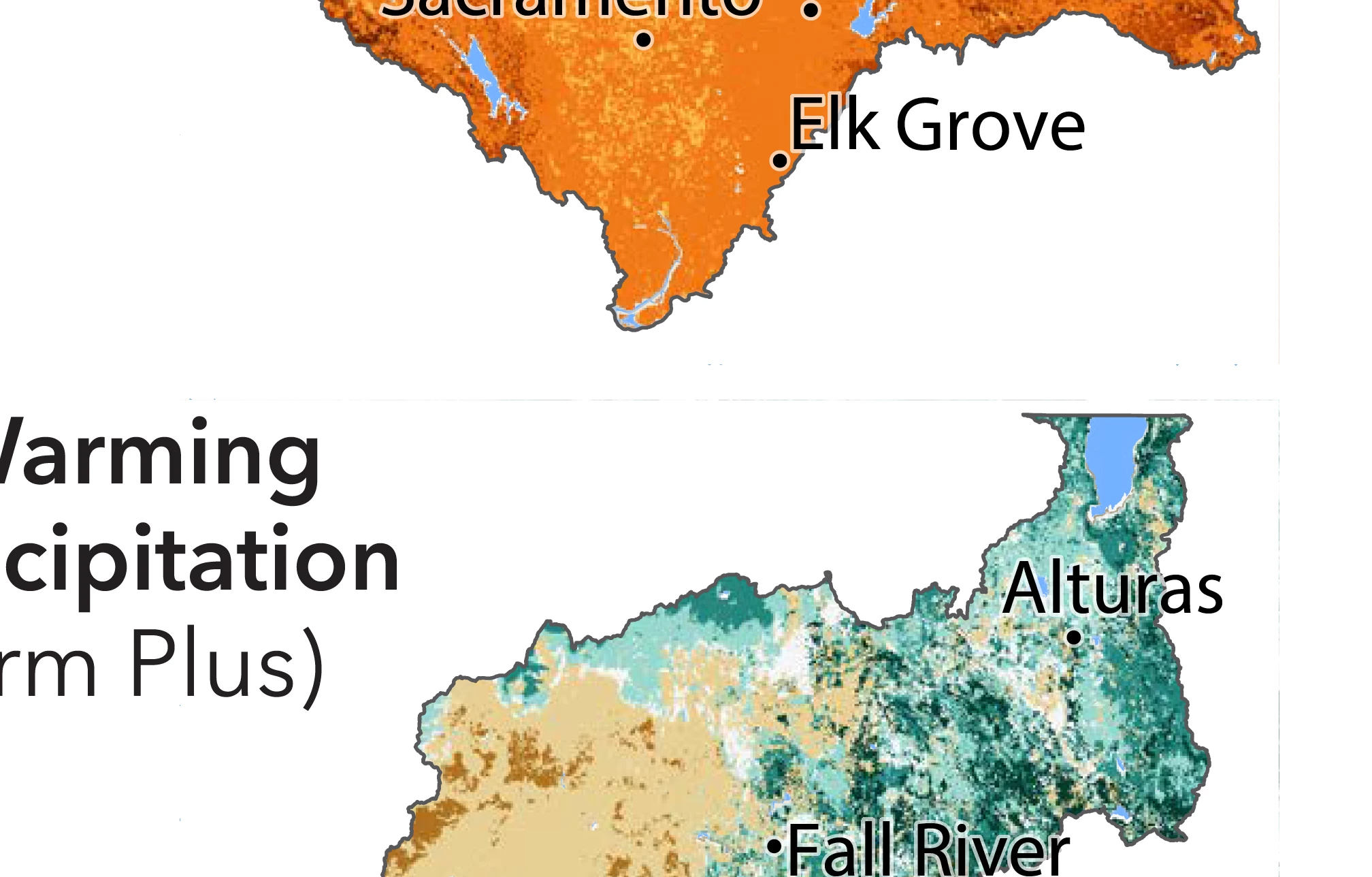

Image edges leaking from placed Ill files?
So, I've placed Illustrator files into InDesign.
The boxes they're placed in have no fill/stroke/transparency.
The Ill files have white backgrounds.
In ID there's no halo around the box - at first. Then they show up, and go away on restart, but then appear again.
I'm using my GPU performance display - these are set to Typical.
So, on the client's PC, these edges in their view of the Acrobat file are GIGANTIC as well as PERSISTENT.
What gives? meaning, why are they there? If I put a white stroke (1pt) on the box they go away.
What's the fix? How do I stop this cancer gnawing at the root of civilization etc.? I look forward to your collective, always sagacious, council - THANKS! -sno

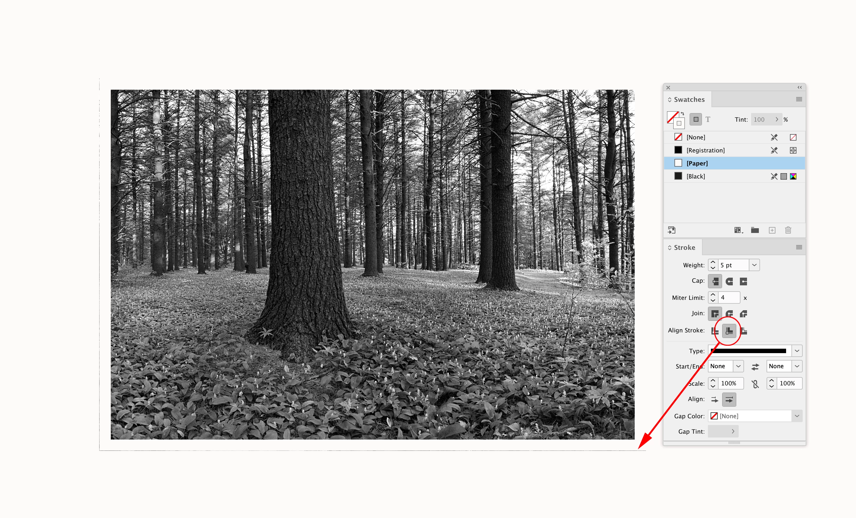

rob day
Aug 13, 2025 5:02 PM UTC
Hi @Scott.Olling , Try setting your [Paper] or white stroke alignment to either Center or Outside
Scott.Olling
Aug 13, 2025 5:10 PM UTC
Thanks - I will if I have to - but I'll walk the streets with a cloud overhead

What happens if you switch to High Quality Display? If you turn off GPU Performance?
Scott.Olling
Aug 12, 2025 10:19 PM UTC
going to Overprint Preview from Typical to Overprint Preview causes the lines to show. I get a spot color alert.
turning off Overprint Preview they go away.
going in the drop down from Typical to HQD the edges show. going back they go away.
now going to destroy all my spot colors and go again.
this is progress - great - but why do these lines show in the PDF? this is just display hijinks - is the PDF made from the GPU output? where's PostScript in this?

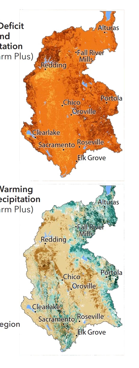

Scott.Olling
Aug 12, 2025 10:26 PM UTC
four spot colors converted
all in RGB space
made new PDF - result attached.
entertaining new conjectures - not sure where to go here. do I really put a white stroke on all these boxes? it's 2025 I've got my jetpak right here next to me
