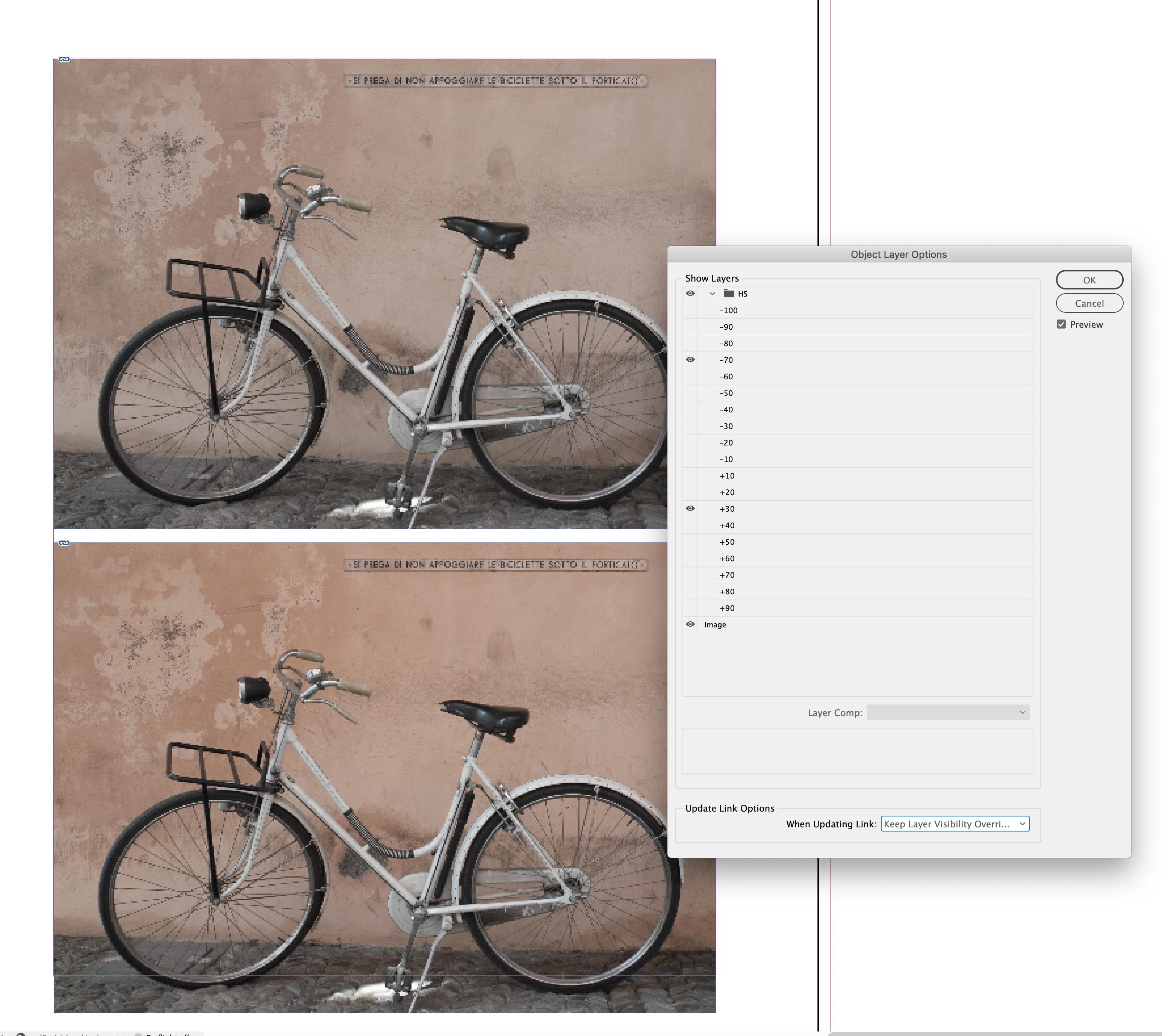

And you might not need as many adjustments as in my example. If I wanted somewhere between -70 and -60 I could add back some saturation by turning on one of the + layers.
Both images at -70 Saturation
The bottom image with +30 added back in:

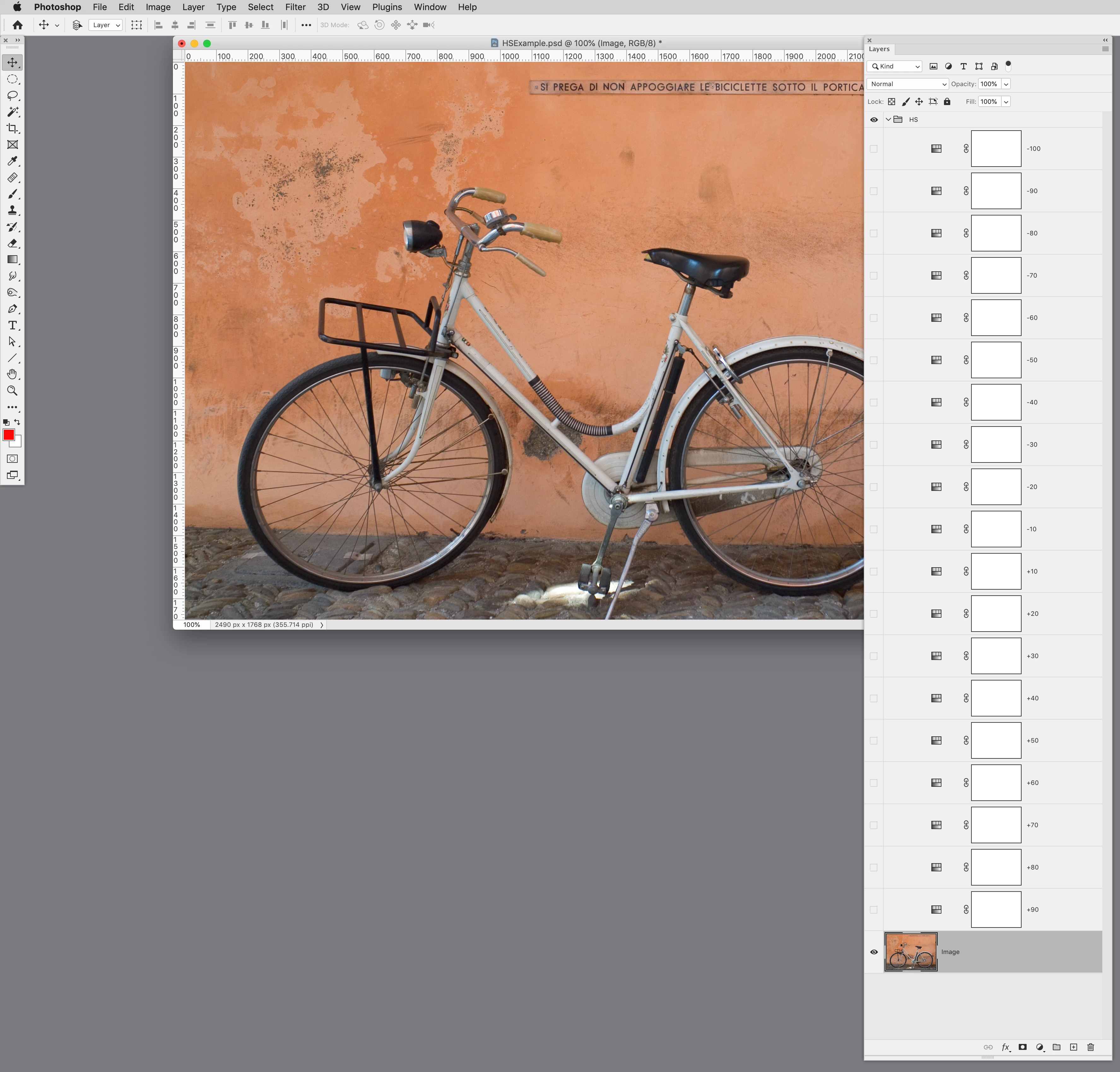

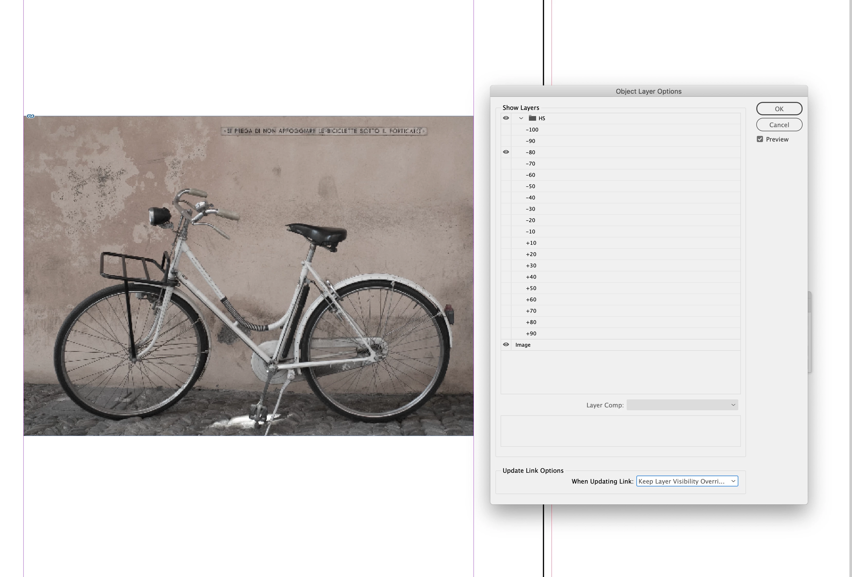

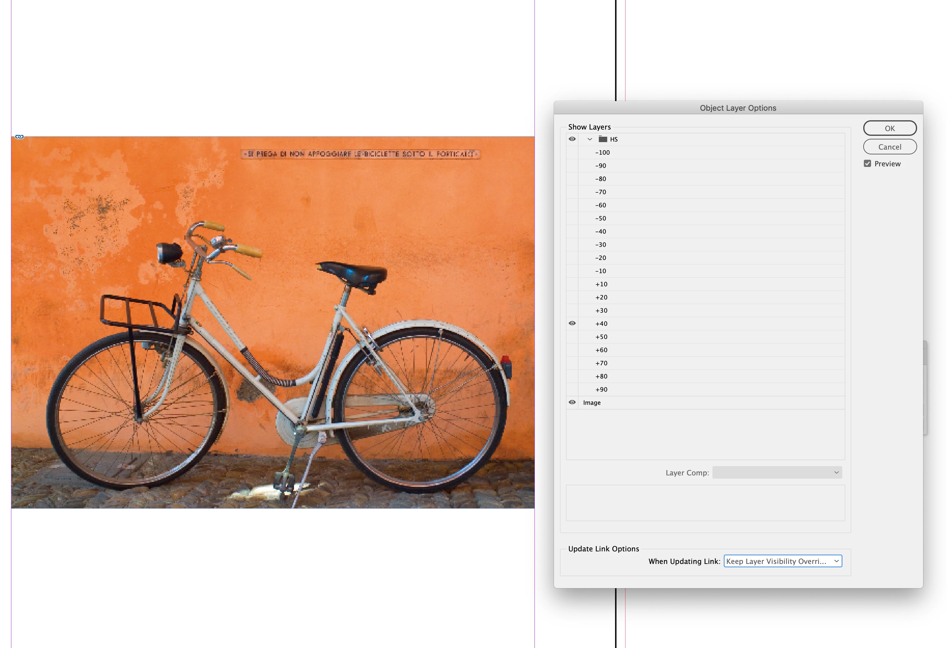

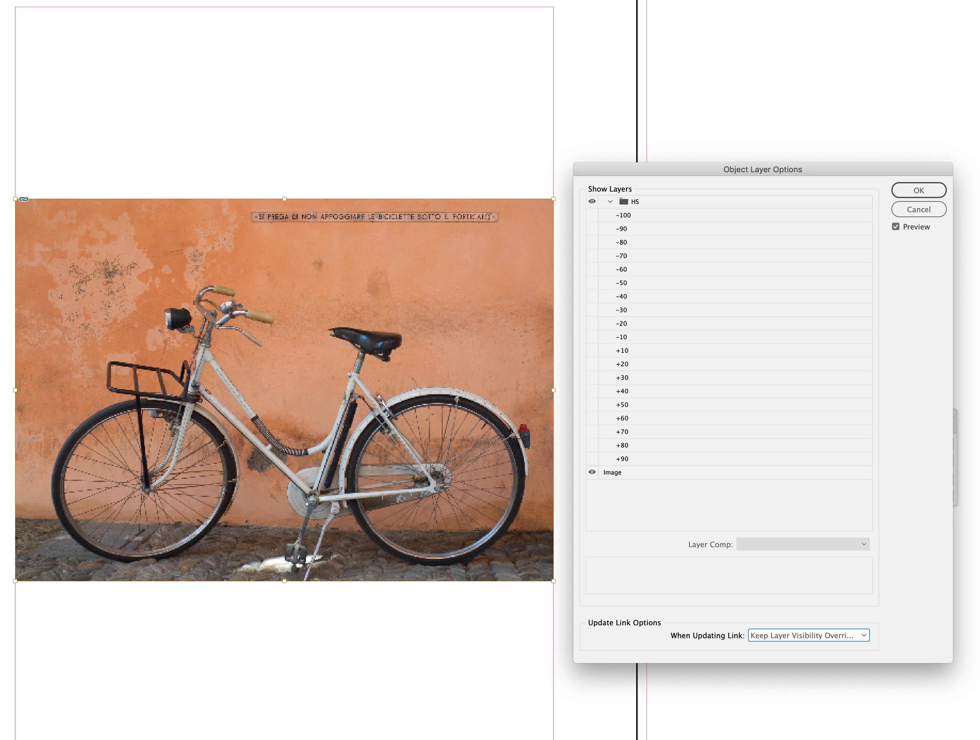

Besides deciding where to draw the line on what "Lite" image editing means, there would also be the question of whether the linked image file can be modified by InDesign. If you make a correction is InDesign going to save the image? When would the image save happen? Is there a separate save dialog for the linked image, or does it get saved when the ID document is saved? What if it is open in Photoshop—is the Save prevented, or does the image change in PS?
You might decide linked images can’t be saved by InDesign, and the correction acts like an adjustment layer in Photoshop. In that case InDesign’s Object Layer Options could let you do something similar. It would be possible to create and save libraries of adjustment layers that could be turned on or off. For example a Saturation group put over the image in Photoshop and manipulated inside of InDesign:
No adjustment:
-90% Saturation:
+40% Saturation
The image and group in Photoshop. The HS group could be dragged on to any image:
