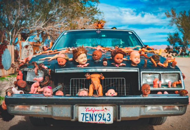

I am working on a project in Indesign and flipping back and forth between it and Lightroom. Everything was fine at first, all images looked good in Indesign, then something happened and now all of the images are overly saturated in Indesign. I don't remember changing any settings, but may have hit a hot key that changed it? Any help is appreciated! (First image is the Indesign photo, second is Lightroom)

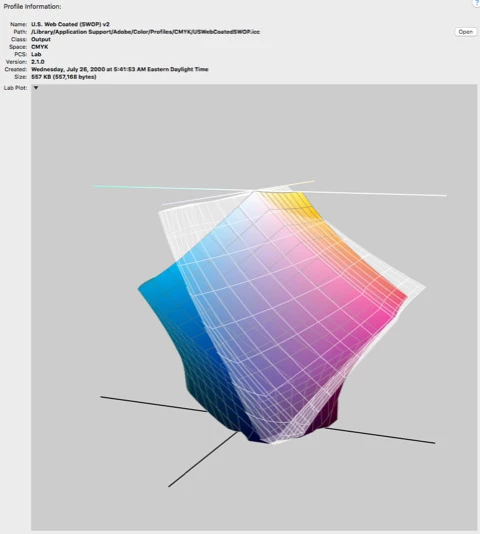

    Here's default SWOP Coated compared to sRGB (the white plot)—you can see the significant parts of the cyan/blue and yellow CMYK gamut you give up when working in sRGB.

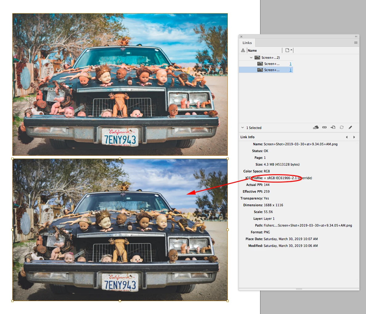

    Mar 30, 2019 2:17 PM UTC
    It looks like the bottom image has sRGB or a monitor profile assigned, and the top image has the same RGB values, but with ProPhoto RGB or some other wide gamut RGB profiled assigned.
    If you place an RGB image saved with no embedded color profile, the InDesign document’s assigned profile is used to color manage the placed image. Check your document's assigned profile (Edit>Assign Profiles...), and also select the image and check its profile in the Links Info panel.
