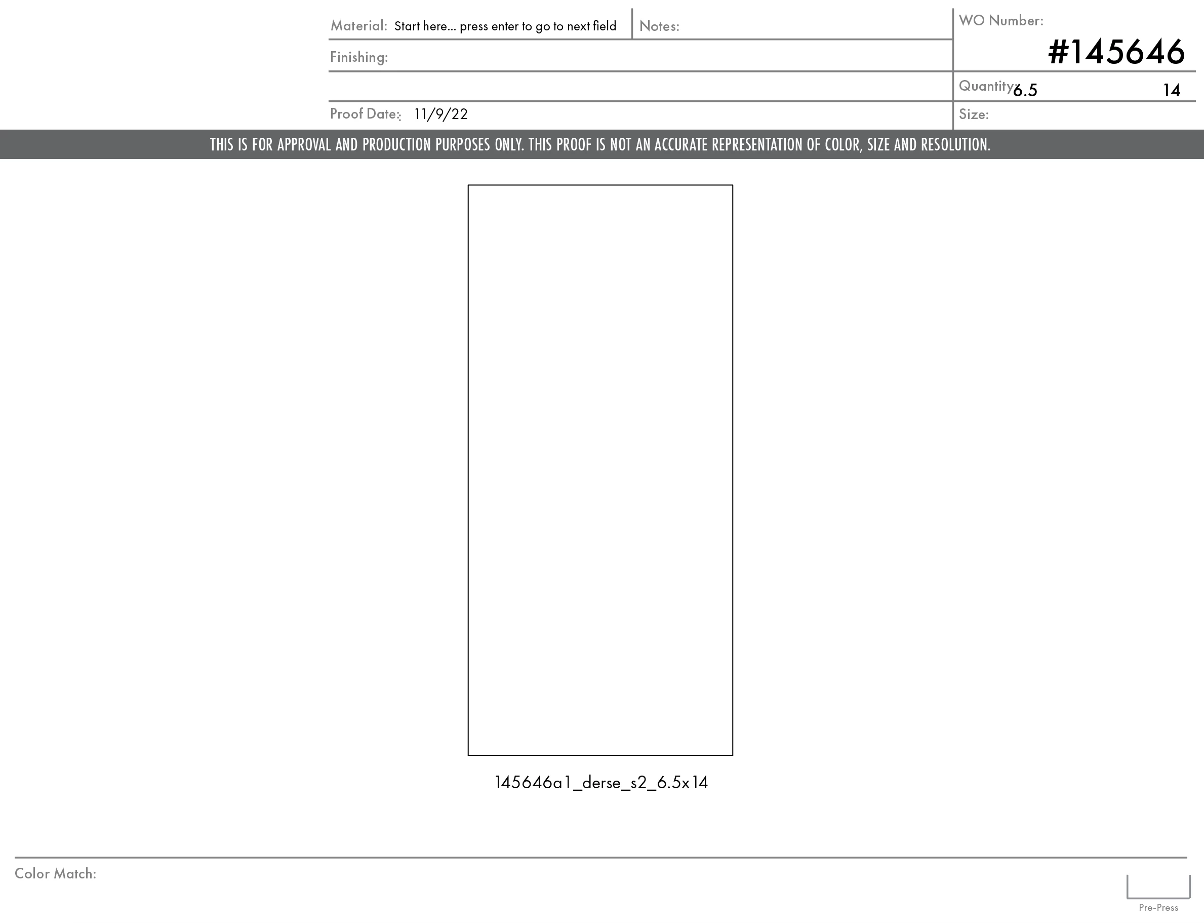

Hello!
So I'm pretty new to scripting in general and I'm trying to figure out how to place my sizes in the right spot. Right nowI have them landing in the quantity area by changing numbers in the geometricboyunds area, but I can't seem to get them to go down on eline into the size section. I attached some screenshots too. Any help would be greatly appreciated!
Here is the snippet of code I've been working from:
var myTextFrame = myFrame.parent.textFrames.add(myDocument.layers.item(1), undefined, undefined,{geometricBounds: [300, 637, 53.5, 682] , contents:myLabel .replace('.ai', '') .replace('.tif', '') .replace('.pdf', '') .replace('.psd', '') .replace('.jpg', '') .replace('.eps', '') .replace('_Back', '') .replace('_Front', '') .replace('_back', '') .replace('_front', '') .replace('_Halfscale', '') .replace('_halfscale', '') .replace('_10thscale', '') .replace('_tenthscale','') .replace('_Tenthscale','') .replace('_quarterscale','') .replace('_Quarterscale','') .replace('_Gang','') .replace('_gang','')});
myTextFrame.textFramePreferences.firstBaselineOffset = FirstBaseline.leadingOffset;
myTextFrame.parentStory.texts.item(0).appliedParagraphStyle = "Width";
var myTextFrame = myFrame.parent.textFrames.add(myDocument.layers.item(1), undefined, undefined,{geometricBounds: [300, 730, 53.5, 775] , contents:myLabel .replace('x', 'X') .replace('.ai', '') .replace('.tif', '') .replace('.pdf', '') .replace('.psd', '') .replace('.jpg', '') .replace('.eps', '') .replace('_Back', '') .replace('_Front', '') .replace('_back', '') .replace('_front', '') .replace('_Halfscale', '') .replace('_halfscale', '') .replace('_10thscale', '') .replace('_tenthscale','') .replace('_Tenthscale','') .replace('_quarterscale','') .replace('_Quarterscale','') .replace('x', 'X') .replace('x', 'X') .replace('x', 'X') .replace('_Gang','') .replace('_gang','')});
myTextFrame.parentStory.texts.item(0).appliedParagraphStyle = "Height";
Correct answer Loic.Aigon
What you can do is actually to hand place a reference frame and note coordinates and size in the transform panel. Then you can use those in your script as it (or almost). The Geometric bounds are expressed as [y1, x1, y2, x2] so once you have set the right value, you should be able to use them. Of course, you need to be sure a document is not set with a different reference point or different coordinates units.
Apart from that, you may consider using a regex to shorten and make clearer your replace call.

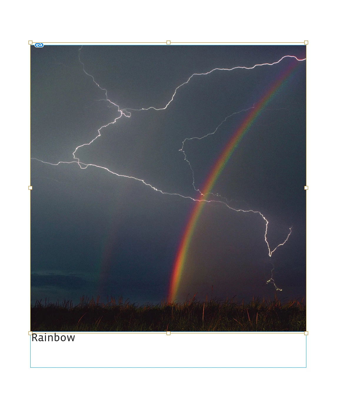

Hi @Rocio_Davidge , Not sure if this helps, but you could get the label frame bounds from the image bounds. This creates a label using Mark’s grep and the image frame bounds for a direct selected image:
//set the scripting units
app.scriptPreferences.measurementUnit = MeasurementUnits.POINTS;
var removeThese = /[\._](ai|tif|pdf|psd|jpg|eps|Back|Front|back|front|Halfscale|halfscale|10thscale|tenthscale|Tenthscale|quarterscale|Quarterscale|Gang|gang)/g;
//the label height
var lh = 32;
var doc = app.activeDocument
var lLayer = doc.layers.item(1)
//a selected image
var myImage = doc.selection[0];
if (sel.constructor.name == "Image") {
    //get the image name and strip ext.
    var lc = myImage.itemLink.name.replace(removeThese, '')
    //get the container frame’s bounds
    var b = myImage.parent.geometricBounds;
    //the parent page
    var pp = myImage.parentPage;
    //the label frame placed underneath the image frame
    var myTextFrame = pp.textFrames.add ({ geometricBounds: [b[2], b[1], b[2]+lh, b[3]], itemLayer:lLayer, fillColor:"None", contents:lc});
app.scriptPreferences.measurementUnit = AutoEnum.AUTO_VALUE;

Loic.Aigon
Loic.AigonCorrect answer
November 10, 2022
Robert at ID-Tasker
November 10, 2022
I'm pretty sure it's [y1, x1, y2, x2]?
Loic.Aigon
November 10, 2022
A typo of course 😉
