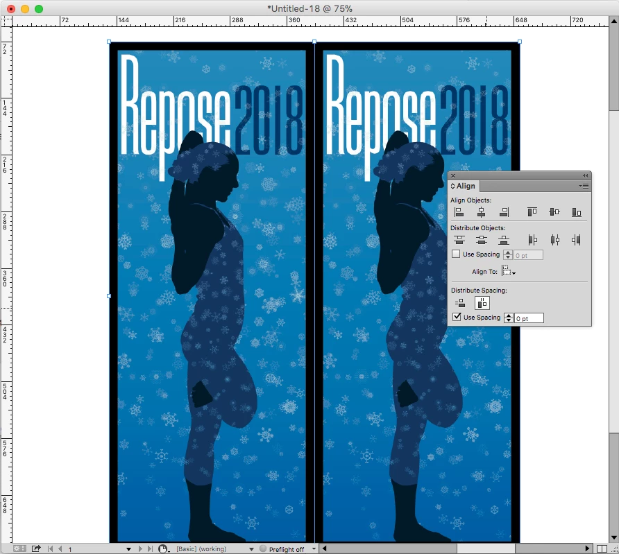

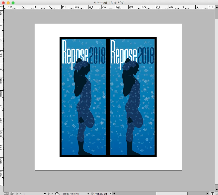

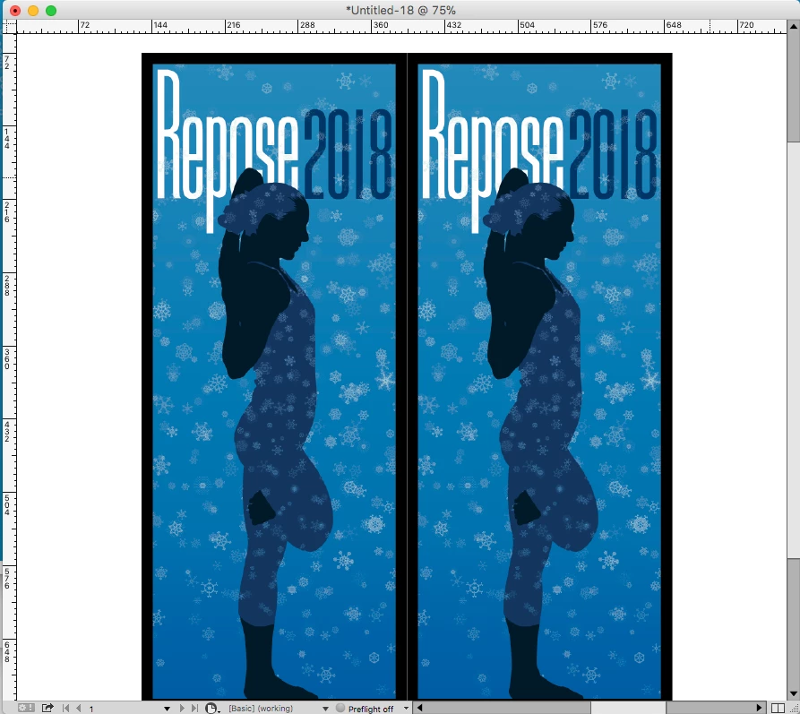

    You can't really rely on your screen preview to manually butt images together because the preview will change slightly depending on the zoom. So you want to do it by the numbers either with step and repeat or using the Align Panel's Use Spacing set to 0.
    But even then the preview is misleading depending on the zoom. So here I used distribute spacing set to 0, but certain zoom levels show a white line that isn't really there—at 50% it looks OK but not at 75%:
    Exported to PDF zoomed in:
    Here I've used Distribute Spacing set to 0, but you can also use a small negative number and get some overlap. You also have to make sure the image's frame is set to Fit Frame to Content before aligning.
