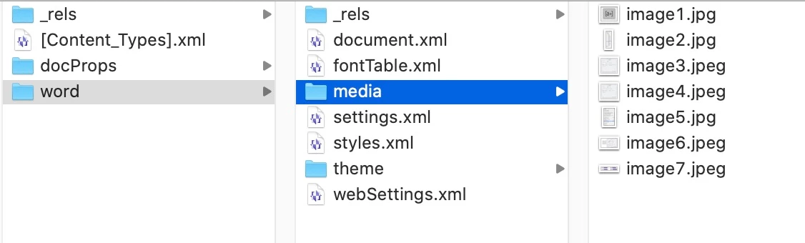

Another possibility would be to import the Word file without the pictures.
Then, to retrieve the images files:
  1. make a copy of the Word file
  2. change the file extension to .zip.
  3.  unzip the file (on my Mac, I use “the unarchiver” application https://theunarchiver.com/)
  4.  you will get a folder, containing subfolders. The images are stored in word > media
