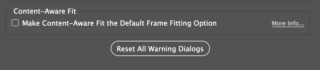

Correct answer BarlaeDC
Just to get the easy stuff out of the way, in Preferences->General there is this setting, might want to make sure it is off.
July 28, 2021
Hi Barlae, if I may call you so. That's just perfect and solved the problem. Thank you so much to you and to this lively community to allow newbies like me to clarify such basic things.
I read through Adobe's documentation and it says "Content-Aware Fit removes the transformations, such as Scale, Rotate, Flip, or Shear, applied to the image. However, the transformations applied to the frame are not removed.".
But the result we get is otherwise, i.e. it applies transformations such as scale even though they are not applied in the image itself.
