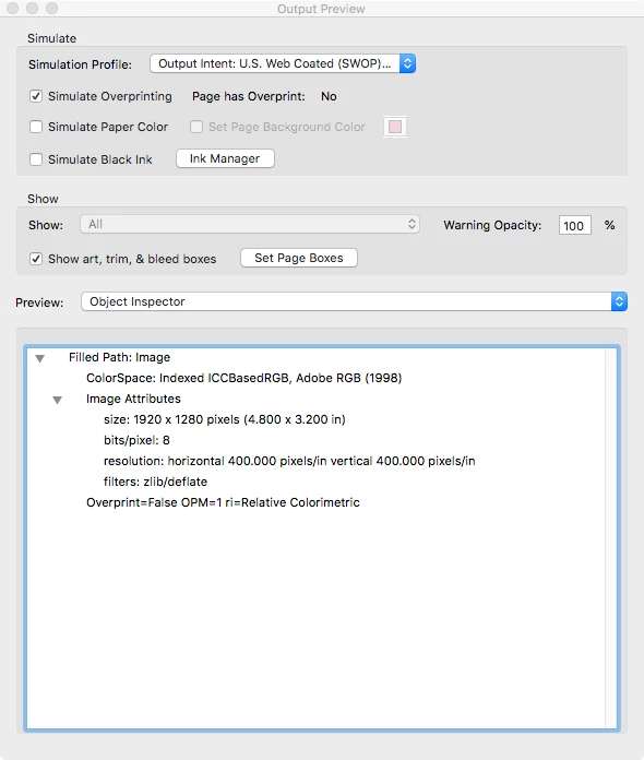

Is there a reason you are using index color? If you inspect an index image in AcrobatPro the compression method is zlib/deflate not JPEG. I think you will get better compression leaving the images as 8-bit per channel:

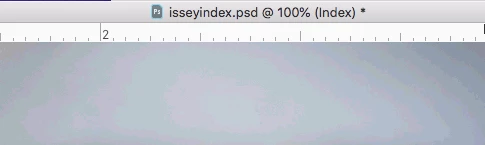

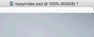

Just to double check, if you open one of the files that are listed as index into Photoshop does the title bar show (RGB/8) after the title and not (Index)?
