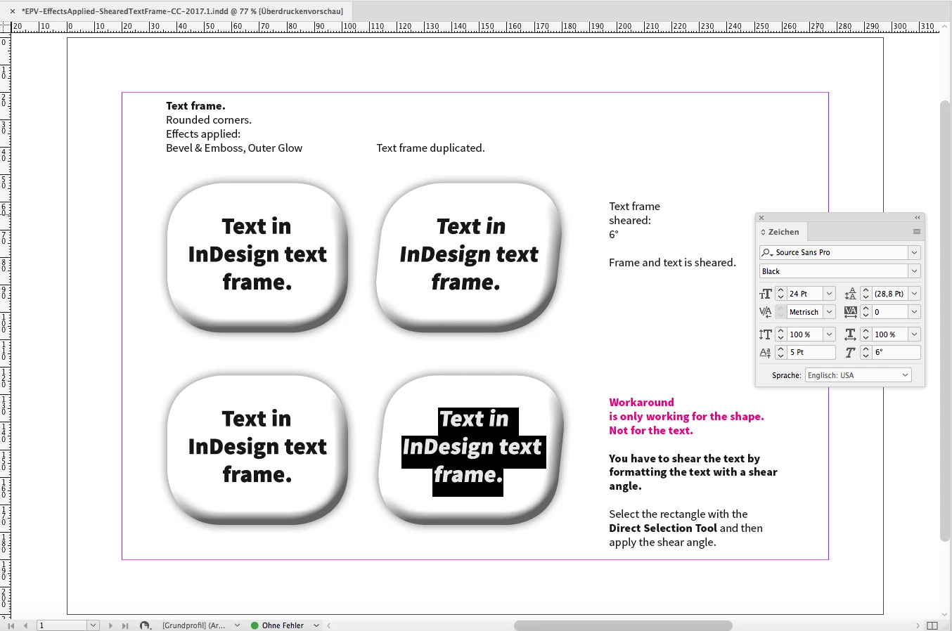

Here one example from InDesign CC 2017.1 where in the upper row I used the Selection Tool to shear the elements.
In row below the bug was not visible because I used the Direct Selection Tool to shear the elements:
InDesign view:

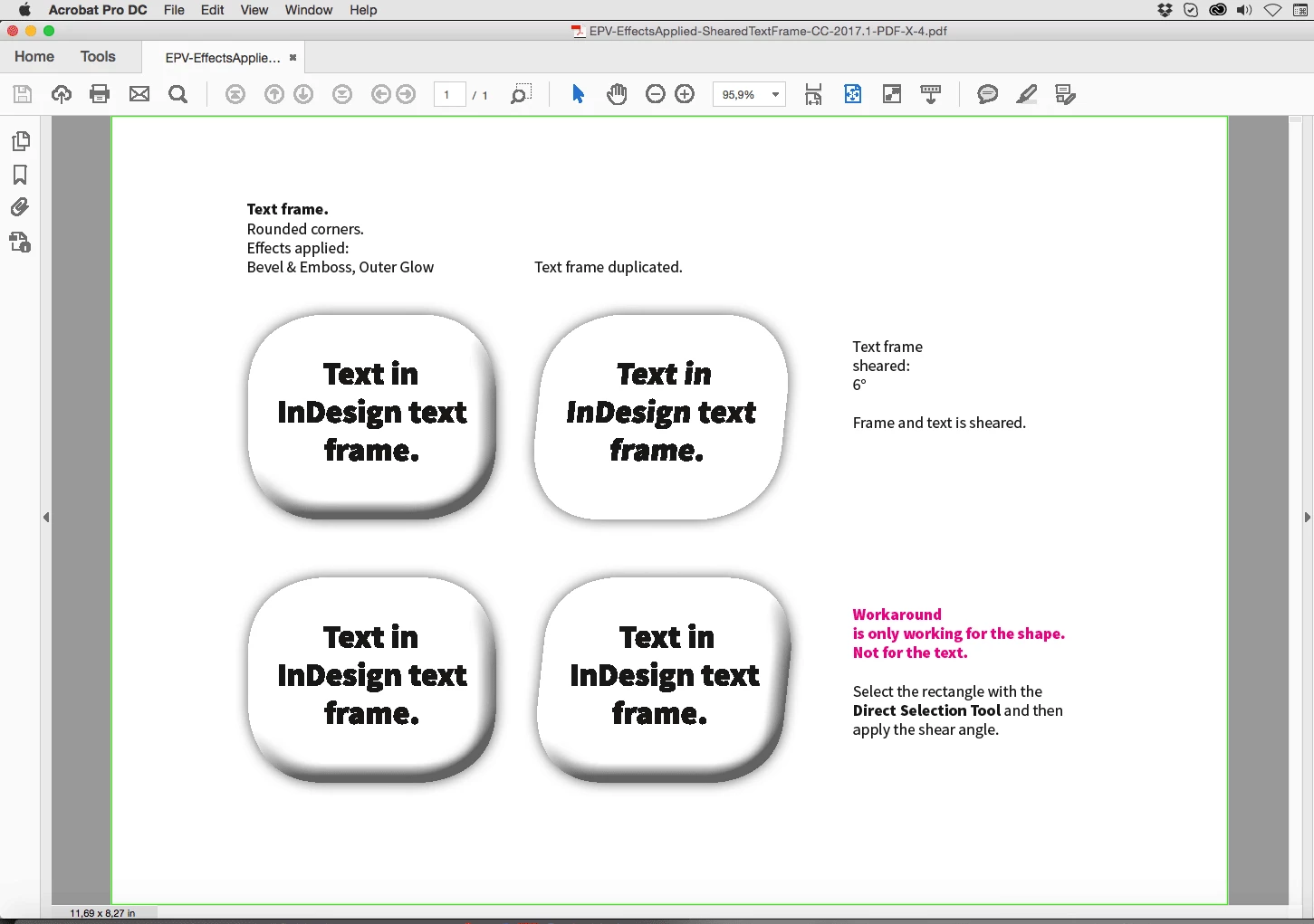

PDF opened in Acrobat Pro DC showing the bug in the second frame of the upper row.
One of the applied effects is missing:
