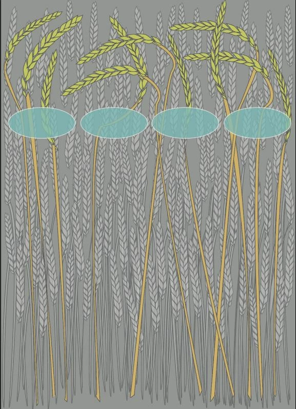

Import from Illustrator looks terrible in InDesign
When I place graphic files in InDesign it looks terrible. Normally it works perfect. What is wrong?
I tried to change from Mac to PC, but that did not help

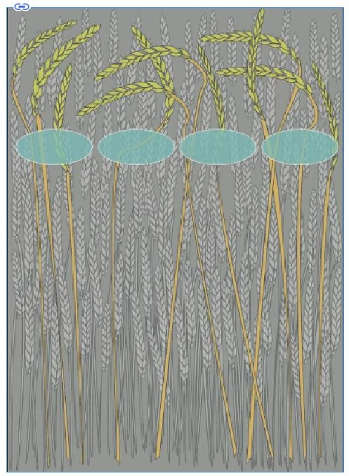

    Select one of the images, and check the Effective PPI in the Links panel. What does it say?
    nilleg57851248
    Feb 20, 2017 6:13 PM UTC
    Actuall PPI are 72
    Effective PPI are 23
    Dimensions are 97 x 113
    Mike Witherell
    Feb 20, 2017 6:19 PM UTC
    So that means the exports were at 72ppi, and then the art was scaled up in size on the ID page, thus lowering the effective ppi to a crude 23 ppi. How are you exporting these pngs and jpgs from Illustrator? Why are you not keeping the artwork in a vector format like a native .ai file or a PDF file format?

    Are you using High Quality display settings?
    Right click and choose display performance as below:
    Eternal Warrior
    Feb 20, 2017 11:44 AM UTC
    In short > because you could have hundreds or even thousands of graphics/images in an InDesign document unless you specifically tell it to.. InDesign will display everything by default on "typical display settings" or occasionally on Fast display...
    This essentially is a thumbnail or pre-render of the actual graphic displayed at a much lower resolution and quality than the original - giving you that blocky effect that you can see.
    If however graphics are still blocky on high-quality display settings then this normally means that the original image/graphic is much too small to be scaled to the size you have set it in Indesign (i.e. width/height taken on X size of X spread).
    Best,
    EW
    nilleg57851248
    Feb 20, 2017 12:18 PM UTC
    It is now at high, but the result is the same
    This illustration is in A4 Size and I import it smaller to Indesign
    I think is so strange( fruuustrating) , because it never have been a problem earlier.
